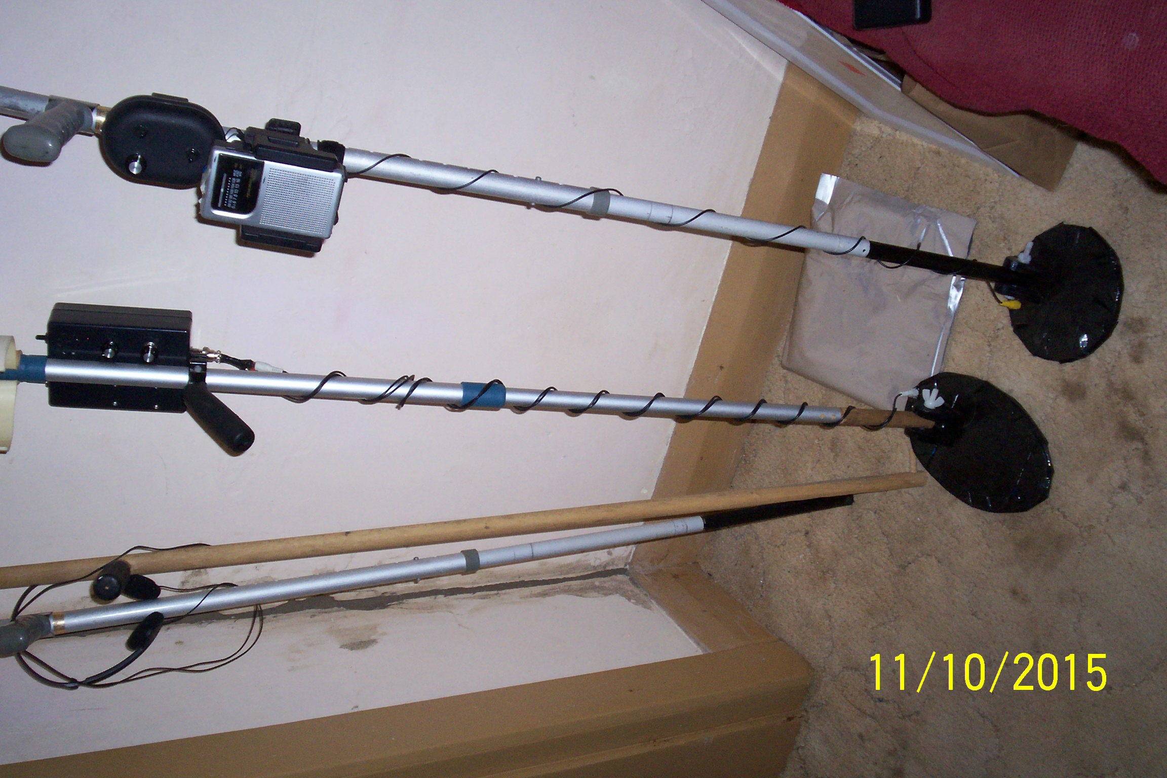

      What you say flies in the face of my experience. Both this BFO and this IB DO NOT DRIFT. And both of these machines will see a copper Aussie 1c piece through a pair of fencing pliers. The "rudimentary discrimination" you bag BFOs for, is the same or worse with PI and VLFs

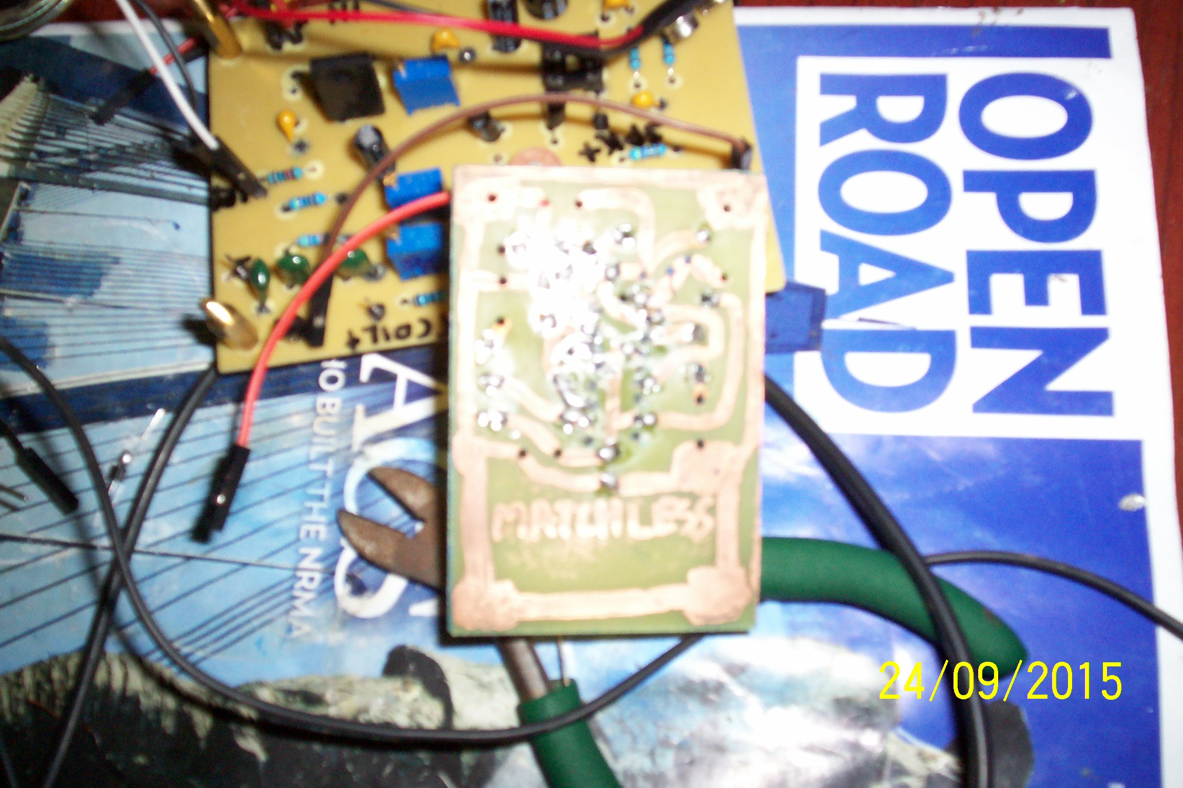

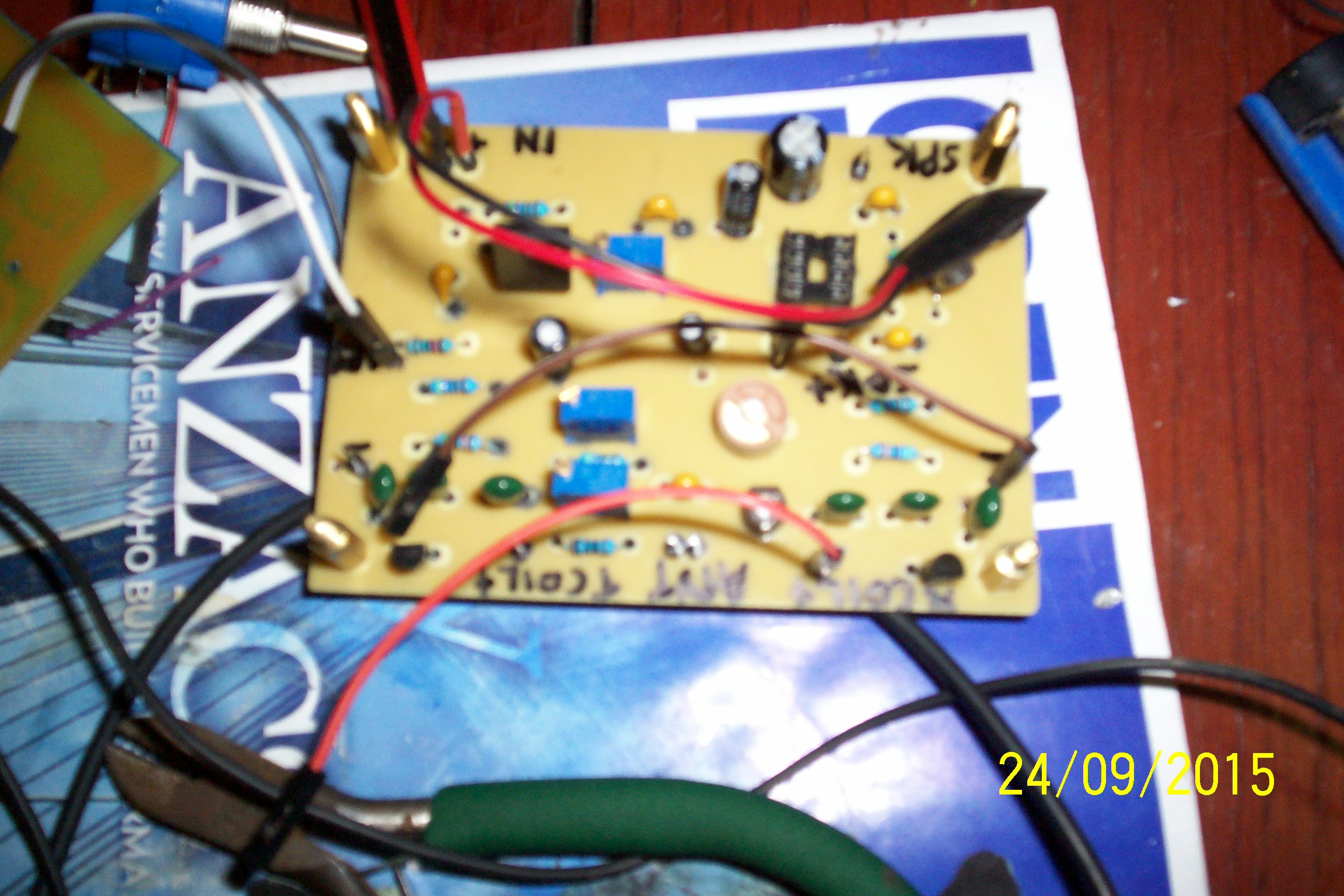

      These are just to prove it is not me who is full of procrastination.

            Oh dear oh dear Q. Hot heads don't read real well, do they. Yes the IB receives via an AM reciever.(not the detector with the radio) Whether one of the Matchless coils is driven by a 555 or whatever means it is still an IB. 2 same or matching frequencies. The IB I made has 2 identical oscillators, but they both require a double d coil.
            The radio detector(pictured alongside IB) was the original and excellent BFO circuit, I doubled up for an IB. Beat-balance if you insist on splitting hairs.
            One pictured is the BFO the other is NOT the matchless, it is the IB circuit with AM receiver inbuilt I made. The other board.Dumb old me. That's the one that comes close to my GMT. It's not a Minelab. It's not complicated. It's not expensive, and it is not a BFO.
