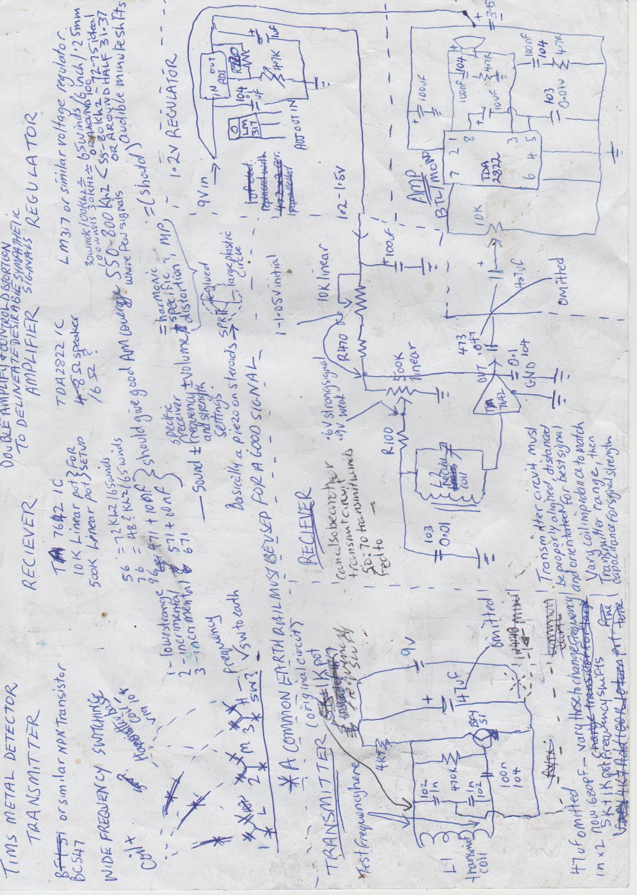

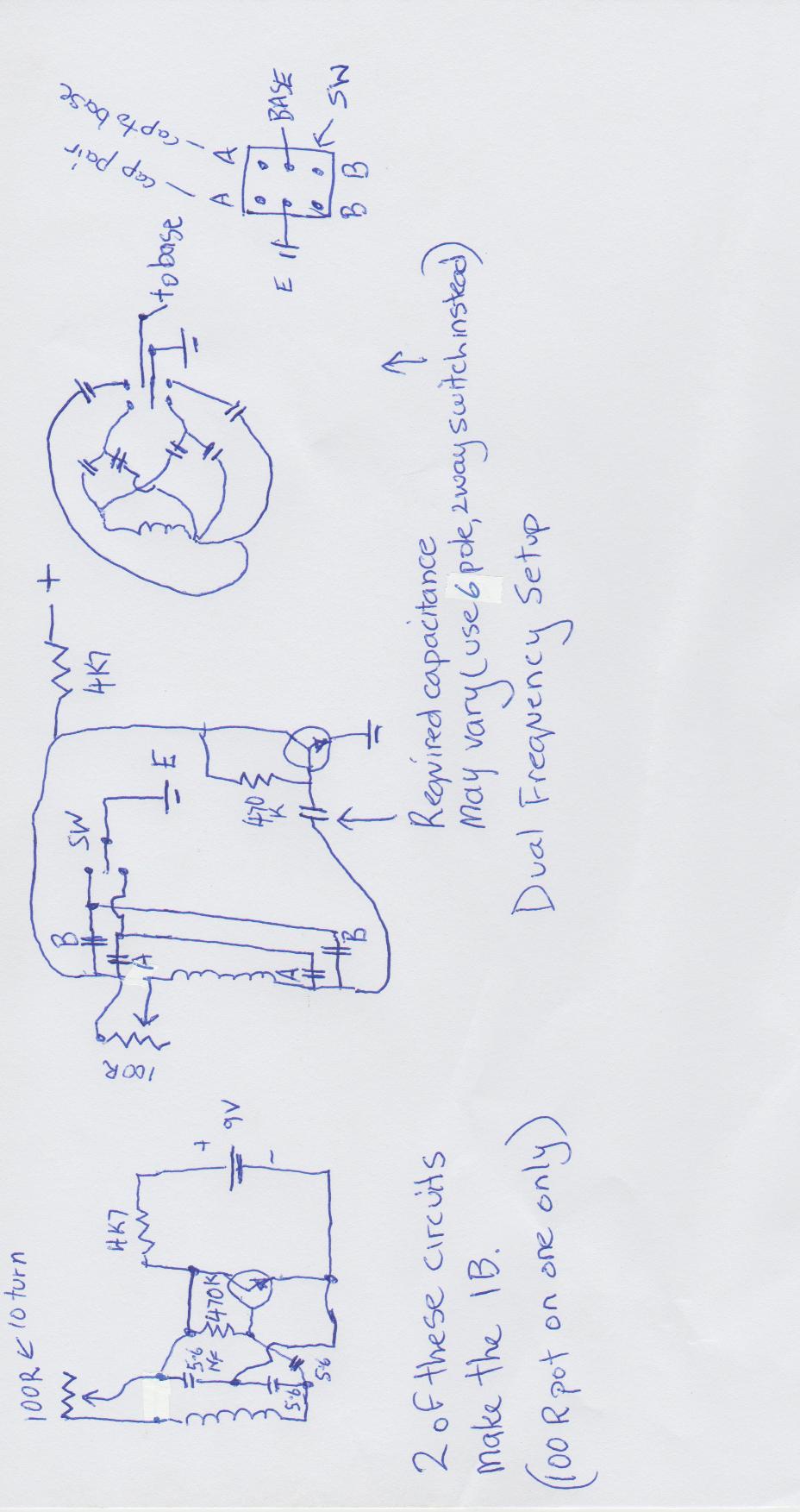

      I cannot believe the corporate BS, so here are the originals. MY originals, in my handwriting. Circuit courtesy of Colin Mitchell. Instead of bagging and procrastination, make it for yourself.Your desktop simulations WILL NOT help.Covering my arse here. Gobble,gobble,gobble-turkey.
      I have had it up to the back teeth with procrastinating WANKERS. Here and elsewhere.
      Don't say-"Oh, I ran a simulation, and it didn't work".Just build the bloody thing!Click image for larger version

      The information purposefully omitted is so the brain-dead can't plagiarise.
      Q, Eric and the other "gurus". Bow your heads in shame for your elitist and persecutory ignorance.

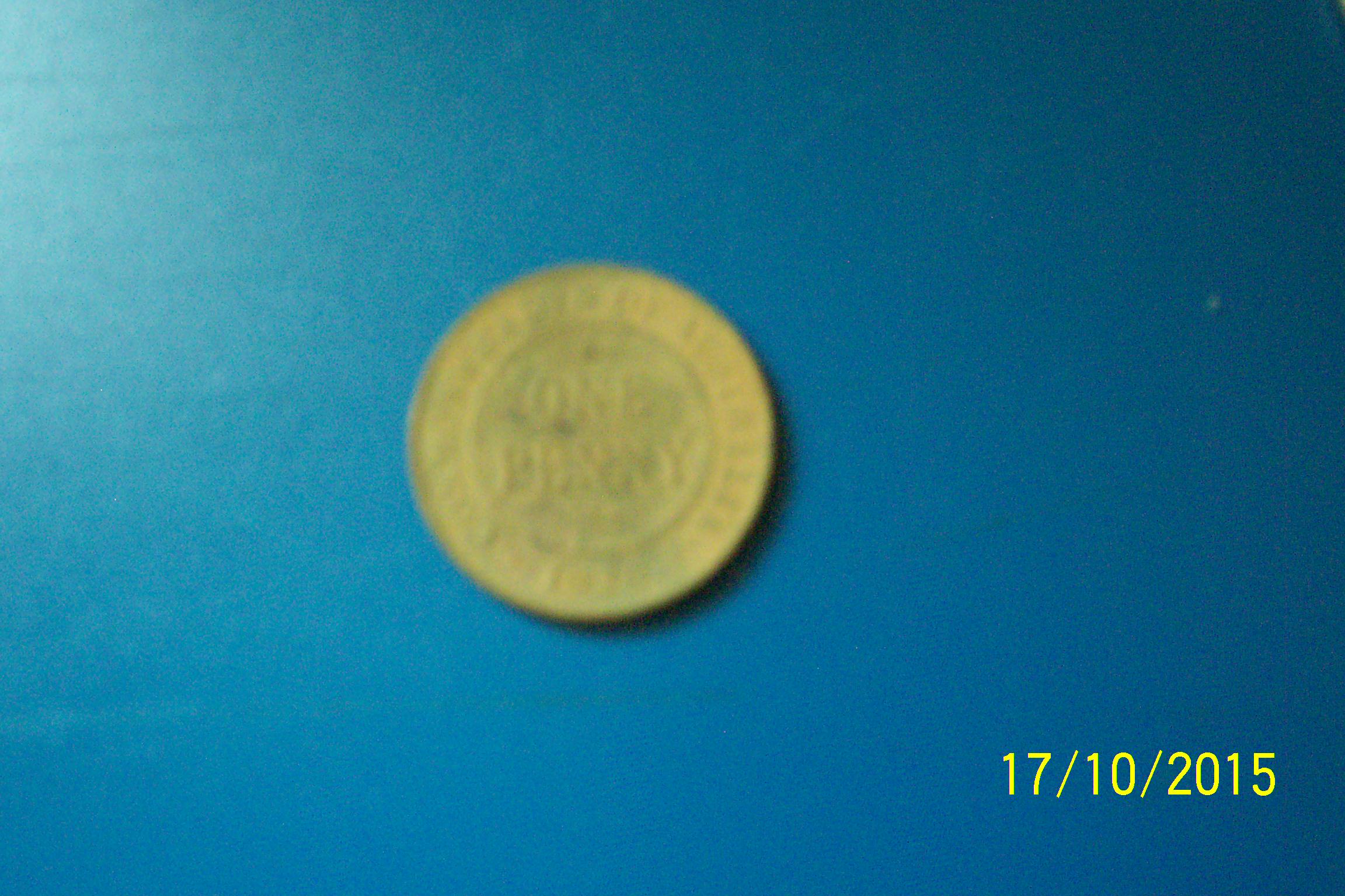

ID:	343847This is the 1920 Australian penny I pulled out of my driveway today, amongst the post WW1 settlers burnt rubbish and steel scrap, with the original BFO/radio detector, where the GMT, and even the GC1006 could not see it. Your old wives tales mean jack schizen to me fellas. Time for a reality check, and a kick in the arse.

            I can understand that the GMT, and even the GC1006 could not see it.The 1920 Australian penny is totally blurred.
