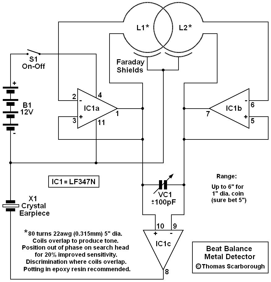

          • #95
            hi tim, if this simpler bfo technology is what interests you, in terms of developing it to something better, take a look at T SCARBOROUGH'S beat balance design.
            it performs better than bfo designs and its coil coupling is non critical, so building and tuning its coils is easier than IB
            http://www.zen22142.zen.co.uk/Circui...tgear/bbmd.htm , Click image for larger version
            it as far as i know never been developed beyond scarborough's basic concept, allways fancied building a better more complex version of this but never found the time.
            • #96
              Yeah I have tried this one with LM348 as per Colin Mitchells site. I did not however try the LF347. I just took Colins' word that it did not work. From memory I couldn't get the LM348 to work. Another Scarborough circuit uses TL074, which I'm currently awaiting in the mail. I have also tried most of the designs using CD4001, CD4011, CD4013, CD4093, and CD40106.
              So far those that have worked have not come within cooee of the Circuit8 IB/Beat Balance I made. That is not to say that they couldn't with coil experimentation.
              As my DD coil was set and made on the Matchless that is my current reference point. The ground interference Scarborough overcame with an earthed faraday shield, I overcame (i think better) with shiny powdered milk packet, not earthed.
              I have all my electronics packed up at the moment, as I need to get back to my Horticultural studies. Once I get this block out the way I will attack the detectors with renewed vigor. I have the tacoma56 squareboard SurfDD to box up with a ML 10x5 DD Commander, this has 4 external pots, and the Sniffer XR71 should arrive any day. 7 external pots on that one, and my secohmeter yet to assemble.
              Thanks for that heads up, I will revisit this circuit, as I have both the 347 and 348 here.
              TL074CN-
