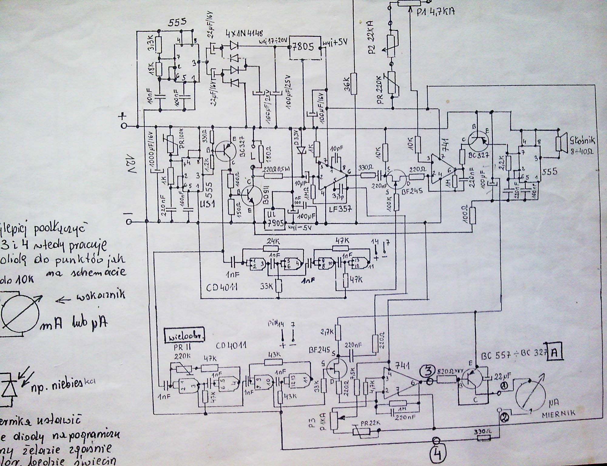

    i appreciate your help teleno but a lot of things are vague to me concerning metal detector technology...on this site people will advise but not always show how to implement what they are saying...maybe people could be more open and sometimes show diagrams to show how to implement...im a beach detectorist and one of my biggest problems is iron on my local beach which is very frustrating !!! and i just want to add to my surf pi something that can help me to reject iron a bit better.

          how does eric fosters goldscan 4 reject iron ??? i know it uses more samples but whats the theory behind this type of ferrous discrimination ???
            you connect it to opamp output and... vu a lia! - you are in the game O_o
            simple way, no something programming, only connect-and-go. look on pulse decay and disc where the gold )))

              Pseudo-discrimination by looking at the decay time constant. Good luck with that!

                would this really show the difference between ferrous and coins/rings ??? also can anyone please give me an answer to the eric foster goldscan 4 discrimination ???

                        discrim diagram COBRA for ProScan_Impulsowy Wykrywacz Metali. simple and effective way - ?
                            [ATTACH]34106[/ATTACH]

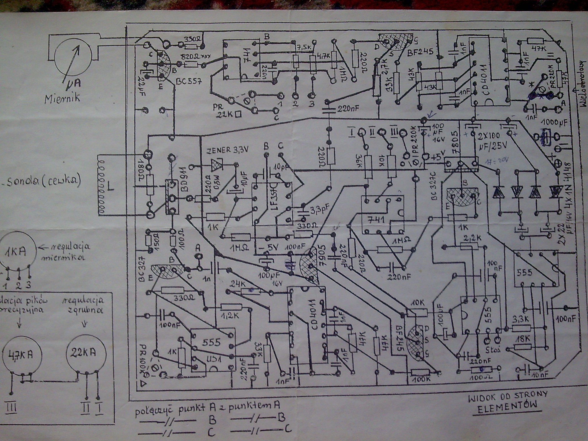

                            Hi Kt315 would it be possible to see the complete full circuit thanks
ID:	343919Click image for larger version

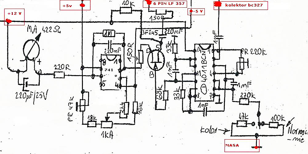

Name:	Kobra disc_sch.jpg
ID:	343920pi disc_sch.pdf
                                [ATTACH]34107[/ATTACH][ATTACH]34108[/ATTACH][ATTACH]34109[/ATTACH]
