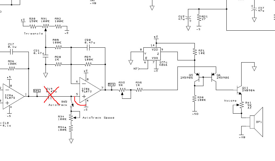

          i have now got the coil drive working but yet another problem with the hammer head with high frequency tone on the audio and no threshold working...this has been a head ache for me since building it over a year ago...just too complicated...never had these problems with surf pi.
            what you have on IC8b input pin 5? did you set the switch AUTOTRACK or not? do you set the switch in open state or not?

              pin 5 of IC8 has 0v when no coil connected....the threshold control has no control over this constant tone coming from the audio...im not sure if this tone is the threshold or some internal problem that is over riding the threshold tone ...i have tried both the auto tune on and off......this hammer head has been much frustration for me to get working.
                do you make VCO rev or without VCO? did you set IC9 or not?
                  i tried the non vco option.
                    try this. a pitch is/no? Click image for larger version
Name:	Без имени-1.jpg

                      you want me to connect pins 4 & 5...and link out cap ???
                        DESOLDER THE CAP & CONNECT THE LINK. what is NOT CLEAR SO I DRAW????
                          yup
                            ive got the hammer head working but with only the vco audio...the non vco does not seem to work for some reason...also i loose depth if i disconnect the auto tune function...ive got the vco running at around 300 hz as i do not like the click click audio...its a shame that the hammerhead was designed for only 12v supply...not sure if could be modified for 16v supply ???
