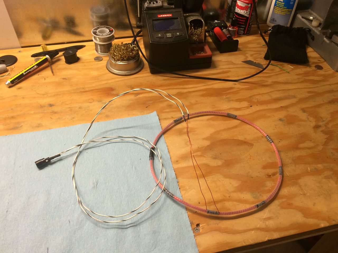

        23 turn 22 awg enamel wire 228mm diam, measured L is 310uH

                  can you show pics of your coil? what type of cable you used? how its shielded?
                    It is 23 turns of 22 AWG enamel magnet wire, 9 inch diameter. 310 uH, .8 ohm. I have not shielded it yet. Thank you
                      ok. no cable. your o-scope pic done in a room.
