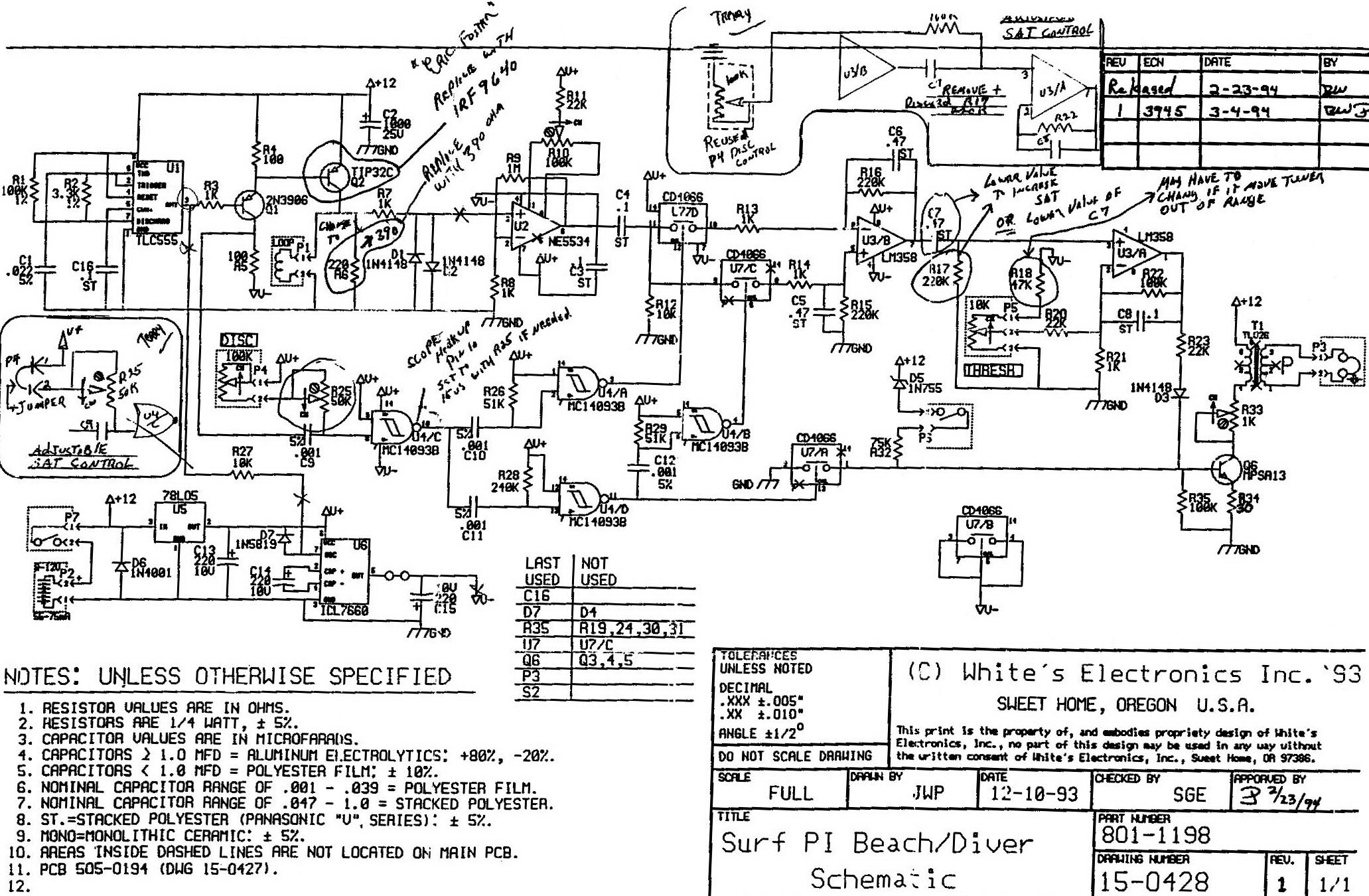

                        • #57
                          boom... unusual way to fix off the problem... i can give right schematic, with all mods... if you want....

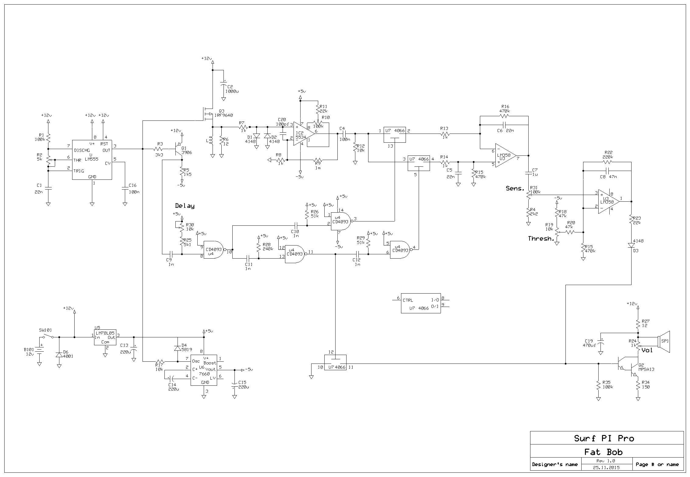

                              Hey I am building that same board. You should have waited a few days and we could have worked together..
                              I drew this schematic it looks similar to other Surf schematics. I haven't verified all parts yet...

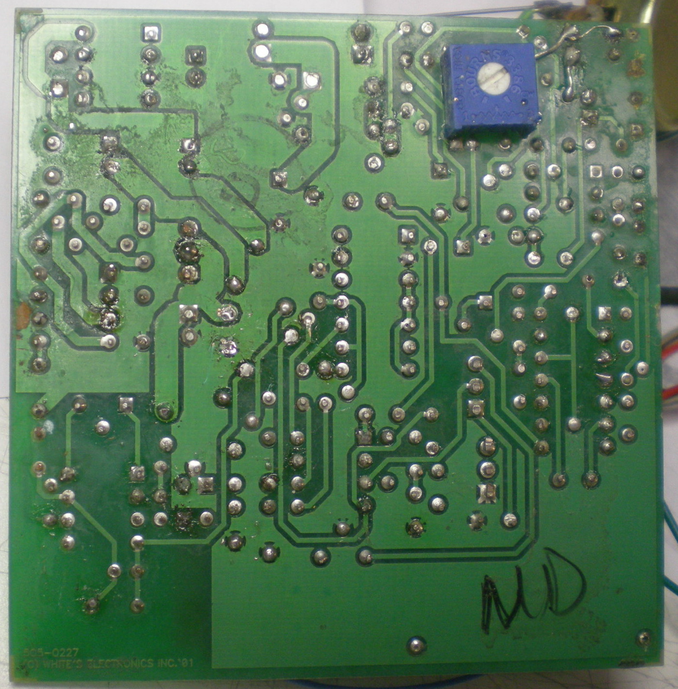

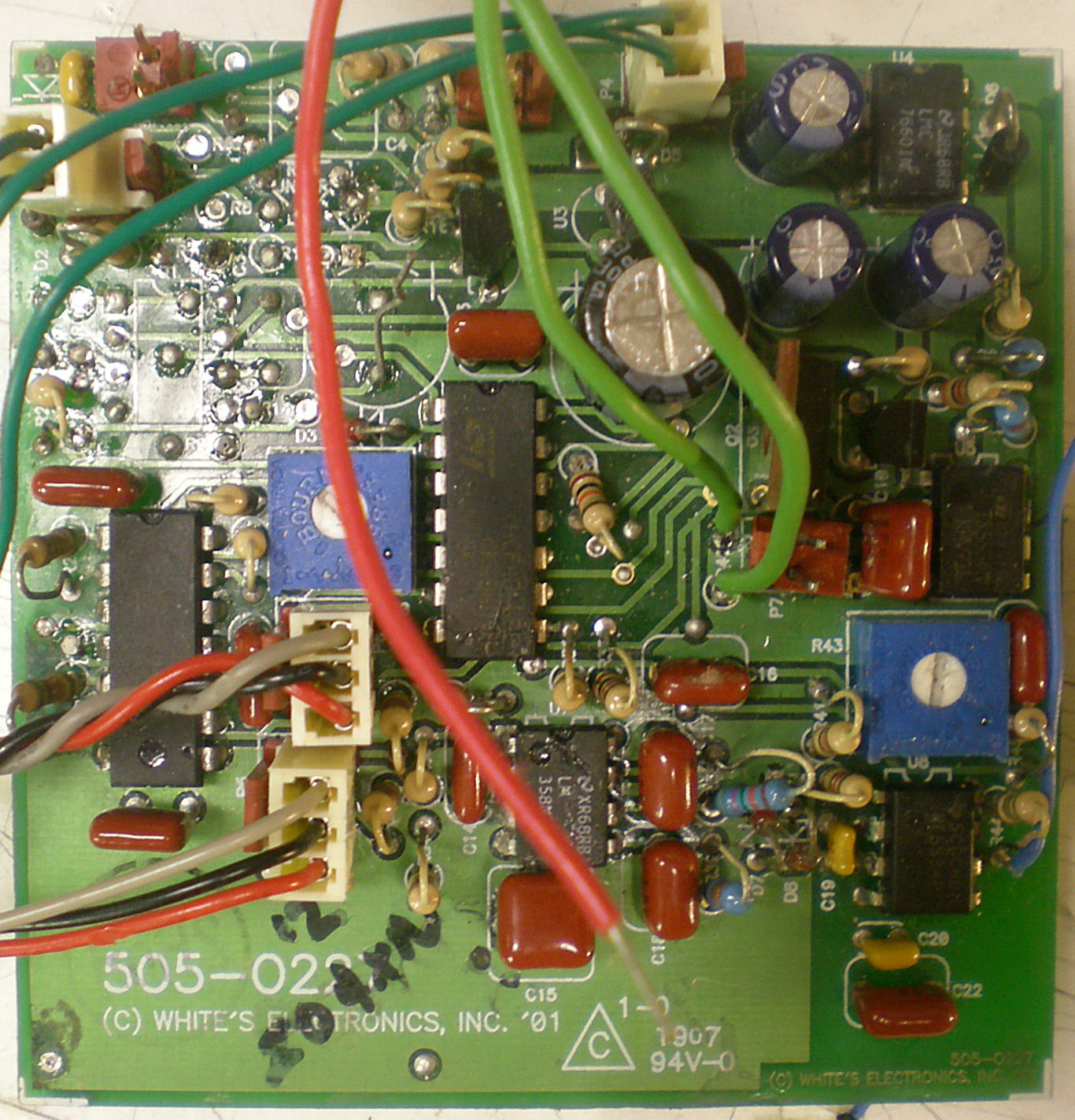

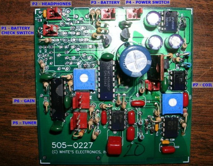

                              • #60
