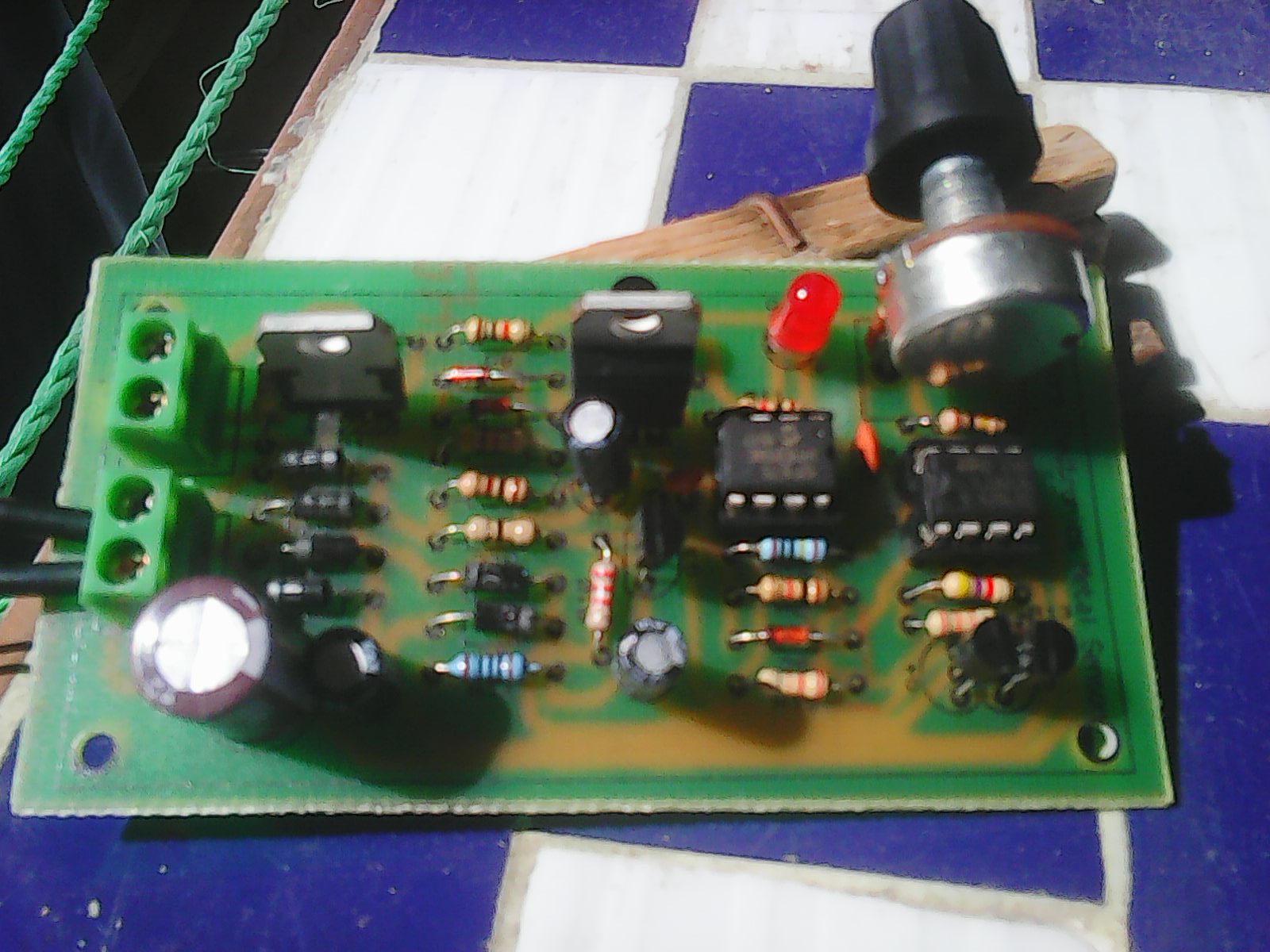

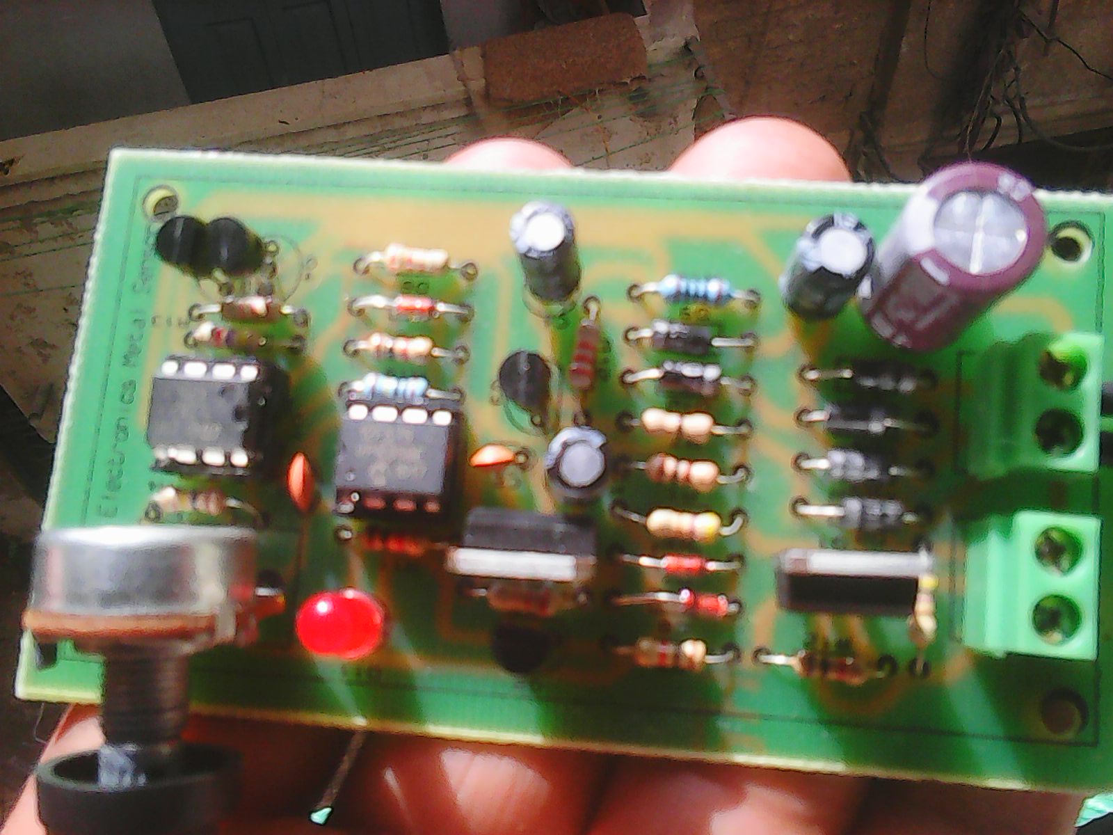

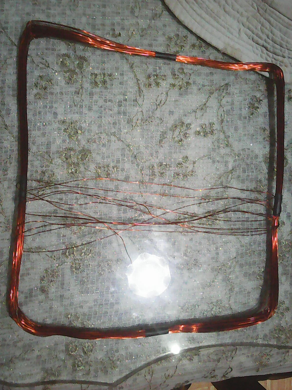

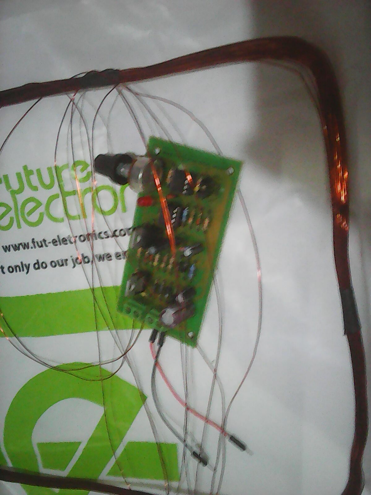

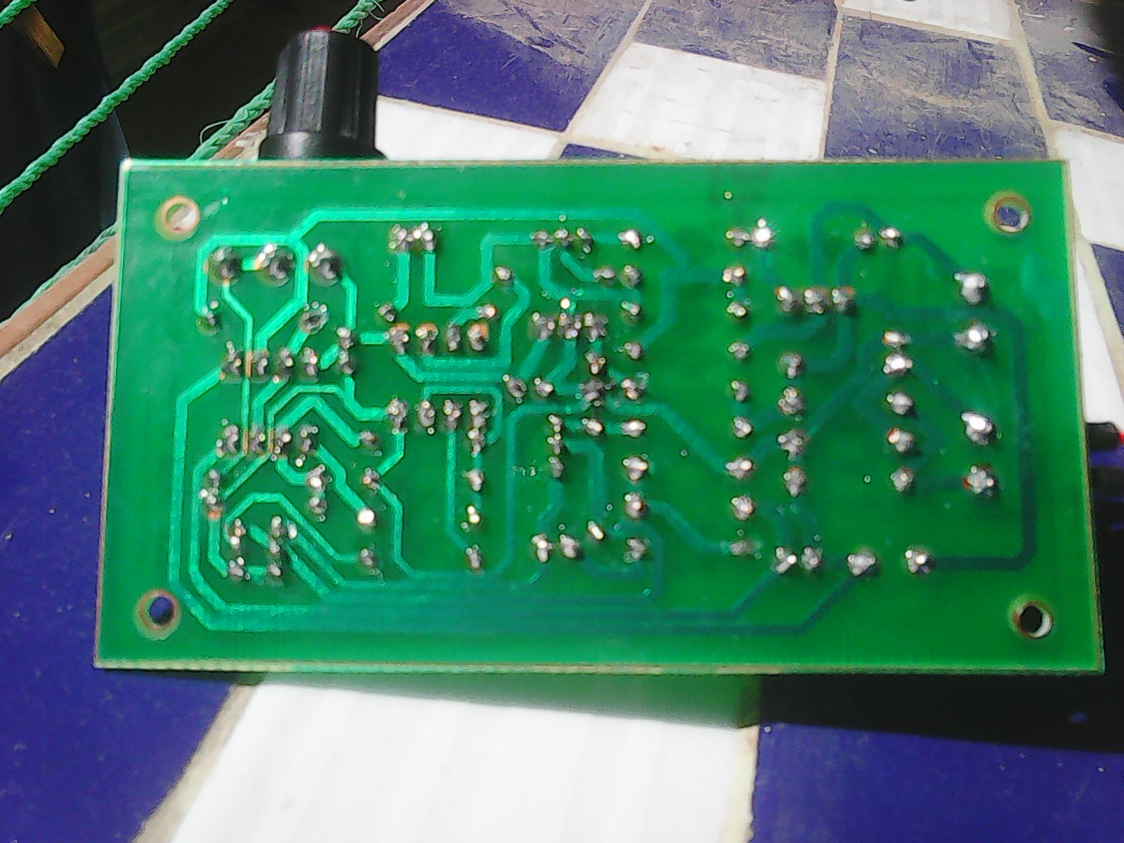

            Hello my friend Azizana Sorry it took a long time to reply you the reason electronics store I bought them Detector but does not function go by to the shop gives me detector last time Beyond time three days and the seller wily this Detector my friend unstuck not discover gold and must be be the size of the detected 10 cm specifications in pictures Click image for larger version

            • Coil32cm size of the number of turns 48 wire size 5

                • Originally posted by Hammerhead View Post
                  48 turns seems a lot. Your coil must have an inductance of over 2mH!
                      Hello Sidi Do you suggest that I edit coil What are occasion number of turns please

                        • Hello Hammerhead,
                          you have 2 options:
                          1. future electronics should help you with the coil
                          2. ask if they can find for you another metal-detector
                          Thank you for the pictures - well, your coil looks pretty large.
                          I don't know how much power and sensitivity the arduino detector has
                          but perhaps it is better for you, if you start first with some smaller coil.
                          A law of thumb for coils is: Use the same amount or length of wire.
                          That's why some 1 meter pulse induction loops only contain just 10 windings.
                          It doesn't work for all detectors this way but pulse induction coils are not that
                          complicated to built. Just make sure that the windings are fixed tight together.
                          If the PI-detector is too weak, a too large coil will lose the most of its energy.
                          Perhaps the coil diameter limit for the arduino is ca. 30cm. Make some tests.
                          Anyways, I hope that you have now the direct support from the guys of
                          future electronics! And, they have shown already that the arduino works.
                          So the problems should be solved very soon and perhaps they even can
                          find for you some better metal detector! If they have good connections.
                            Try 25 turns on a 25cm diameter circular coil.
                            Did you remember to fit a damping resistor?
