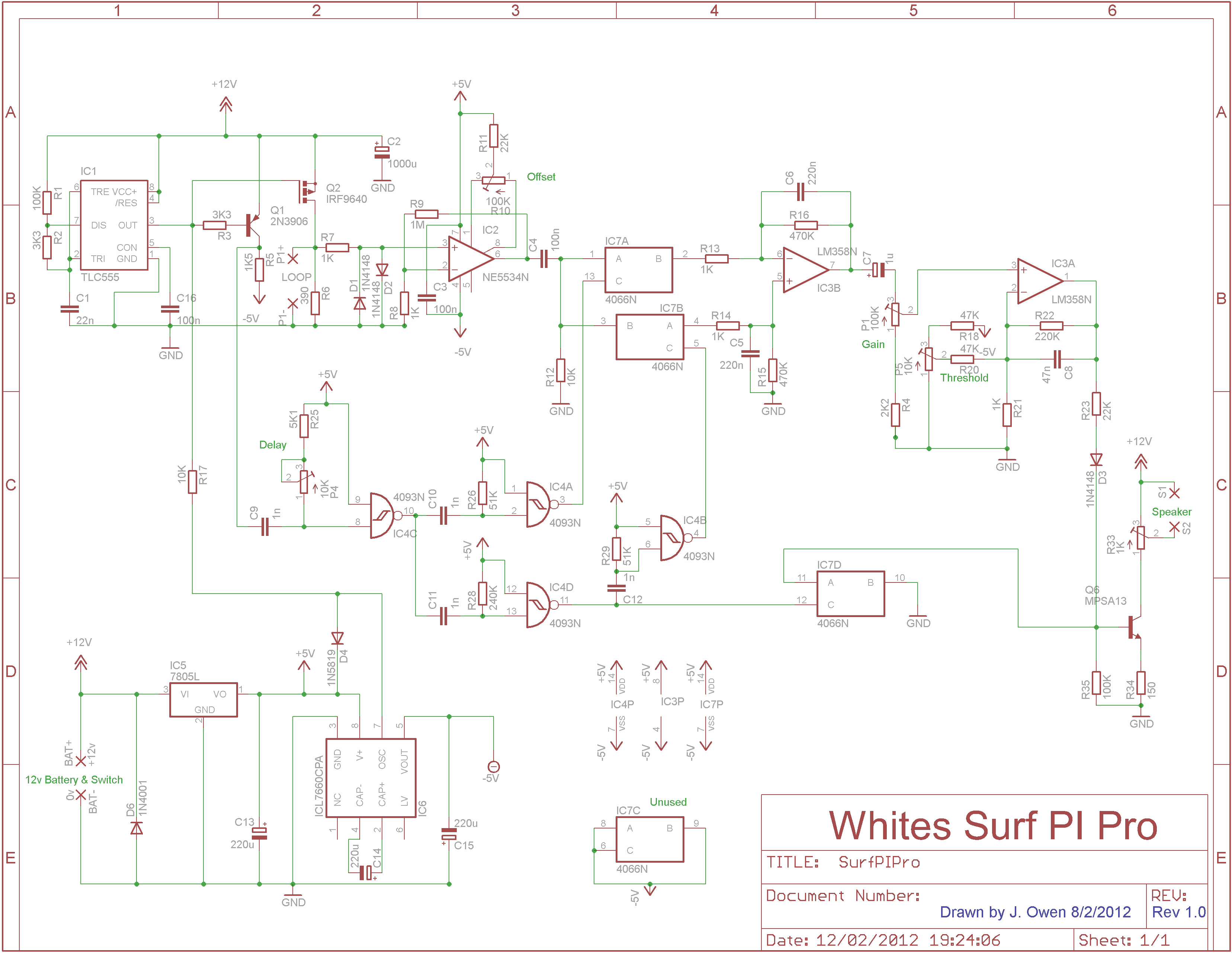

              I think this is the schematic that goes with the PCB layout.
                Thanks Q, I should have been a little clearer, I am guessing that the pcb was done in sprint layout, if so would you have the .lay file for it thanks.

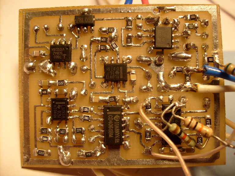

                          Someone should make some Surf Pi's in surface mount for this guy;
