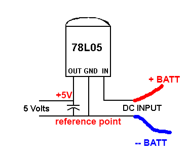

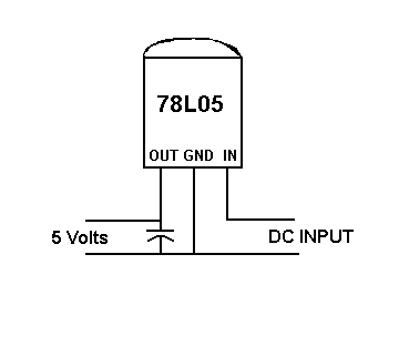

    check those 'checked' 78l05's BEFORE soldering AGAIN. do NOT connect RED positive wire from the batts to GND pins of the stabs
      Hi kt315
      I have checked as you suggest, two give a reading of < 1v all the others read 0v. Will pick up a new one tomorrow and try not to fry it.
        Make Sure you Connect it Correctly.

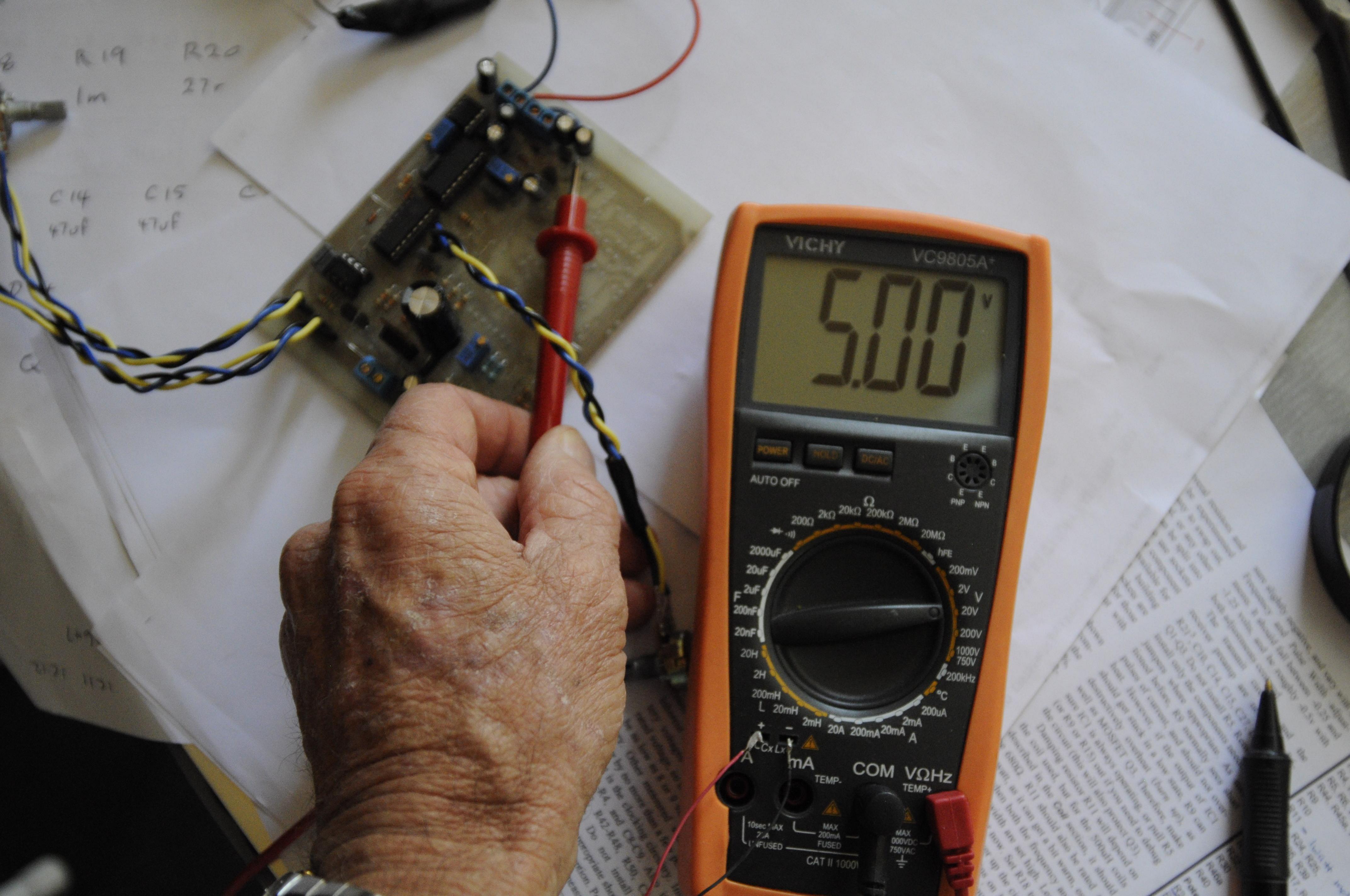

            Will do
            Thanks guys
              Success
