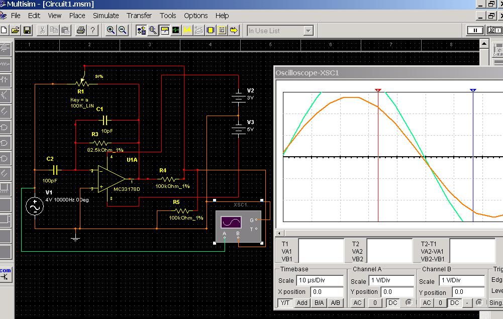

Using MultiSim I just can't seem to get a simulation of the disc circuit to work. The output is shifted the wrong way. It oscillates when the pot is 100%. Must be voodoo electronics.
