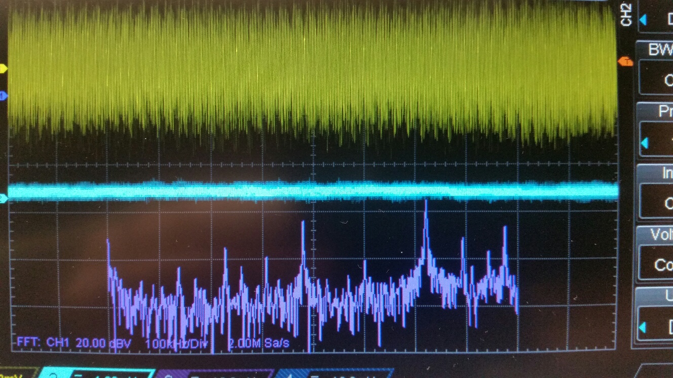

                            Not sure what the debate here is ... Coil noise is way bigger than resistor noise in all cases except bad design :-).
                            EMI is everywhere so the no-EMI measurement is not relevant.
                            PIX shows the comparison of shielded coil ( yellow ) vs 1K resistor ( blue ).
Name:	coil noise.jpg

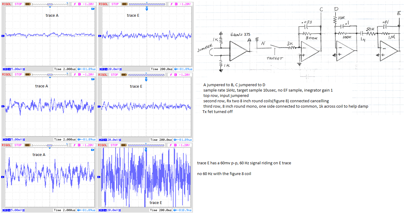

                              Thanks for the replies.
                              I have tested the detector in the yard. The ground signal is a lot higher than amplifier noise. The detector isn't usable without GEB. Noise goes up when I add GEB so I'm trying to minimize the noise.
                              I wonder why some detectors add switches to eliminate the 1k input resistor if coil noise is always higher than 1k resistor noise.
                              I'm learning so what I'm thinking might not be correct. Target signal is less than 10Hz, ground and EF maybe closer to 1Hz so maybe other than line frequency(50 or 60Hz)most other frequencies are above the sampling rate, if not they would be filtered anyway. The maximum frequency after sampling is 1/2 the sampling frequency. If we filtered all frequencies above 10Hz the only higher frequencies that would matter are 10Hz and below and within 10Hz of multiples of the sampling frequency. Sample rate 1kHz(1010,2010,3010,3990 etc.) 5kHz(4990,10010,19990,30010 etc.) maybe one of the reasons higher sampling frequency might have less noise, fewer frequencies to alias on.

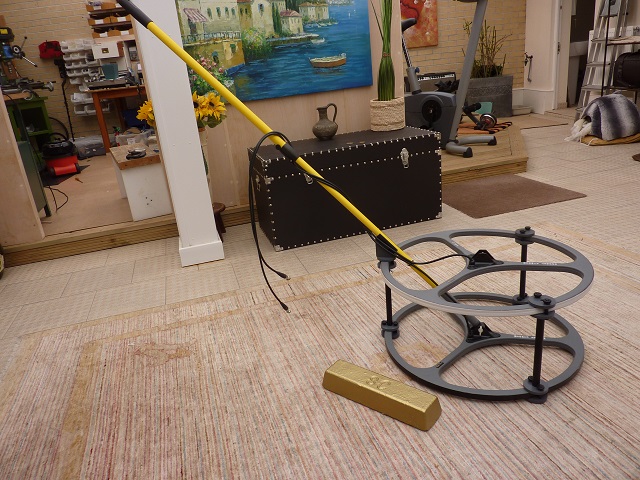

                                Eeek! Maybe I was too economical with words again. Coil noise is EMI. EMI includes power line noise, radio stations, mobile phones, lightning, static generated by hot windblown sand, waves crashing on a seashore, micropulsations in the earth's field; in fact any signal that blows into the detector via the coil when the sampling gates are open. Except of course, the coherent, response from a metal target. You might question the waves thing, but, you have rotating conductive water in the earth's magnetic field. Yes, EMI is generated. A coil of even a few ohms resistance generates little noise of itself compared to the preamp input resistor.
                                A mono coil picks up a large amount of emi even if well shielded. I use one of my 11in shielded mono coils as an antenna on my workshop radio. Noticeable attenuation only comes in at upward of 7MHz. A figure 8 coil is good for workshop testing but even that becomes unbalanced upwards of 50kHz unless you are very careful about each half being an exact mirror image of the other. This can be overcome with printed circuit coils as I did for an industrial application a while back. This was a four layer board with electrostatic comb shielding as top and bottom layers. Not something for hobby experimentation though.
                                Another technique is to use a mono coil as TX/RX1 and an identical mono coil mounted rigidly above it as an RX2. TX/RX1 is fed to one preamp input, say the non-inverting, and RX2 fed to the inverting. EMI cancels nicely right at the front end. You have to have sufficient spacing between coil so as not to cancel the target signal and the coil array is a bit unwieldy. The front end can be tweeked to give best common mode noise rejection but to every benefit there is a trade-off. Here, it is two coils and two man operation.
                                Try it with a couple of small coils, say 8in.
                                I would say that here in the UK we suffer more from man made EMI than you would in Australia. Out in the bush in Victoria I could dispense with the dual coil in the picture, as a single mono was just as quiet and much easier on the arms.
                                Eric.
