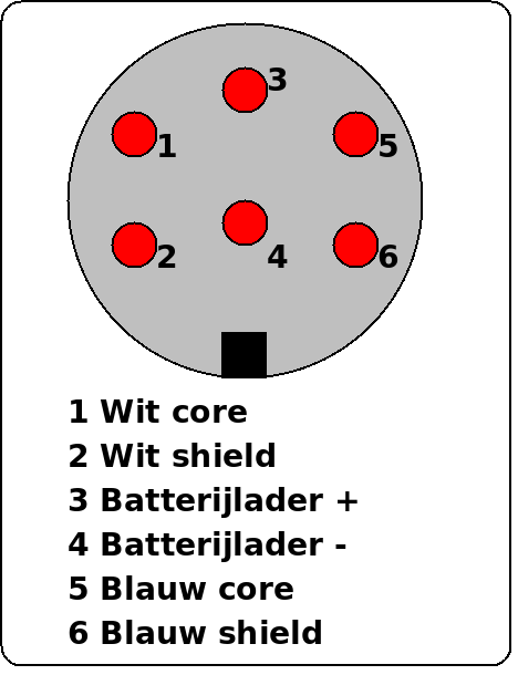

    someone on another forum has asked for the coil connector for the GMP. Hopefully someone on here has changed one.
    If you need the pinout of the connector:
    wit = white cable to coil
    batterijlader = battery charger
    blauw = blue cable to coil
    I search with the GMP for years now and the connector is a weak point in the design.
    I have shortened the coil cable and soldered it directly to the PCB.
    Added an extra cinch connector for the battery charger.
      anybody know where to source these connectors ?
      I have a few to repair.

        Replace that XP crap connector with common 4 or 5 pins one.
        You only need to connect 1,2 and 5,6.
        So any 4 pin connector will do. You'll need male and female.

        Any other Lipo 3.7V battery will do, any other double coaxial cable will do, any other 4 or 5 pin connector will do.

            hi k, what you could do is replace the sockets and connectors with radio mic 4 or 5 pin types like ivconic suggested(more than adequate) on the detector and his coil/s, then salvage the socket(original xp) from the detector and make him a fly lead about 4 inches long with a replacement plug one end the xp socket the other, the if he buys another coil or borrows one he can still connect it to the modified detector.
            i did that with mine.
