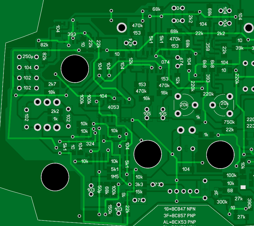

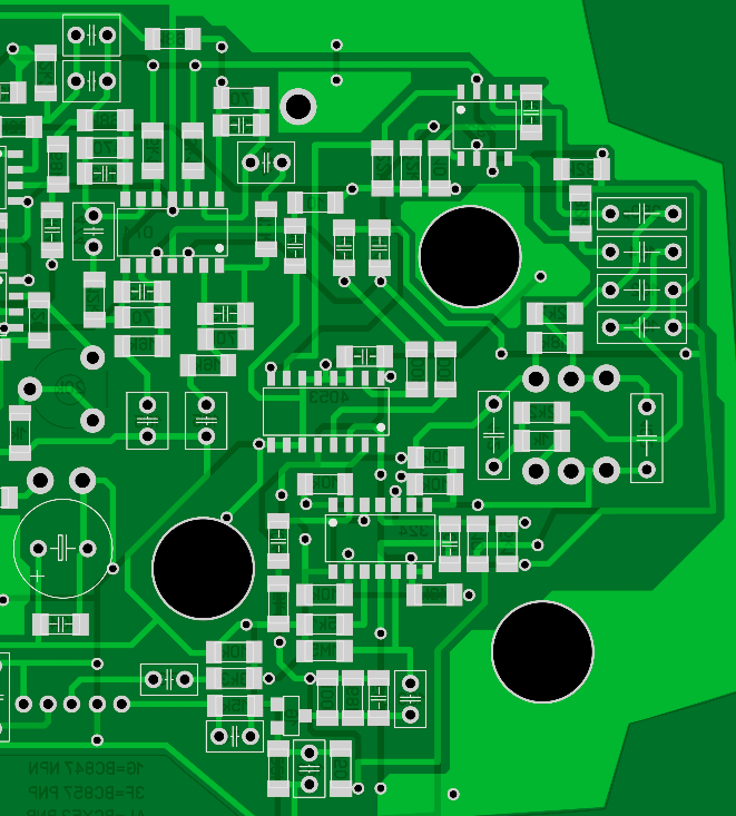

                • Originally posted by SVEN1 View Post
                  PCB's have arrived, now to hunt down some parts
                  These boards I think are wrong
                  • Why?
                    Ivonic had choice of 3 boards you can use.
                    I made "mag_redu_pcb" version, which is SMT (Surface Mounting Technology) or SMD (Surface Mounting Device) version.
                    But unlike the "mag_compl_pcb" version; here at "mag_redu_pcb" version: i used 1206 sized SMD components.
                    I did that for one simple reason; to be able to solder them manually.
                    1206 sized SMD components are just about "human" enough to be manipulated and soldered by a common hobbyists.
                    For those with much better sight and more calmer nerves: the fist one; the "mag_compl_pcb" version will be also alright.

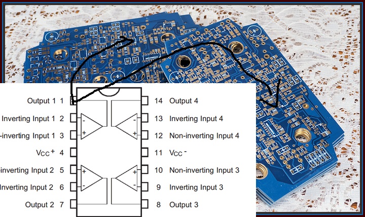

                    • Originally posted by bandito View Post
                      Look integrated circuits are mirror,and can not be soldered,see first pin where ,,,,the layers are wrong
                      • I don't understand what you are saying
                        • Maybe the photos are mirror-reversed!
                            Sven,
                            Look at the pictures. Each integrated circuit has marked the first leg - white point sufficiently noticeable. The photos can be seen that the point is placed on the left of the integrated circuit. But first pin is right. This means that if the photos are 1: 1 with your boards then you will have to solder chips lying on it's back and bend their legs to touch to the board.
                            Do you understand now?
                              How will soldered,see the layout of the integral PCB and datasheet
                              • Guess it depends upon the way you view it.
