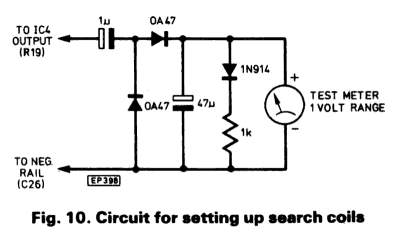

                      For most of the job you don't need oscilloscope at all.
                      For setting up the coil too. Andy Flind suggested circuit from the picture bellow.
                      I made it and used "VU scale" taken from faulty "Seben" metal detector, you may see it on posted video demonstration, laying behind the detector.
                      Although i do have 2-channel digital pc scope up from recently; i founded much easier and straightforward to set up the coil with Andy Flind's circuit.
                      10 times easier and simpler than with scope.
