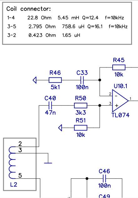

            • My Magnum also works great.
              The THT board is checked and working properly.However, the author of the topic made a mistake with connecting the coil.
              When I started the detector according to recommendations from the forum the detector worked very bad.
              The third coil that is responsible for BG and DISC should be a separate winding not continuing TX!
              Correct coil connections are shown in diagram GM5

              • Originally posted by perkun View Post
                [ATTACH]39849[/ATTACH]
                The picture is not completely visible...
                But what is the number of turns and what is the diameter of the wire?
                  If you use a finished sensor from Golden Mask, then the third winding is used. If you do the sensor yourself, a third winding is not required.
