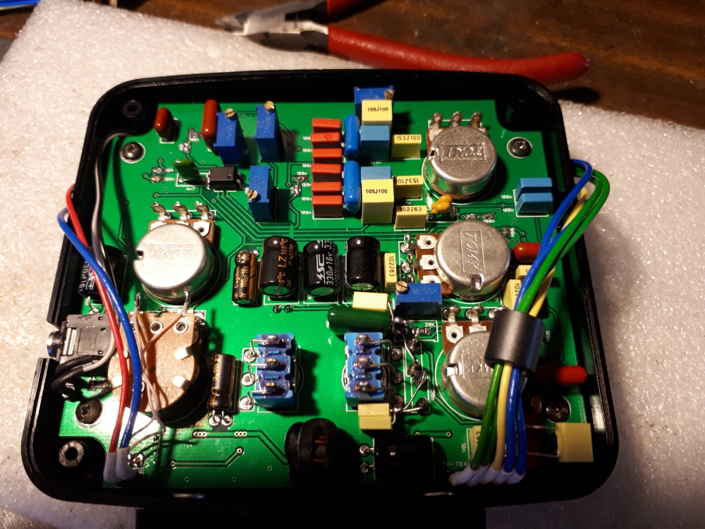

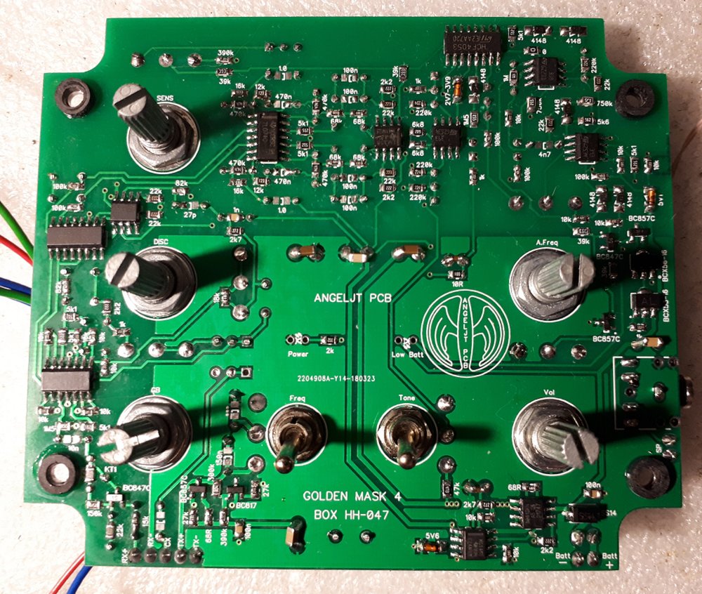

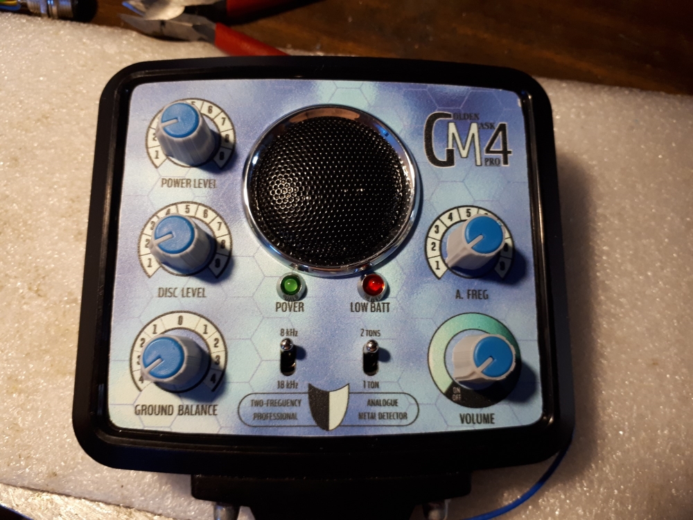

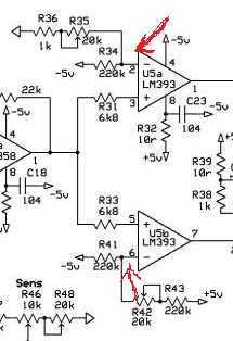

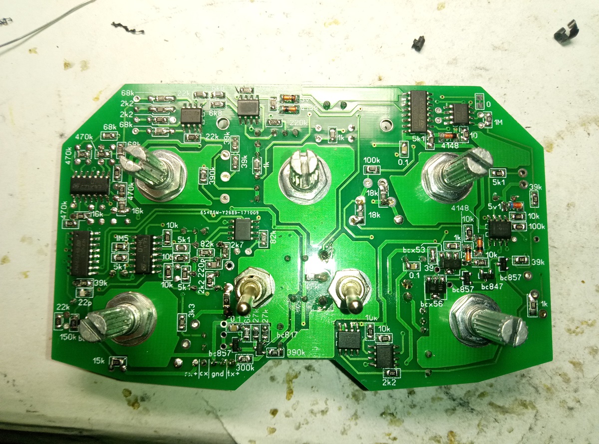

ID:	352049Kind time of the day, friends! Tell me, what kind of tension should be in the points marked with arrows? I want to present my execution of the instrument-

ID:	352058I apologize, I asked, but I did not lay out the scheme-

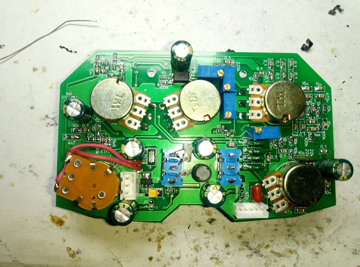

          • My board
            • I agree, too, a beautiful board, one of ... but I'm interested in a specific question, WHAT IS VOLTAGE IN THESE POINTS, which are marked by arrows, when setting up the device. I'm interested, I can put the board file in Dip Trace format

                  Keep your files, share the voltage!

                    The scheme uploaded to the forum and create it in LAY format
                    Voltage-12V

                    • Threshold
                      Found only this information from Ivconic: http://www.geotech1.com/forums/showt...064#post223064
                      R35= Basic treshold
                      R42= additional Treshold for 2-tone option, important at switching/biasing the optocoupler
                      Looks like some feeling-tuning will be necessary...
