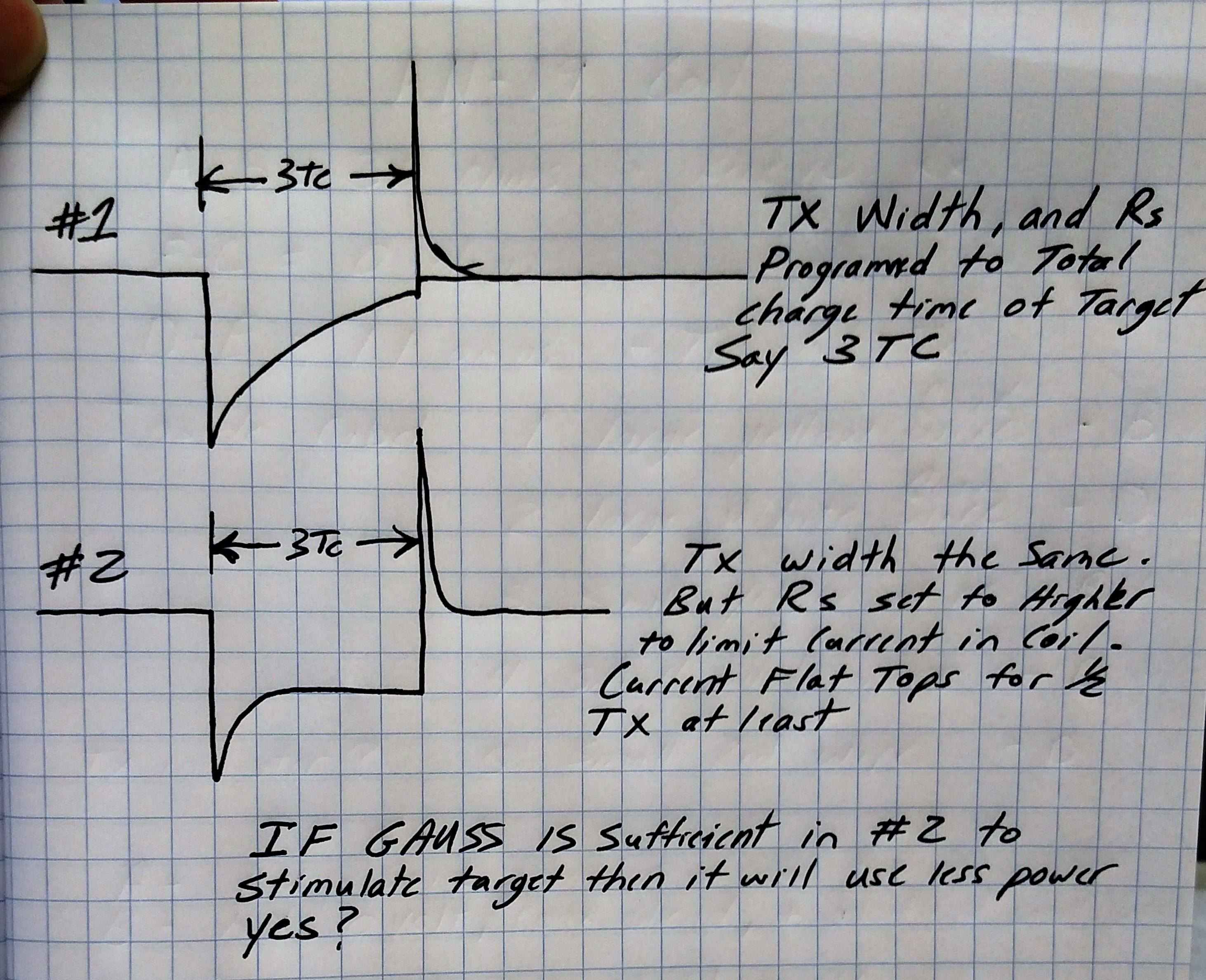

                Good link thank you, another spin on that question is this. Couple ways we can set up our tx current.One way we program the series resistance so that the current in the coil builds exponentially, and we match that with our target's total charge time. 3tc-95% for example.So just as the current in the coil rises close to flat top we end the tx pulse. The other way we use more series resistance, so the current flat tops sooner. Then we maintain the constant flat top current until the 3tc-95% point of our target. Assuming all our components are rated for the currents. Is there appreciable gain from one method to the other,or does it boil down to average current through the coil?

                  If you terminate the TX-on pulse before the coil current has flattened out, eddy currents will still be present in the target. When the MOSFET is turned off, the magnetic field in the coil collapses. The eddy currents generated by this collapse will be in opposition to those flowing as a result of the TX-on pulse. So the idea of allowing the TX-on current to flat-top, is simply to allow the magnetic field collapse to fully stimulate the target. However, in practice, the benefits associated with flat-topping are small.
                  There are also other [arguably more important] reasons for including a resistor in series with the coil. Firstly, it means that you don't need such a tight control on the coil parameters. If the series resistor wasn't there, the maximum coil current would be directly proportional to the coil resistance. Secondly, If you accidentally get a short-circuit across the coil pins, or the TX oscillator gets stuck in the on condition, the MOSFET will not let out the magic smoke.
                    I am not sure my meaning is coming across. I follow everything you are saying,but I'm not sure we are on the same page. let me talk hypothetically for a minute. We know what magnetic field strength we need to stimulate our given target,in our given soil.We know all our coil specs so we can figure the current required to achieve the said field strength.So we set our series resistance to give us this field strength,so I can imagine that will be enough resistance that our flyback decay,and early sample time is a non-issue.
                    So maybe I have it backwards,and that is why I feel we not exactly eye to eye here. Maybe the field strength is harder to achieve than the fast flyback decay. So we have to set our series resistance to program the coil to the charge time of our target 3tc for 95% for example. Or set the resistance to get the most current through the coil that we can and still sample when we want to sample. So we are getting the most field strength that we can get.
                      I've long questioned whether flat-topping the coil current helps beyond a tiny bit. I have a plan to build a test circuit to objectively test this.
                      Most PI circuits that use a low coil resistance end up with roughly a sawtooth coil current (the early part of the exponential), where the sawtooth ramp follows di/dt=VTX/L, where VTX is the transmitter power supply voltage and L is the coil inductance. Ergo, if VTX is 12V and L=300uH then the peak current at 100us is 4A. The series resistance reduces this some, but the peak current is usually dominated by VTX/L. Inductance in coils is usually pretty tight, 2-3% is normal.

                        If you want to guarantee that the target's turn-on eddies have died out, then you need to flat-top the TX current, and keep it flat-topped for 3-5 target-taus afterwards.

                            Coil field ( and its energy ) does depend on coil current , so if we have the same coil current before switch-off - our target response must be the same . But if we have a higher battery voltage with the same coil , then we'll need less time to reach this coil current value , so the TX pulse becomes shorter - and this short pulse won't be enough to "energize" a target with a high TC .... in this case higher battery voltage is worse .
                              As a general observation, I haven't seen flat-topping make a noticeable difference. It would be good to have a definitive answer.
