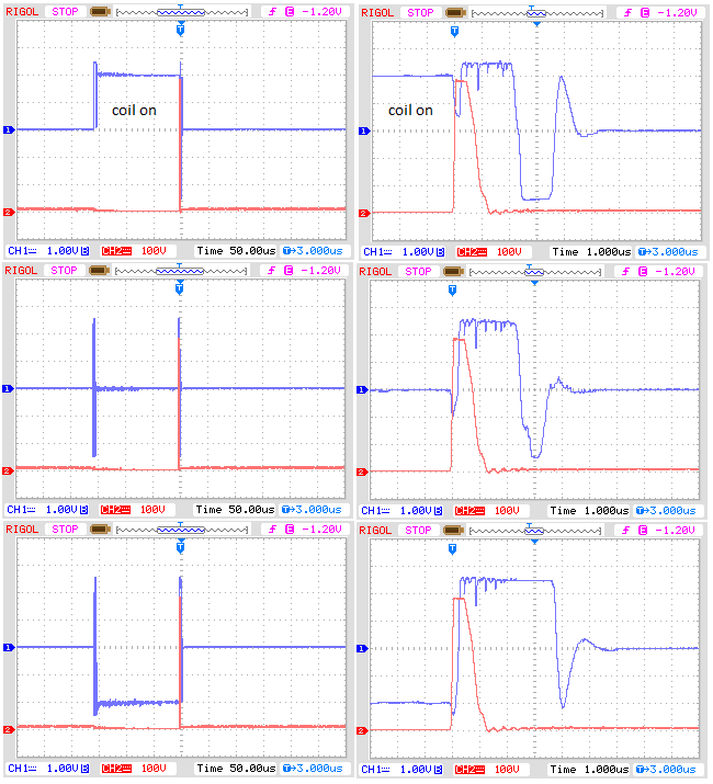

                    Eric stated he has sampled at 1.5usec in another thread. How soon do we need to sample? Some thoughts. What is the lowest target TC we are looking for? The ground signal increases faster than the target signal if you sample sooner than the target TC, decreases S/N. The GEB hole is between the two samples, the sooner the first sample the lower the hole TC making it more likely the hole will eliminate a desired target. If there is no ground signal then the lower the sample delay time the better.

                      It's pretty easy to accomplish first-order coil and ground cancelation with just a judicious coil design. For example, you can eliminate the coil decay by using an induction-balanced coil, and then you can easily sample down to 0us. I've done this. Furthermore, if you make the IB coil in a Bigfoot configuration (figure-8 receive coil) then you will get a first-order cancelation of the ground. In milder ground this might be sufficient, and you can take advantage of extremely short sample delays. Whether it holds for hotter ground, I don't know. The presence of hot/cold rocks tends to screw up all the good ideas that assume a homogeneous ground matrix.
                        Hi Carl

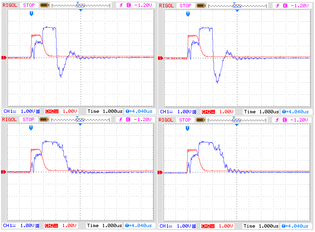

                        I keep reading I should be able to sample down to 0usec. I'm using a Bigfoot style coil, two 8 inch round coils Rx(647uH, 1.05MHz SRF). Oval Tx surrounding Rx(378uH, 895kHz SRF)SRF measured with coil leads connected to coil. Differential input preamp(gain about 375). Tx, 160usec, constant rate, 6250 amps/sec, 1 amp peak. The coil is very close to balance without trimming with a ferrite bead core. Including some scope pictures, coil volts and preamp out volts. Top, ferrite near one end to unbalance coil when charging. Middle, ferrite near center to balance preamp out when coil is on. Bottom, Ferrite opposite end. I can zero preamp out when coil is on and change the waveform when Tx is turned off but I can't get rid of the saturated signal. Any suggestions what or where my problem is? Coil, preamp or something else.
                          Sampling down to 0 requires a very wideband null on the coil. I use lower inductances, I think the last time I did it, TX=100u and RX=250-300uH. Use a bit of ferrite for the X null, a bit of foil for the R null. I also run a low preamp gain, typically 100.

                            Tried another coil I've been working on, similar to the one above. Comes out of saturation a little after 2usec. Some scope traces,(Ch#1 preamp out, Ch#2 probe laying near coil fet to show decay wave form). Top row, no target. Bottom row, target. First column, 99.9% pure 1 troy oz. copper coin about 5 inches above one of the figure 8 Rx coils. Second column, 1 qt. zip lock bag with California clay(6x6x1.5 inches) about 3 inches above the opposite figure 8 Rx coil. Get a large change in amplitude between 2 and 3usec, some to 4usec. Not much after 4usec. I'm thinking the large signal change is due to the Tx coil current decay especially since the copper coin and California ground are on opposite ends of the figure 8 Rx coil to get the same response. Maybe I'm thinking or doing something wrong, appreciate someone correcting me if I am.
                              Thanks for the reply, I was posting another test at the same time. Hadn't tried the foil for a R null. The null on my coils seem narrow to me, how do I know if it's wideband and what is required to make it wideband? Sorry for the questions, I'm still trying to learn.
                                I found that the damping on the TX coil was critical at short delays. Try a fixed resistor in series with a reasonable wattage ceramic trimmer and adjust for the flattest RX response with quickest recovery. It looks in your last .png that there is some undershoot in the amplified RX and when you introduce a target, it is cancelling the undershoot before looking like a sensible signal. Try a damping preset trimmer and see if that gets rid of the undershoot.
