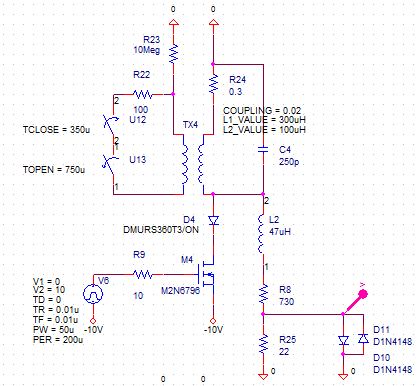

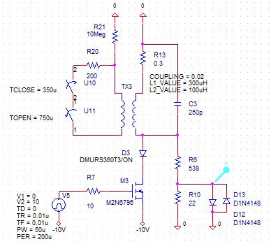

    Now I continue. I have forgotten to give the parameters I have used : L : 300 uH, C : 250 pF and Rs : 0.3. That are the values I have measured on a 11" Minelab coil I have purchased on eBay. The current at Tx off is about 1.5 A.
    Usually, to limit the voltage at the preamp input, it is necessary to add a resistor and diodes like that :
    The same but with the inductance :

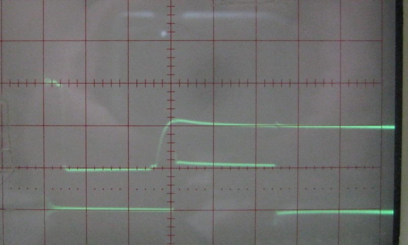

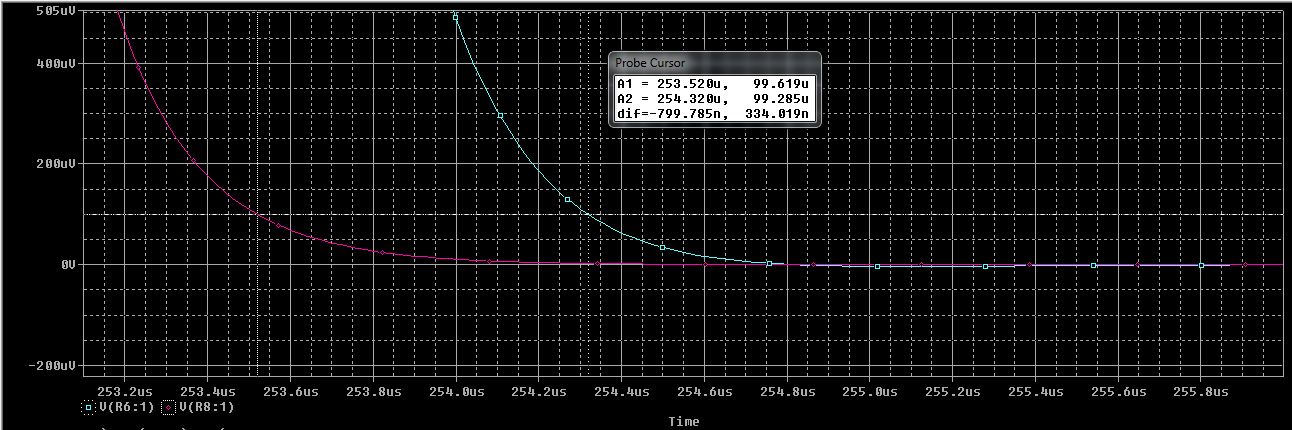

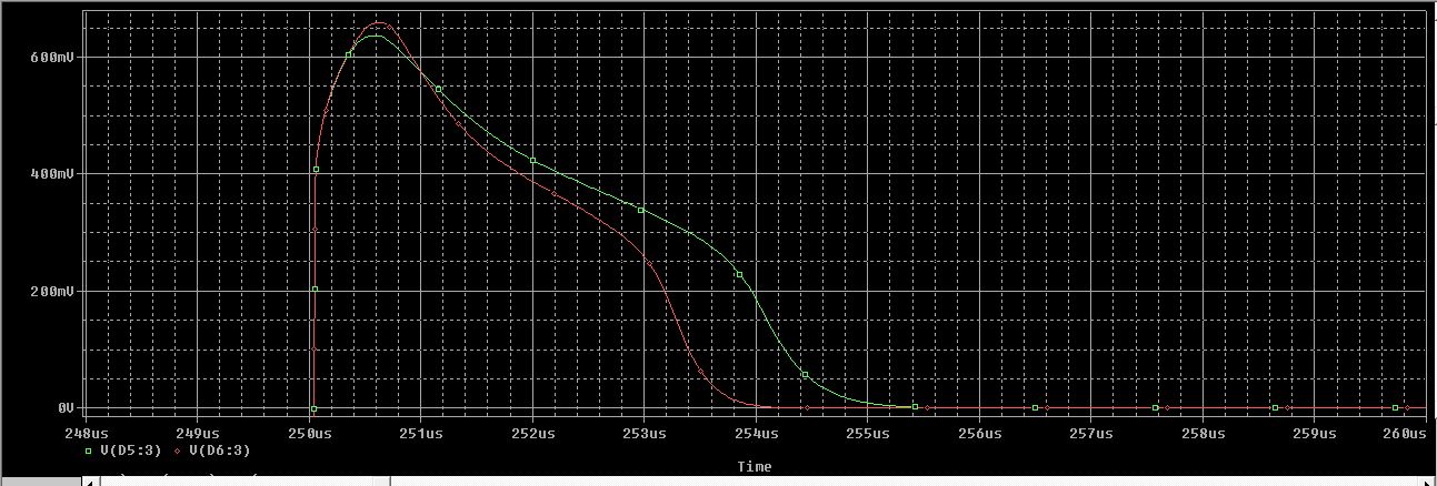

    With these components there is a decay time increase as seen on the following images :
Name:	R+L+R-D Full Wave.JPG
Name:	R+L+R-D Detail @100us.JPG
    Now we have 6.0 us without inductance and 4.4 us with inductance. Once again, the damping resistor is optimized to get the shortest decay time.

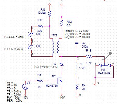

    So I had the idea to add diodes serially with the damping resistor instead to have R + D in parallel with the damping resistor. Here is the result :

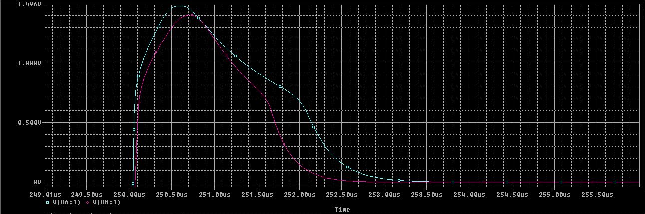

    There is a 22 ohms resistor in parallel with the diodes to prevent oscillations. The related waveforms are the following :
Name:	R+L+D Full Wave.JPG
Name:	R+L+D Detail @100us.JPG
    Now we have 4.3 us without inductance and 3.5 us with inductance. Not so bad isn't it ?
    The result is a very short time and an output low impedance very good to enter a low noise amplifier.
    What do you think about these ideas ?

        The reason you are getting a faster decay is because the 47uH inductor is connected in anti-phase to the TX coil. This has the effect of reducing the TX coil inductance from 300uH to 253uH. In fact, if you run a simulation with three scenarios:
        1) TX with 300uH coil
        2) TX with 47uH coil added
        3) TX with 253uH coil
        you can readily see that scenarios 2 and 3 provide substantially the same result.
        You should also study this thread -> http://www.geotech1.com/forums/showt...PI-TX-Settling
        as the setup in your simulation still has the coil current rising rapidly at switch-off.
            I have simulated the third case with 253 uH, 510 ohms critical damping resistor and Tx width shortened to 42.2 us to start from the same current.
            The voltage peak is lower (about 500V instead of 600V) and the time to reach 100 uV is 4.4 us instead of 3.8 us in case 2 so the results aren't exactly the same.
            And it's impossible to reduce the inductance of a given coil but easy to add an inductance as I have done !
            You don't speak about the second idea (2 diodes serially with the damping resistor) that gives, combined with the added 47 uH, a gain of 2.5 us ! (6 us with the traditional solution and 3.5 us with my improved solution.) Moreover the impedance is very low (750 ohms compared to some kohms) so it's easier to connect a low noise amplifier behind.
            May I have your feeling about this improvement ?

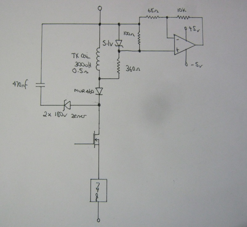

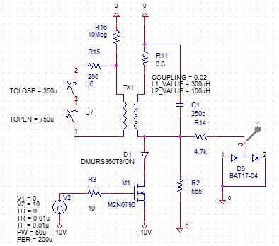

                  One of my detectors uses a similar method to your two diodes in series with the damping resistor. The main difference is I use a 5.1v zener in series with the damping resistor and a variable resistance in parallel with the zener, set to about 90 ohms. The amp connects directly across the zener and I can sample under 8us with a 120us tx pulse.

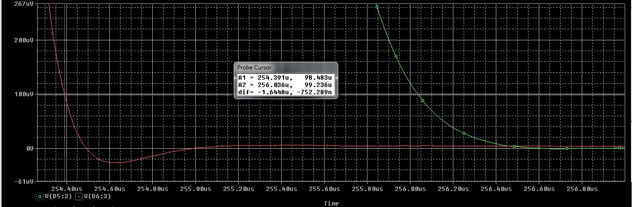

                    Here's a screen shot showing the output of the preamp running about 140x gain. Sample pulse actually starts just after 6us.
                    The coil is 291uh 0.5ohm

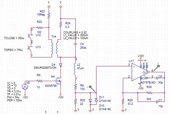

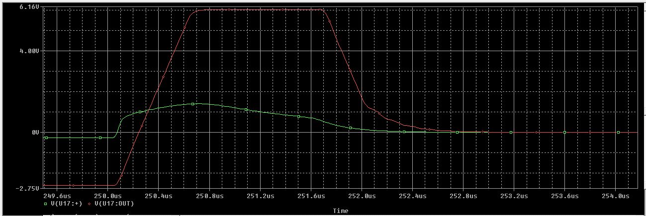

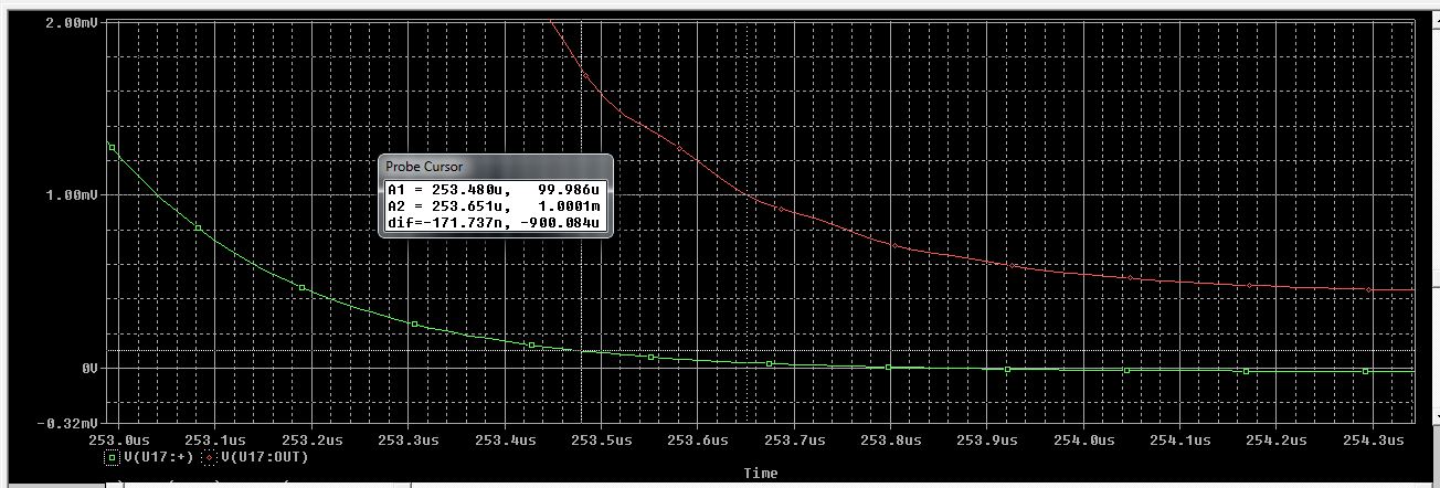

                      Have you tried connecting it to a preamp?
                      • #56
                        Here's a basic schematic of my detector frontend.
                        • #57
                          Yes but only in a simulation. Here it is :
                          I use a low noise but fast opamp AD797B with a gain of 10 in order to not saturate the amplifier.
                          Below are the waveforms at input and output of the amplifier :
Name:	R+L+D+Preamp Full Wave.JPG
Name:	R+L+D+Preamp Detail @100us.JPG
                          The output reach 1mV (100 uV input with 10 gain) at 3.65 us after Txoff command. So it is possible to sample at less than 4 us.
                          Next time, I'll present my ideas for the receiver following the preamp.
