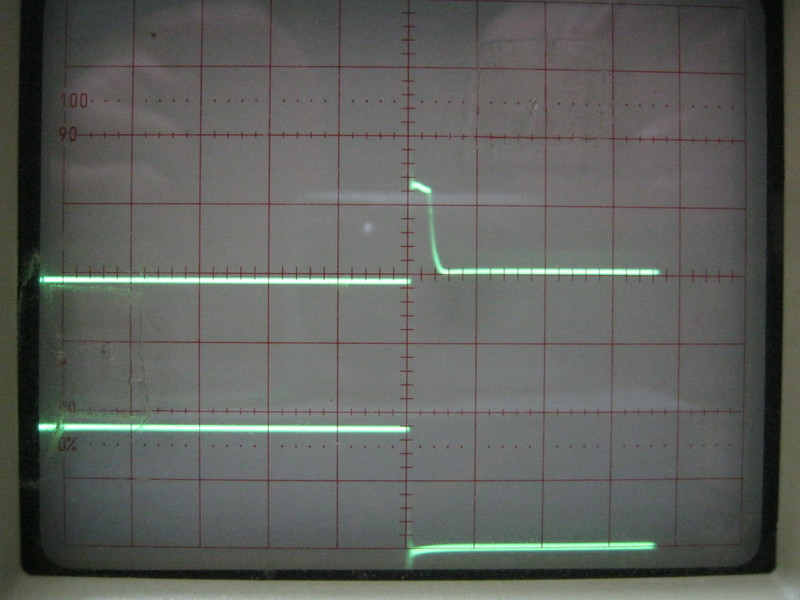

        • #64
          Here's some more screen shots, scale is 10us per div. First pic is flyback, the second is at the input of the amp and the third pic is the output of the amp.
          Can detect 6x6mm side wall coke can, between 11 and 14cm.
          • #65
            mickstv - I don't doubt that your design is working as described. It is fundamentally different to what phiphi was suggesting.
            • #66
              Tried the 6x6mm can with my circuit(detect at 125mm, GEB off). I have about 10x your amplifier gain. Integrating between 6 and 16.2usec after turnoff(total integrator gain about 100). I think the average signal is about 1/6 the signal at 6usec. Wondering how you are sampling amplifier out. With an A-D(how many bits?). With an integrator(sample times and total gain?) Calculated your amplifier gain at 32(10k/68*100/460). I see reply #54 shows a 5usec sample(missed it before)

              • #67
                I just thought I would post some more cro shot's of it running.
                It runs 3 samples S1 (5us), S2 (130us) and S3 (125us). I use a single ended integrator with 4.3k input resistor and a 1m resistor with 22nf cap in parallel. The output of the integrator goes into a LPF with a gain of 2.2x.
