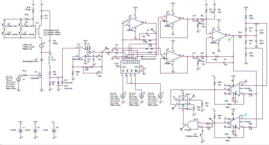

        R9 and R27 are forming a voltage divider so the input to your first amplifier is 1/10 vcoil. The first amp gain is approx 10 ... so your amplifier gain is effectively lost by the input divider R27/R9.
        I've already pointed out that problem in post #69, and here was his reply:
        Originally posted by Phiphi View Post
        Yes, you are right, the damping resistors and the diode form a potential divider but not a linear one. When the voltage is high, the current in the diode is high and it's equivalent resistance is very low so there isn't a significant current in the 22 ohms resistor but at low voltages, the current in the diode is very low and all the current runs in the 22 ohms resistor and we have a potential divider 22/( 22 + 738 )
        That's the same in the classical solution for high voltages but for low voltages, the equivalent resistance of the diode is very much higher than the 1k resistor and there isn't any attenuation.
        However, I think my solution remains to be considered. It seems possible to optimize the ratio between the two damping resistors to decrease the decay time without attenuate too much. For example, with 675 ohms and 75 ohms, the attenuation is a 5 factor and with an amplifier with a 5 gain, the equivalent circuit has an early sampling at about 4.5 us to reach 100uV at amplifier output.

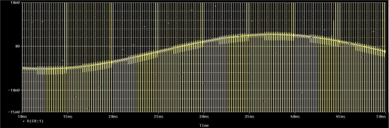

                    • Originally posted by Phiphi View Post
                      Next time with the results !
                      I come back with new simulations. Here is the schematics with some modifications :
                      I have added a voltage source in series with the coil with 2mV offset to simulate a constant field and a 4 mV sinus at 20 Hz to simulate an other varying slowly.
                      At the outputs of U3 and U4, I have added a high pass filter to attenuate low frequencies. This has a differentiating effect so I have two thresholds created with resistors R17 to R20 used by two comparators U18 and U19. These comparators associated with the D flip-flop U20A create at the flip-flop Q output a pulse when the target is under the coil.

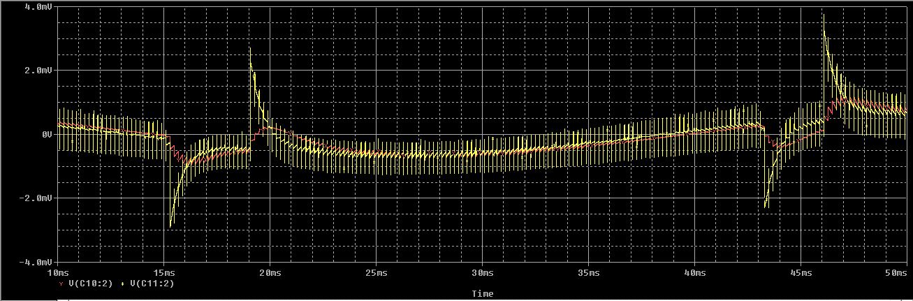

                      Here are some waveforms :
                      First, a zoom on the preamp output showing the effect of the voltage source in series with coil

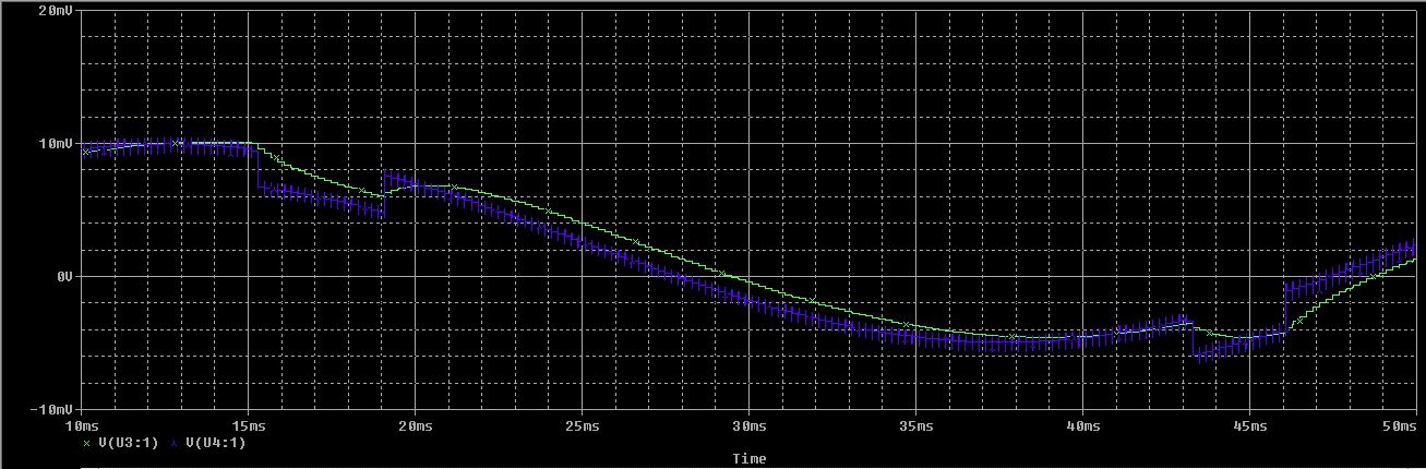

                      Now the outputs of fast and slow samplers :
Name:	Fast and slow samplers out.JPG

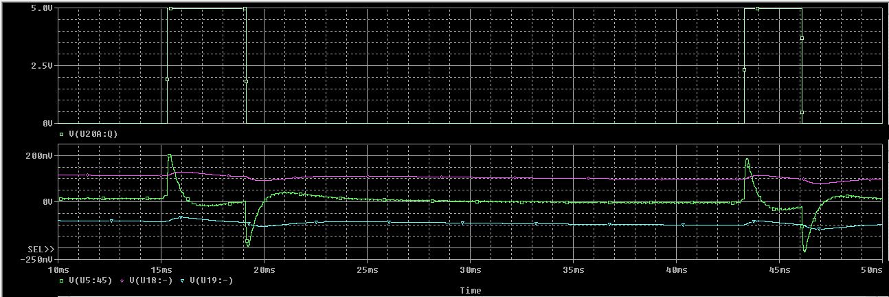

                      And finally, at the bottom the output of U5 amplifier and the upper and low thresholds and on top the digital signal at "1" state during target detection :
Name:	Out + Thr + Logic out.JPG
                      So it's possible to detect a target even with a field varying slowly. OK, I know that I have to build it and prove it works really but simulations are really useful before doing that !

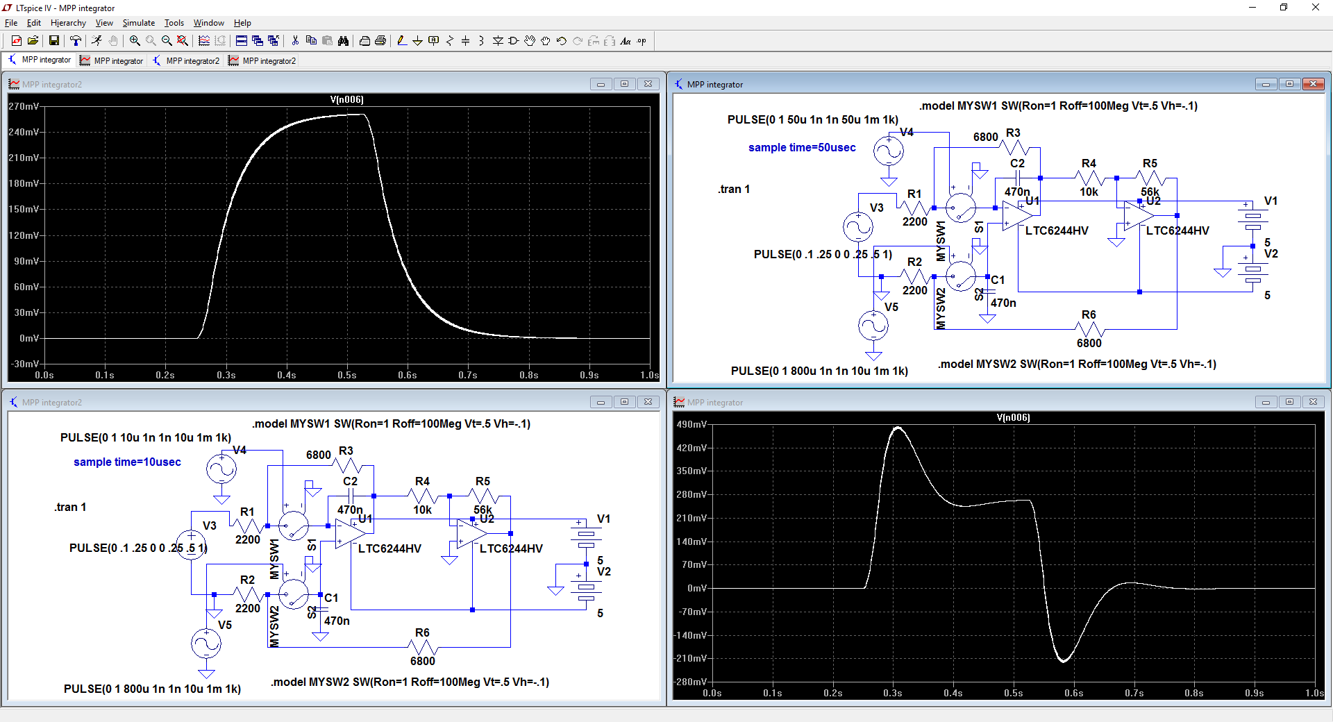

                        Eric hasn't posted any circuits yet. Thought I would try the MPP integrator to understand it better with LT spice. Tried voltage controlled switches instead of fets. Wanted to do an AC analysis to plot frequency response when changing sample times or gain. Analysis is way to slow. Tried a 5Hz input with 10 and 50usec sample times, still slow but usable. Didn't get a 5times increase in signal with the 50usec sample that I would expect with a 1C integrator. Any ideas on how to improve the setup? Tried the AC analysis again, different but still doesn't look right. Doing something wrong.

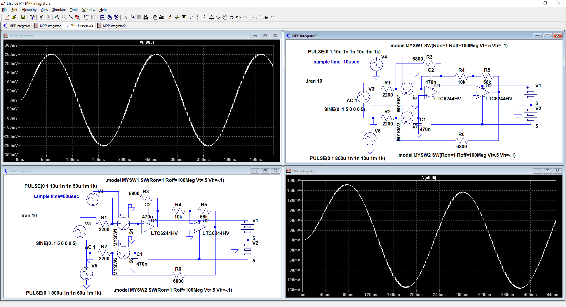

                            Thanks for the reply. When I replied (Eric hasn't posted any circuits), it was about using spice for modeling circuits reply #76. I tried the MPP integrator because I've never understood how it works.
                              I contacted Eric, and he will provide the circuits when he has some spare time.
                              In your post you stated that you wanted to run an AC analysis on the MPP integrator. However, your waveforms are from a time domain analysis.
                              Have a look at the analysis command in the schematic. It says ".time" in both cases instead of ".ac".
                              An AC analysis is also known as a small-signal AC analysis. The simulator linearises the models around the current operating point, and therefore the results are only good for small signal changes. For a large-signal analysis you would need to use a different technique known as harmonic balance simulation, but this is not available in LTSpice. Also, even if you set up the analysis as AC, the switches (or even fets used as switches) are essentially time domain devices, so the results of an AC analysis would be nonsensical.
                              Your only option is to run the simulation in the time domain, and then perform an FFT on the results. However, I'm sure just how useful the results will be in that case.

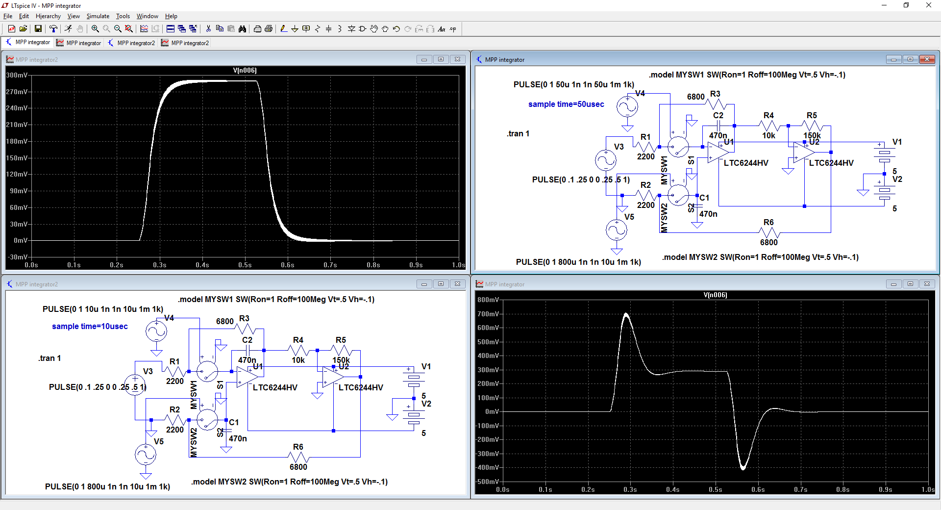

                                Tried a square wave input, easier to see response. (_2) 10 and 50usec sample time with R5(R22 MPP) 56k, (_3) 10 and 50usec sample time with R5(R22 MPP) 150k. Not what I was expecting, maybe something wrong with my simulation.
