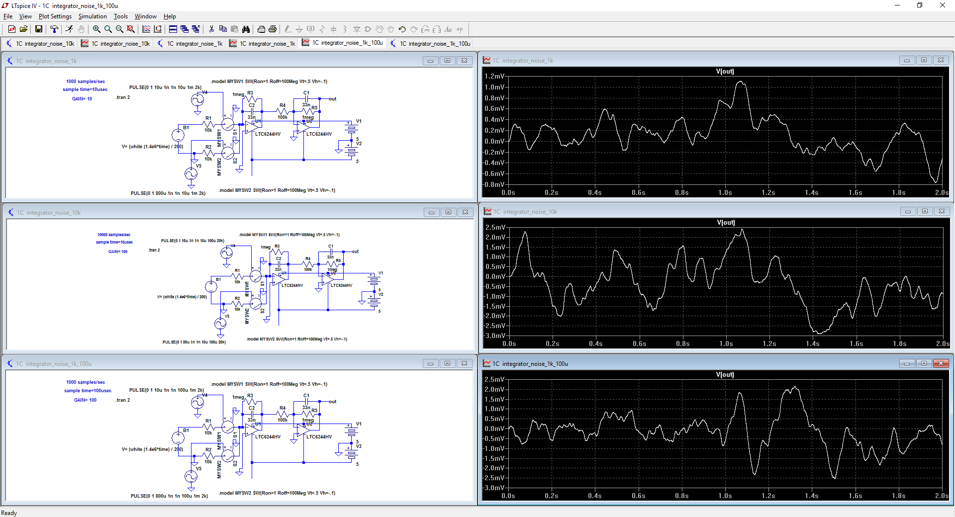

                I was hoping I could look at integrator out with a random input(resistor, amplifier noise) to see if it looked similar to what I see on the bench circuit with a scope. Tried the spice integrator(sample rate=1000Hz, target sample=10usec, EF sample=10usec) integrator input=.1 volt sine wave at 5Hz, 1005Hz, 50005Hz. Integrator out was the same 5Hz signal at the same amplitude for the three inputs, matches sampling theory. I can't find what sampling theory predicts for a random input with no antialiasing filter to verify the bench circuit makes sense.

                          Seems to be doing what I want. Couple questions. How to calculate the cutoff frequency of the MPP integrator? What does the statement in the LT spice noise generator mean, V= (white (2e6*time) / 10)?
                            The equation for the white noise source is V = white(x * time) * Y
                            The current time of the simulator is used as a seed for the random number generator, which creates an output between -0.5V and +0.5V.
                            You can use the Y parameter to scale this output. So, in your example Y = 0.1, and the output will swing between -50mV and +50mV.
                            The X parameter affects the spectrum of the noise. Try different X values to see how the output changes.
                            By the way, the random noise source generates a consistent (repeatable) set of random numbers (if that makes sense). If it was truly random, you would never be able to reproduce the same set of results each time you ran the simulation. To get a different set of random numbers you have to change the seed.

                              • LT spice, 1C integrator white noise example. Top example gain=10, middle and bottom example gain=100. Middle and bottom, noise increased about 2.5 times giving an increase in S/N of about 4 times.
