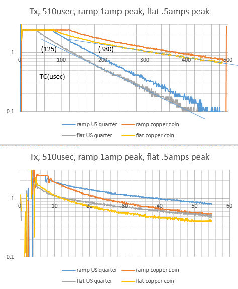

    Another attempt at measuring the TC of a US quarter and a 1 troy ounce 99.9% pure copper coin(guessing it would be close to a US silver dollar). US quarter TC(at least 125usec), copper coin TC(at least 380usec). Are you suggesting a 1200usec flat TX when looking for a US silver dollar?
    If a US quarter has a TC of 125us, then (in order for the reverse eddy currents in the target to fully decay) you would ideally want a TX pulse width of 5 * 125us = 625us. Clearly this is not a practical solution, and in a normal PI setup the coil current will still be rising at TX turn-off.

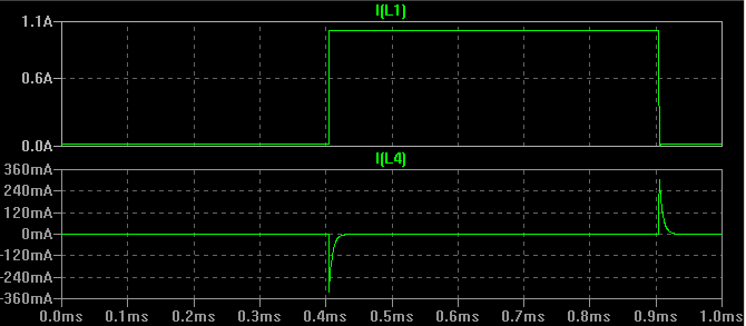

    I will simulate your example later, when I get back home, to show the effect.

            How to convert Hocking Conductivity meter reading to target time constant? Do you see a problem with the way I measured TC for the US quarter and copper coin decay_4?

                The idea that sustaining a pulse "energizes" anything is the wrong mindset. Eddy currents are induced by a change in the magnetic field (B):
                The initial value of B does not matter, only its derivative (change) does. So a change from B = 1 to B = 0 in 1us induces the same eddy current as a change from B = 0 to B = 1 in 1us, but of the opposite sign. In order to measure the eddy, you hold B at its final value (B = 0 in the first case, B = 1 in the second case) so that dB/dt=0 during measurement.
                Top graph: B
                Bottom graph: eddies

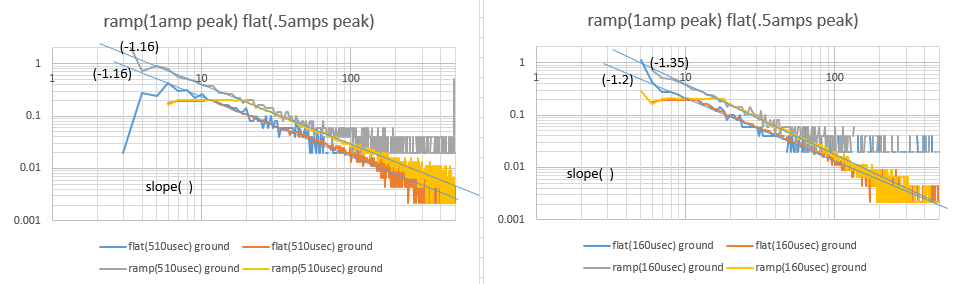

                  I recorded some ground decay curves with a flat and ramp Tx awhile back. The ramp Tx had a steeper slope. Recorded some today with a flat and ramp 510usec Tx and flat and ramp 160usec Tx(Tx time I've been using). The flat and ramp TX slopes at 510usec were the same at -1.16. The amplifier out amplitude for the 510usec flat Tx is about 1/2 the 510usec ramp Tx. The peak current is 1/2 so they would be about the same if peak current was the same. The slope is steeper for the 160usec ramp Tx(-1.35) compared to the 160usec flat Tx(-1.2). The amplifier signal at 10usec delay with the flat Tx is 1/2 the ramp Tx(flat is 1/2 the peak current) but crosses near 500usec.
                        A lot of people suggest that flat-topping the TX current allows the target to fully "charge" or fully "energize." This is a slight misnomer, what they really means is it allows the target to fully "discharge" or fully "de-energize." The turn-on dB/dt energizes target eddies, the flat-topped TX current allows those eddies to die out.

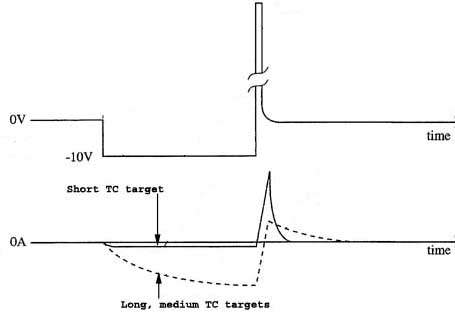

                                Regarding on-time eddy currents cancelling off-time eddy currents.
                                There are two schools here. One transmits a pulse where the current rises quickly and then flat tops for a significant period before switch-off. If all goes well the target is just simply submersed in a constant uniform field for the latter part of the pulse with any switch-on induced eddy currents settled out.
                                The magnetic step at switch-off then causes eddy currents to circulate in the skin. These decay very quickly inducing eddy currents deeper in the target and this process continues until it reaches the center or runs out of steam. This is the onion ring or smoke ring effect.

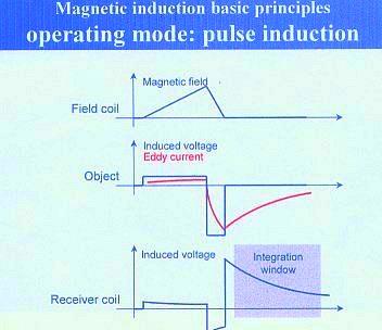

                                The other school transmits a triangular current waveform where the current rises until switch-off. The target current is shown in the attached pictures and makes it easier to see what happens in this case.
                                Note that the current rises rapidly in targets with short TCs and then remains constant while ever the TX current is still rising. The long and medium TC target current rises slowly as shown.
                                Introducing any resistance into the TX circuit would obviously cause the design to become inefficient, especially on long TC targets if the target current begins to fall before switch-off. This TX method relies on the current in short TC targets being held steady and rising in long TC targets. It relies on transmitting a linear current ramp.
                                One figure is from US5506506. This patent also discusses the relationship of the received signal during and after the pulse. Targets with short TCs relative to the pulse length give a different amplitude response during and after the pulse than long TC targets.
