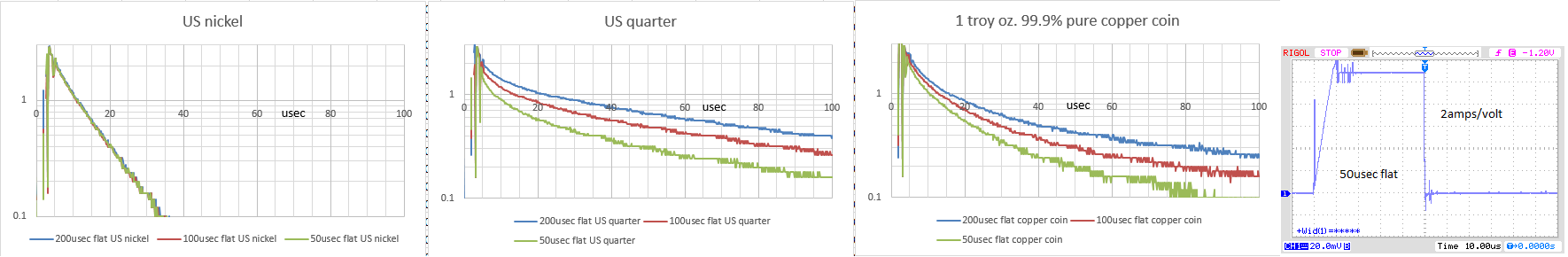

                      Charted three coins with 50, 100 and 200usec flat Tx. US nickel(10usec TC) US quarter(130usec TC after 100usec delay) 1 troy oz. 99.9% pure copper coin(500usec TC after 100usec delay). Each coin was taped to a spacer for about a 2 volt signal at 5usec delay with 200usec Tx to give repeatability when removing and placing the coins on the coil. Charted log amplitude, easier to see the difference at lower amplitudes. Charted target recording-no target recording. Rx(two 1.5 inch round, figure eight) Tx(oval surrounding Rx). Better S/N with the smaller coil. Don't know if the larger coil would chart similar. Don't know why the copper coin amplitude is closer at 5usec delay than the US quarter with the different Tx times. No difference with the US nickel(10usec TC)as expected. About 10usec ramp to flat Tx current.

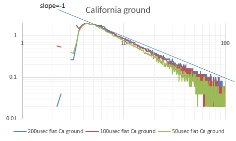

                        Wondered what effect the different flat Tx times have on ground response.
                        • #72
                          So it would seem that the CA ground has a TC of more than 200us

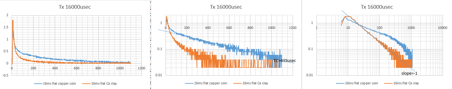

                            Charted the copper coin reply #47 and California ground reply #51 on three different charts(lin.-lin., lin.-log, log-log). Don't know how to determine the ground TC. The coin charts a straight line on a lin.-log chart after a 200usec delay. Ground charts a straight line on a log-log chart. Ground charted a slope of -1 with a 16000usec Tx, with Tx times 500usec and less the decay was steeper.

                              Thank you for the interesting charts and thank you for doing all these tests that give us a better understanding of how PI detectors work.
                              The following comments are more of a guess than anything else. It would be good if more knowledgeable people would give their comments.
                              Looking at the lin.-lin. traces, one can see that the ground decay is considerably faster than the copper. The copper decay has not yet reached 0 at 1100us.
                              Looking at the lin.log traces, the slope of the copper shows 435us, that seems to correspond to the decay or TC of the lin.-lin. traces.
                              Looking at the log-log traces, we see different behavior of the ground and the copper. This seems logical since the copper response is resistive, while the ground response is permitive.
                              It is interesting to see that in the lin.-lin., both traces look very similar, except for the TC, no indication of or difference between resistive target and permissive target.
                              Will samples taken at the beginning of the TX ON time (first 500us) show a difference?

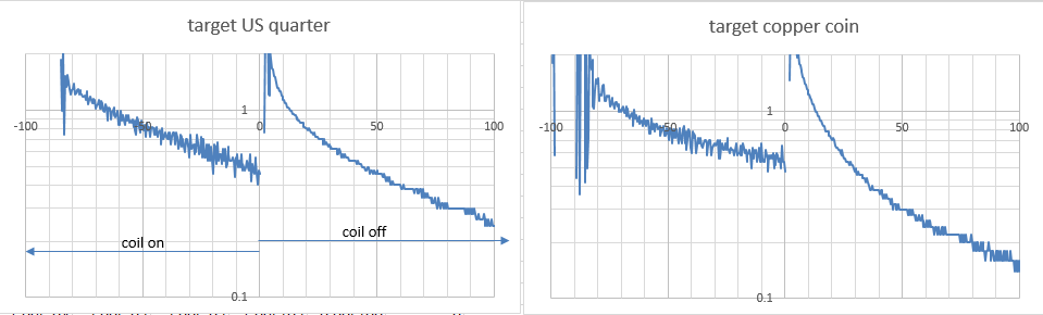

                              • #75
                                Tried charting target decay during coil current on and off. Tx(100usec CC) about 10usec ramp before constant current(90usec). Current is in a servo loop. The loop was to control constant rate during coil on time for ferrous non ferrous indication. To noisy for looking at amplifier out during coil on constant current. Good enough for what I'm charting. Charted absolute value(target signal recording- no target signal recording). 1 troy oz. 99.9% pure copper coin. I would be interested in what ground decay would look like during the constant current on time. Would need to improve constant current loop to chart it. Maybe someone could say what to expect and how it would effect GEB. Tx(1000pps)
