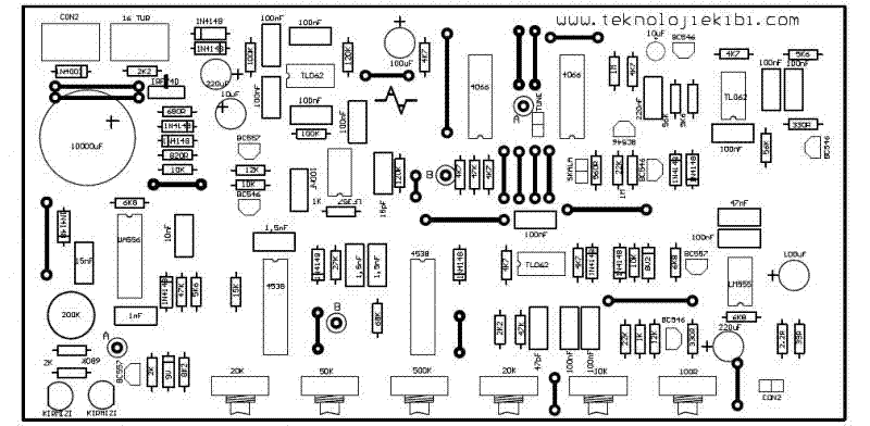

                  What i need ?
                  1-only a Detector when find Gold/Metal/Silver its show or Beep ! only this option !
                  2-work from 1m to more like 5m ? it can be done ?
                  3-some place are Wet/Rain !
                  i know the place of Gold for example in a place with 20mx20m ! but i need to know the final place gold in underground to unearth it.
                  so Which Kit is good for this request list ?
                  Thanks.

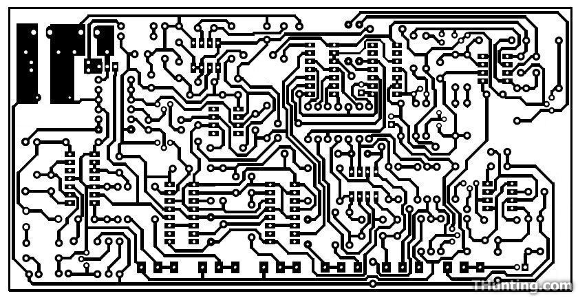

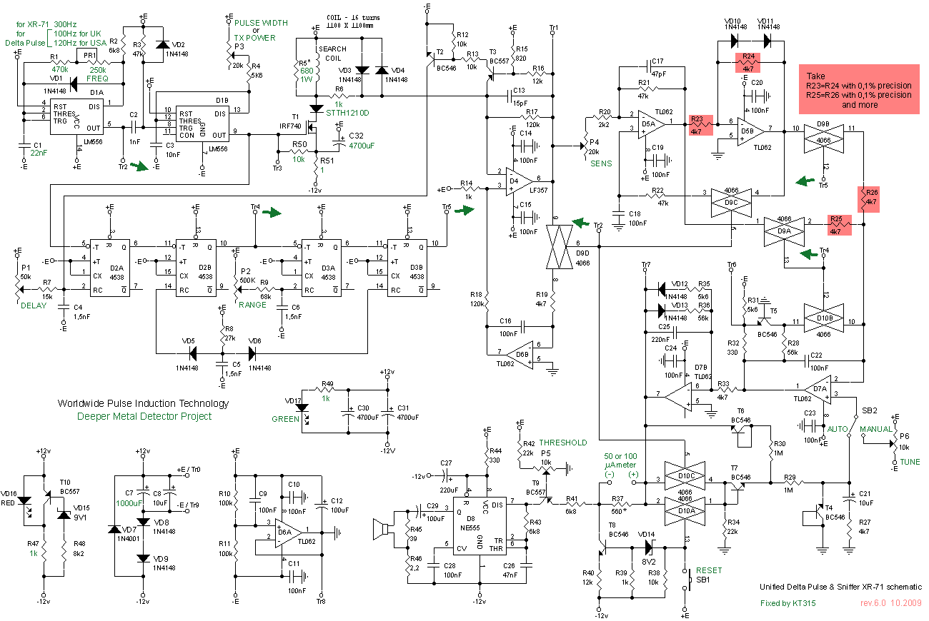

                          Sniffer XR71 or Delta Pulse. Same thing. All files are here, including PDF etch for board. Pulse induction made especially for large finds. Single sided XR71 easiest for home etch PCB, but high parts count.
                          Search XR71 or Delta Pulse for more information.
                          Also google "Delta Pulse Metal Detector Practical Guide" for benham vp's great and comprehensive pdf.(felezyab.persianblog.ir)? I think that is also available over at THunting.
                          Good luck.
