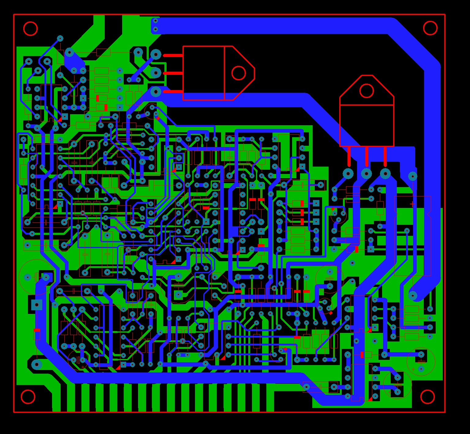

                  I removed nasty paint from pcb to be sure in some traces and vias.
                  So, draw is alright now.
                  Now is time to start analyzing it and pull out some conclusions.
                  Enjoy!

                      Redrawing the pcb was easier part.
                      Now, the rest is much harder.
                      Without schematic, without clue... almost impossible task.
                      Reason i am pushing this is because i kind a feel a potential in this, sort of a hunch.
                      Potential for further improving and playing with.
                      But without more details i can't do much.

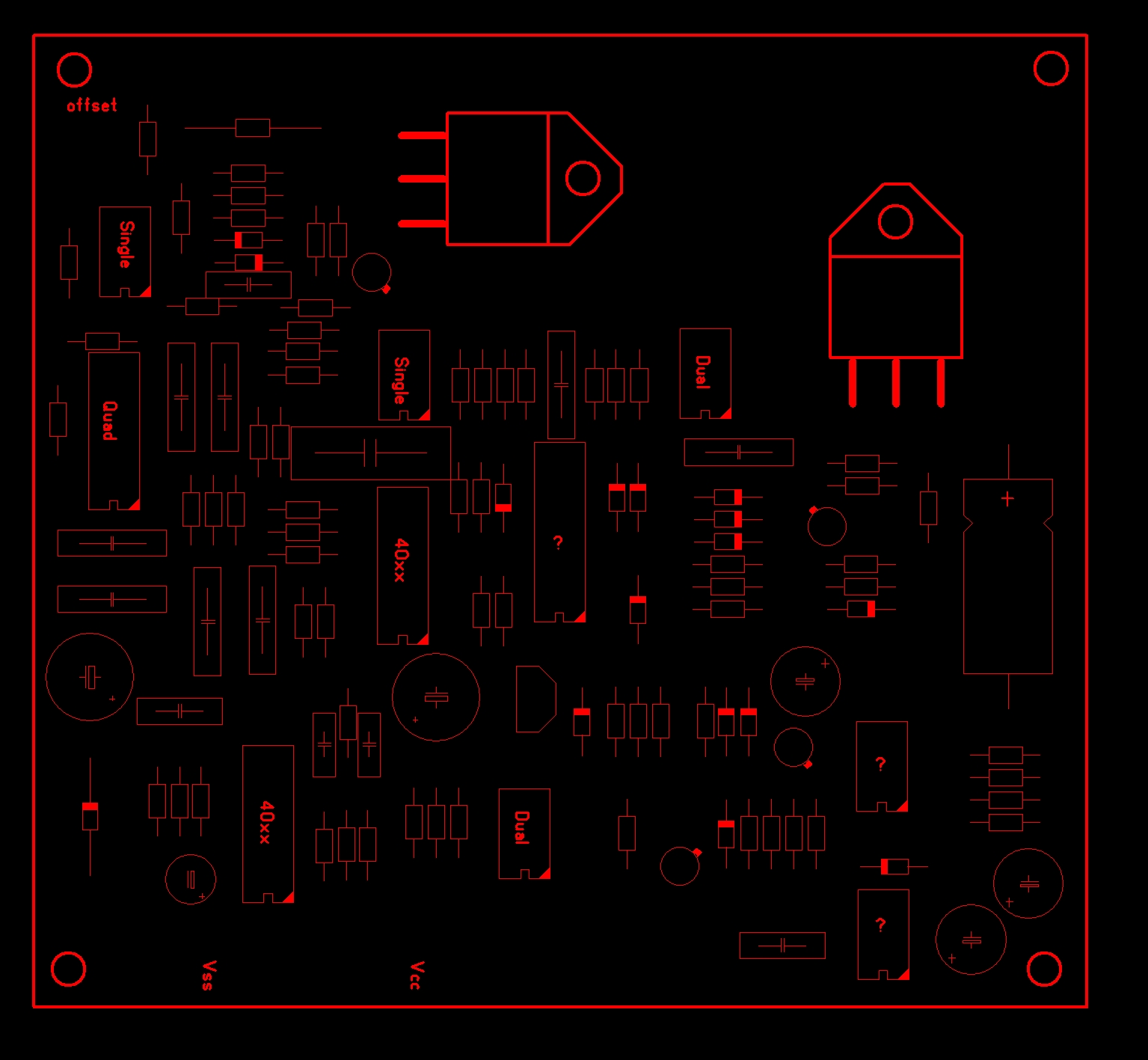

                      So far it was easy to recognize roughly few chips.
                      Front end is most probably NE5534.
                      And there is probably 7660 or LT1054 on the bottom right...
                      Two 40xx's and the one DIL 16 which confuses me by now.
                        Searching widely the Internet for any useful information, no chance!
                        It's like the most kept secret... damn!
                        You can't find any useful info on official sites... apart from lot of nonsense advertisements.

                          Almost certain about few more details:
                            Interesting thing; there is no damping resistor on pcb, there is a serial resistor though !?
                            Bipolar TX or fet!?

                              I think R25 is your damping resistor. A1 and A2 look like the battery connection. B1/B2 the coil.
                                A1 and A2 are battery inputs, no doubts at all.
                                B1/B2 are coil connectors, yes.
                                R25 is parallel to coil, therefore it is damping resistor.
                                Have you opened my last .lay file? I noted all those except R25.
                                I missed to spot R25 because i was pretty focused
                                on (blinded by) R24; its size and role there.
                                And now when you mentioned it; i am starting to get different idea from what i had previously!
                                Since R25 is normal size (1/4W) and R25 is approx. 2W and probably more; than next logical conclusion is that this is not high current PI detector at all! Bingo!
                                Altra you just speed up the process of thinking by pointing on so obvious (and yet "masked" by R24) R25 as damping resistor there! Thanks!
                                So, R24 is there to limit the current through coil and therefore R25 does not need to be "high-wattage" at all!
                                Further, logically; current in coil is small. Why? How? PPS? Role?
                                Somebody earlier mentioned "industrial"....? What exact role?
