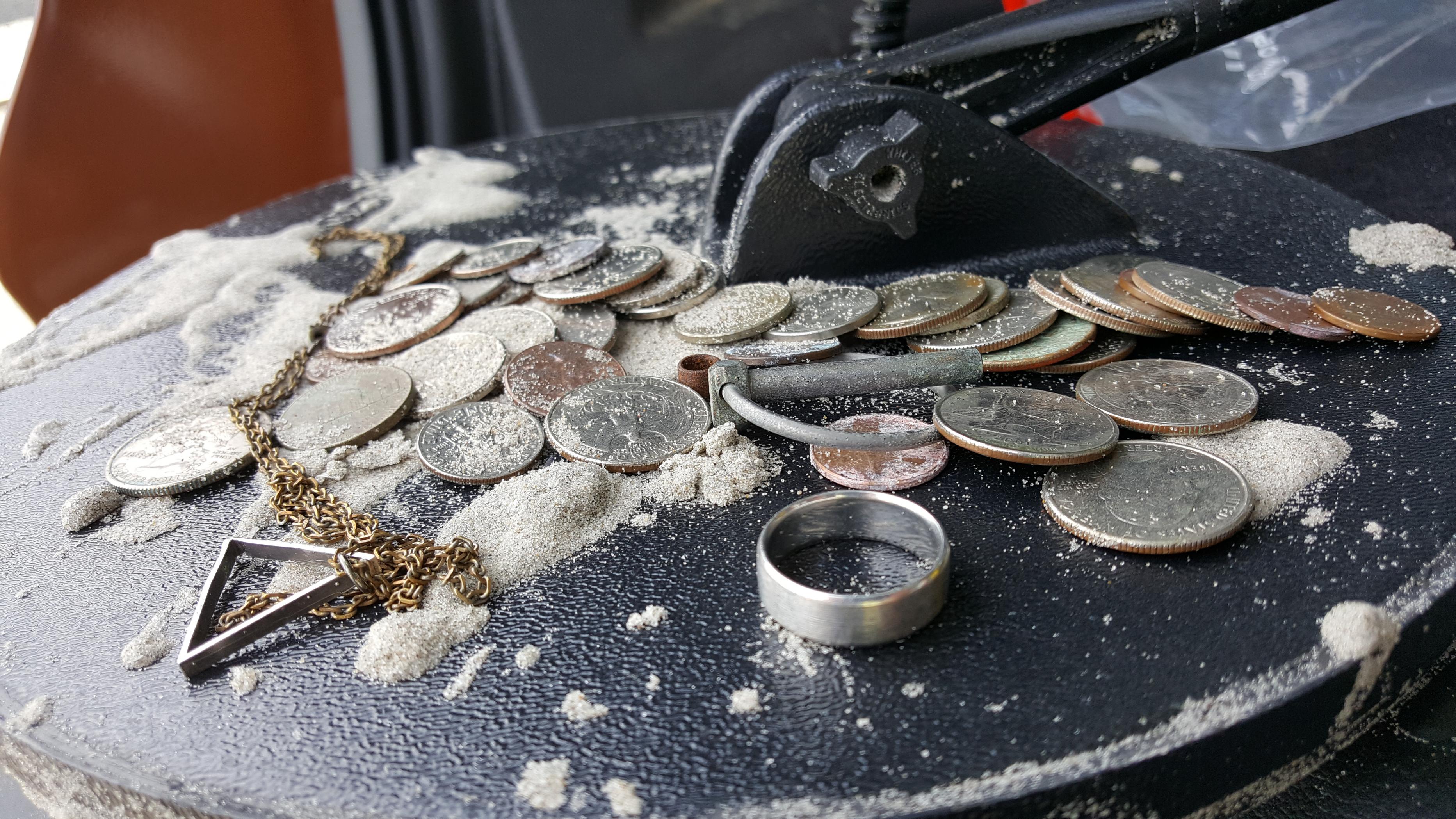

            I have a blast using my PI even in trashy areas. So I keep building. I dig about as much garbage-trash items with my PI as with a VLF.
            Just a sampling of clad not showing the many many $1 and $2 coins I found and spent. Found just as many pennies as the clad pictured. As well as gold rings.
            And this is a cross found with one of my water version PI's owner.

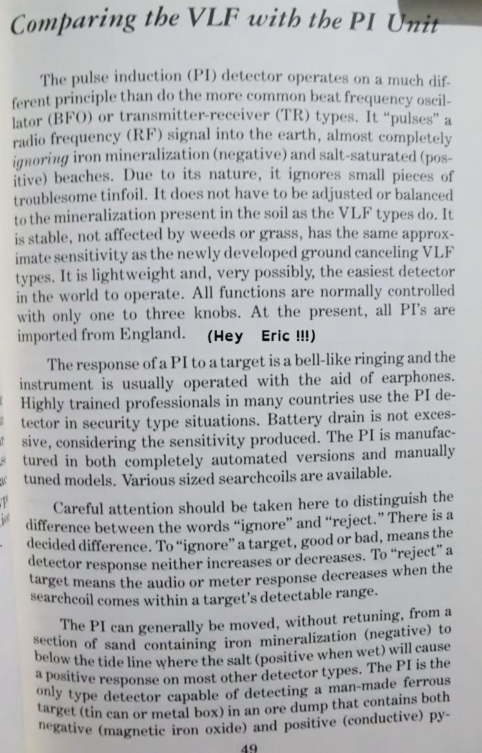

                  Let see what experts (R.Lagal & C. Garrett) say long ago (in year 1979 !!!):

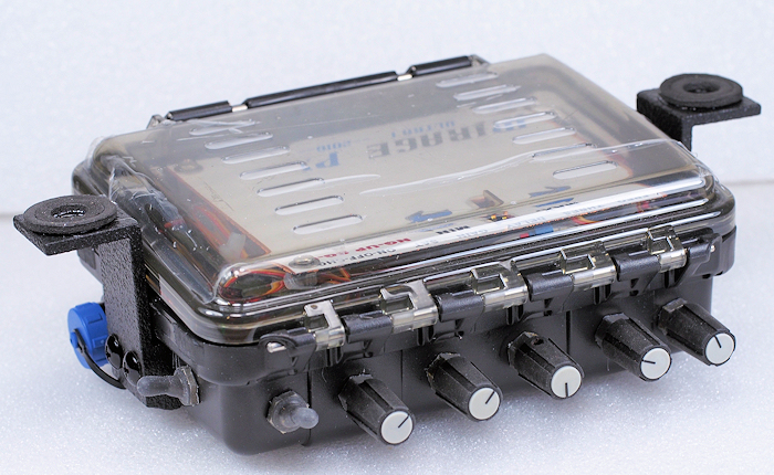

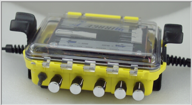

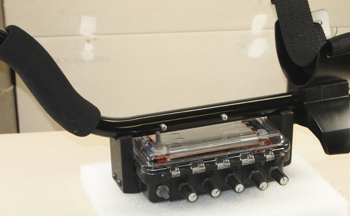

                                I do offer Mirage PCB and component parts kit, have made about 10 u/w units over the past few years. Guys love them for saltwater beach and surf hunting.

                                Just had a new batch of PCB's made. PM me if you want pricing and more info.
                                But, you can also make a water PI from the Barracuda, Mini-pulse, Surfmaster etc.
