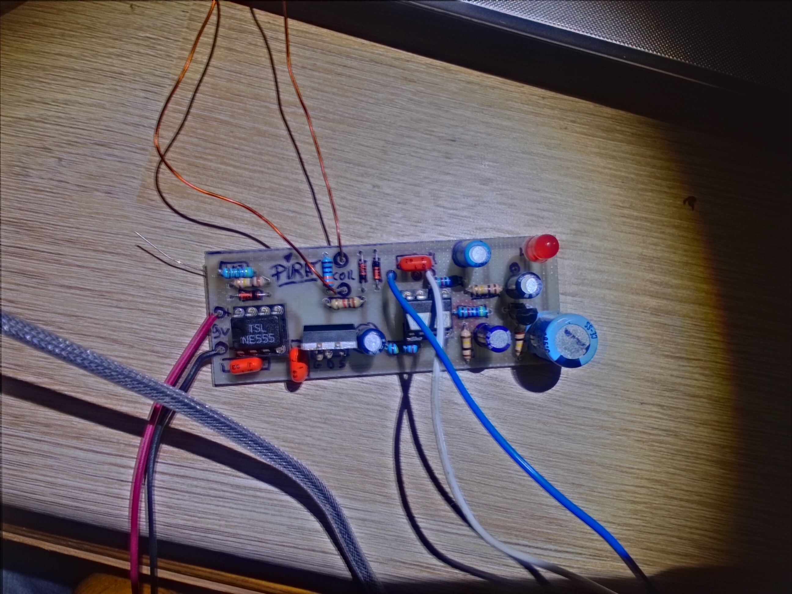

          could you tell me if the transistor is well placed .
          i ve made something wrong it don t work!!!!
          what the data about your pinpoint mod coil wire diameter,number of turn, Henry values,resistance,etccccc.
          thanks
            Who can tell you the correct position of the transistor, since no one knows what transistor you used?
              yes youre right
              i found SUB85N03 instead of 85t03gh and i saw that in my pcb i have soldered it at 360° so it don t work !!!! GRRRRRRR
              will turn it tomorow ,ill say the result
                When turning the transistor 360 degrees you will not actually turn it!
                Look datasheet here http://www.mouser.com/ds/2/427/sup85n03-109419.pdf
                I think your transistor must be paid to 180 degrees to the situation in which he finds in the picture. Then the gate, drain and source will match their places under the scheme

                        thanks for your reply ,effectvely i wanted to say 180° (180° too much !!!!! lol)
                        i ve done it ,controled all the soldering point and........ nothing!!!!dont works!!!!
                        only one blink when a put battery and when i put potentionmeter full there again one blink thats all!!!
                        perhaps my coil but i don t have the data for doing one other?????

                            Hello Nick, i think this pirat dont work. I have made several Versions of it, but it is waste of time, Better results with pi4 from itmd book
                              Nick
                              I think that from now all questions should be directed to Kosacid.
                              This is not a scheme of detector Pirat as you think. I attached archive where you can see the scheme of Pirat. There is also a file layout of pins original integrated circuit К157УД2 that Russians use. If we compare its pins with the fpins of LM 358 will see that the board of kosacid is full of mismatched pins.
                              If Kosacid wanted to do pinpoynter scheme Pirate, it means that the board is confused and will not work.
                              If he worked in another scheme that we do not know, then let him answer questions.
