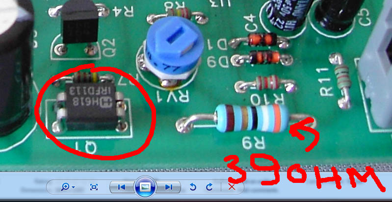

                          ok. i grasp with 3.2kHz you want to make C-Scope 6PI... but then a coil must be with 1mH value... NOT 300uH.
                          irfd110 has also less low R in open state... compare datasheets on both 9640 and it. so heat energy on irfd110 is very low, a coil
                          also has high ohm vs 300uH coil, also in serial with coil sets a resistor... all those gives low heat on the FET.
                          and all that was keeping in consideration by you.
                            if you do not believe me look this pic and on this resistor in serial to coil
Name:	Без имени-4.jpg
                              I suggest trying lower voltages on the Mosfet - try 9/10/12V.
                              Hi eclipse...ive tried 12v but back emf spike is still 250v........at 9v the back emf is 200v but not good depth proformance...im a bit confused with frequency cause i thought 3.2 khz is better than say 400-800 hz for finding small gold items
                              if you take for example white's tdi sl which i read is using around 3.3 khz tx...then why does a top line deep detector like this use a 3.3 khz frequency ?????
