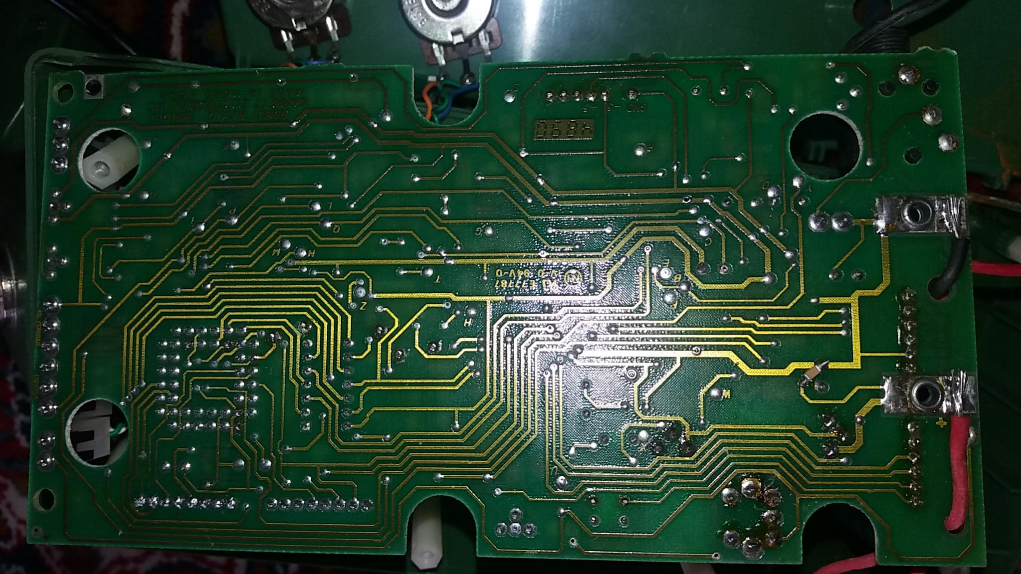

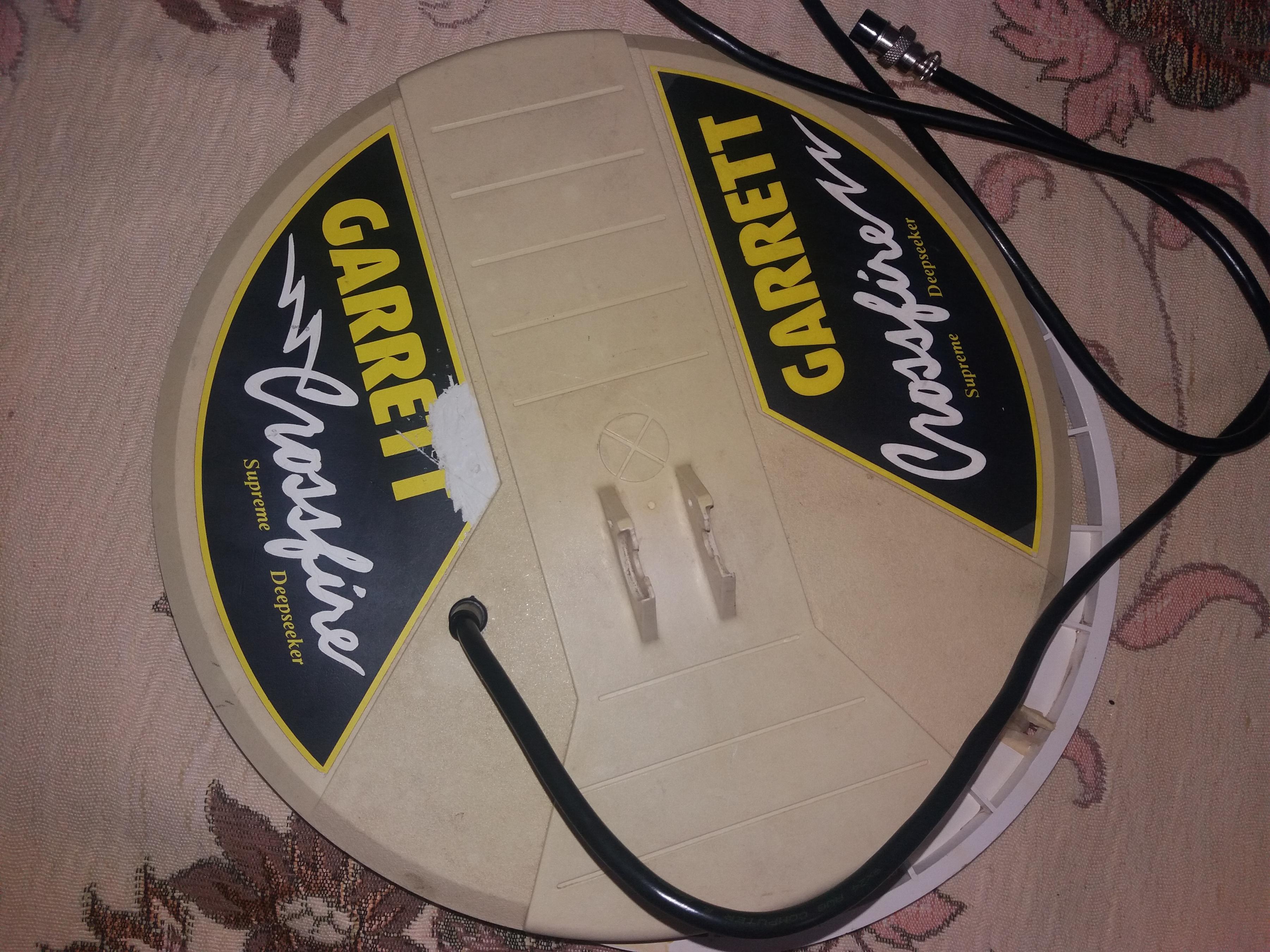

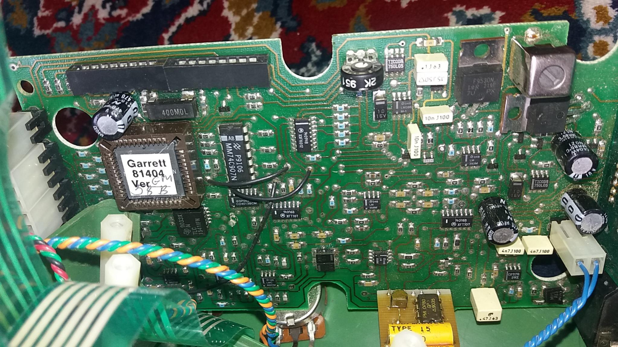

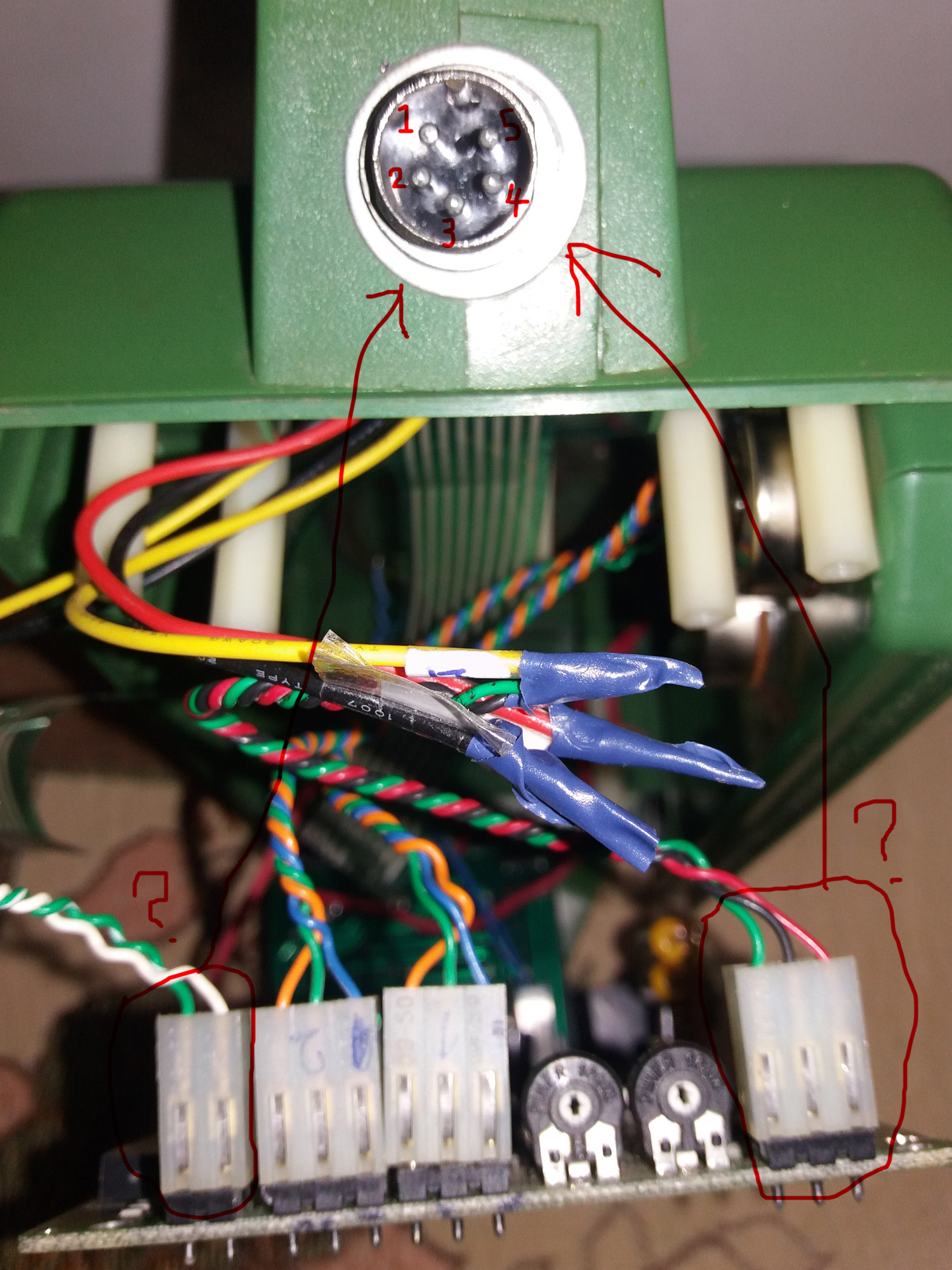

    Hi
    i have an garrett grand master hunter cxii metal detector and i went to know about coil connectors from board to 5pin connector
    my crossfire coil Coil wires have been torn and i dont khow the right connections
    can anyone show me a picture from main pcb for coil to 5 pin connectors and inside of crossfire coil?
    this is my broken connector pictures:
Name:	pcb to 5pin.jpg

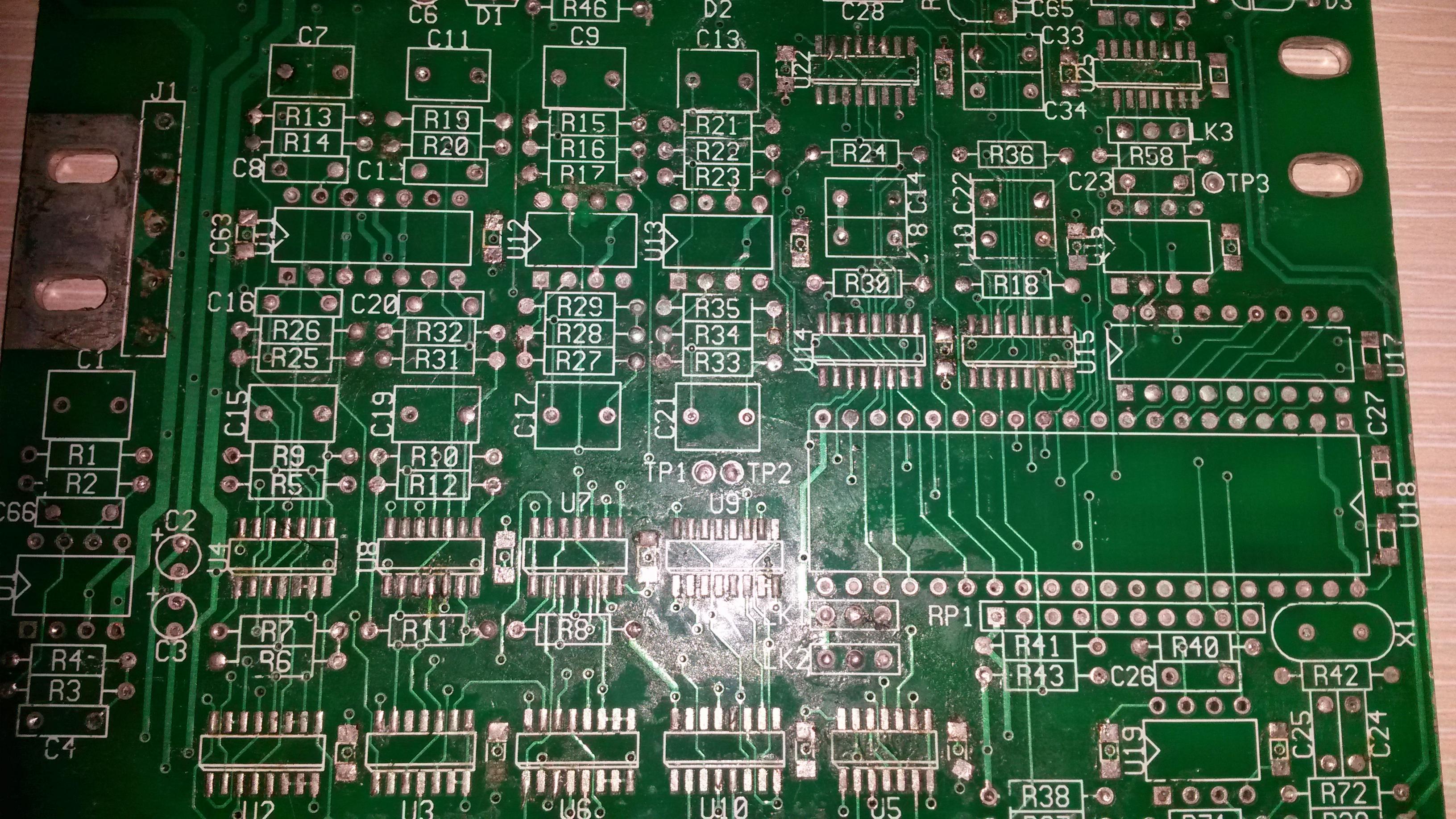

    i am ready to help you but see what people send me. thats REAL TRASH!
ID:	347257Click image for larger version
ID:	347258Click image for larger version
ID:	347259Click image for larger version
ID:	347260Click image for larger version
      again guys I URGENTLY AND URGENTLY ask you do the images more legible.
      please do these step by step!
      1. wait clear sunday time. the sun must be VERY OPEN!
      2. GO OUT from your home, at your homeyard, at the sunlight.
      3. place PCB so the sun light will be from left upper PCB corner.
      4. the shadows must be short, but they must be!
      5. do a photoshooting.
      6. you have NOT EVEN A TINY CHANCE here to get the answer if you are doing your Home Work poorly and woorse.
      7. set your camera on high resolution. your pics has to be from 5MB and more.
      8. send your pics to
      [email protected] with subject in subject field:
      new hires pics of board [detector model name] for your collection.
      9. Forget your egoistic intentions only take on and give nothing in return.
      do not cultivate your EGO here.
      10. do not waste your time making pics in your room. you will get only trash absolutely
      unusable. yes, you and me are not professional cameraman and have not the needed
      light pro equipment on your working table, so keeping some rules i offer and you will get perfect pics and btw will learn how to make perfect photos of your family,
      lovingyou, children and the Nature itself. BELIEVE ME thats is EASILY!
      GOOD LUCK IN THIS YOUR NEW HOBBY.
        i give a particle of the PERFECT done pic AS EXAMPLE i got from one geotecher so you have to see WHAT I WAIT FROM YOU

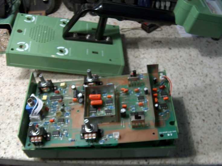

          Thanks. I'll try it in day light

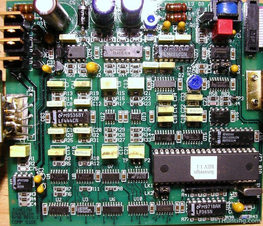

            KT315 are you trying to reverse engineer by pic?
            This is the way to do it the proper way
            Guess to which device this belongs
              this is SOV MINELAB XS2. i do not see a revision of your board just cause it is cutted low part.
Name:	xs 2 pro 011.jpg
                Yup this is Sovereign (the first version) which uses SMD & TH components.
                  kept pics of revision 4 pcb from ebay. which full uses SMD components, thinking it was last one before they make elite pcb.
                  ebay is a source of the pics LOL!
                  i can email you all pics i have on sov xs.

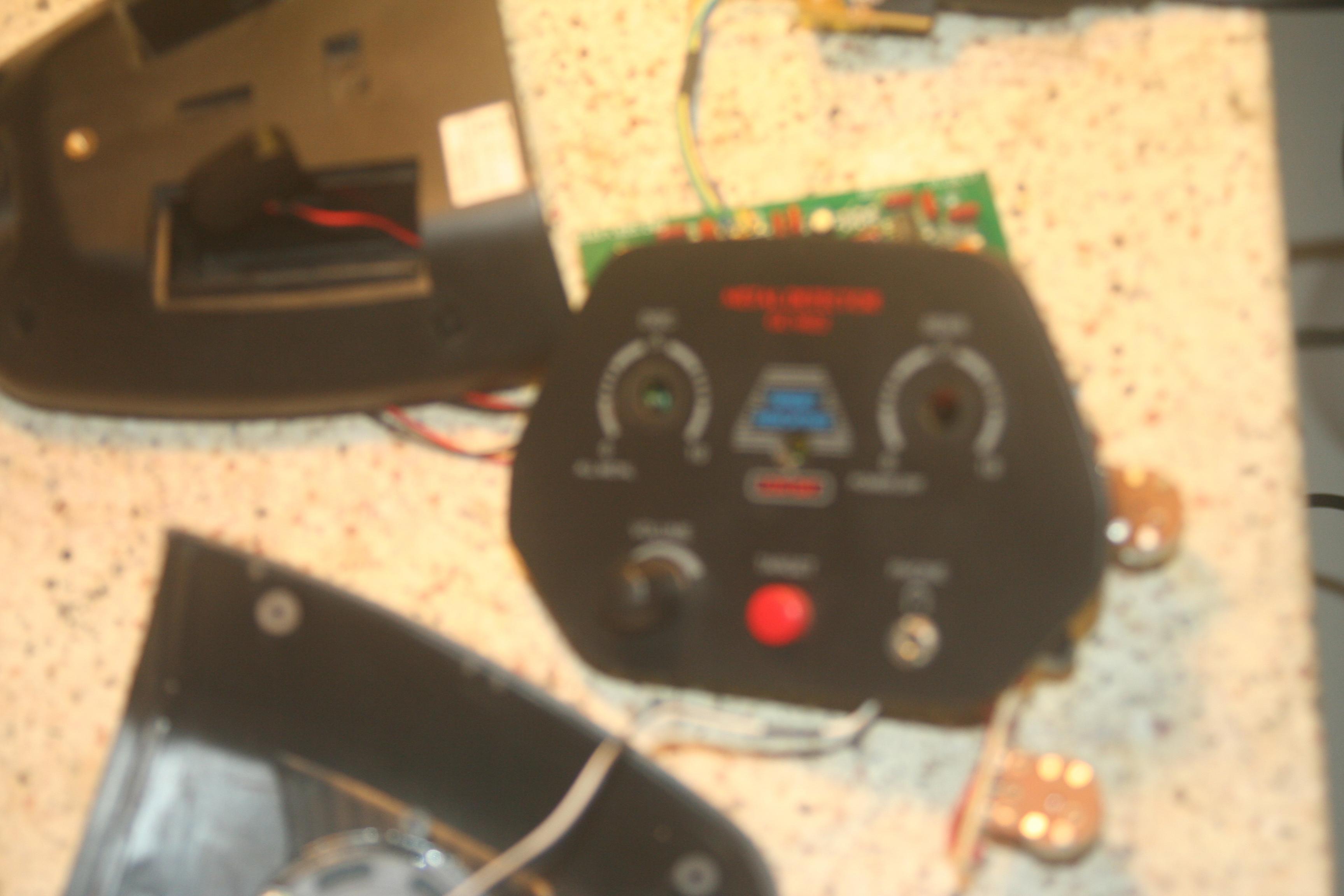

                    people send me pics in THIS quality. you see yourself as they are blur and moon light.

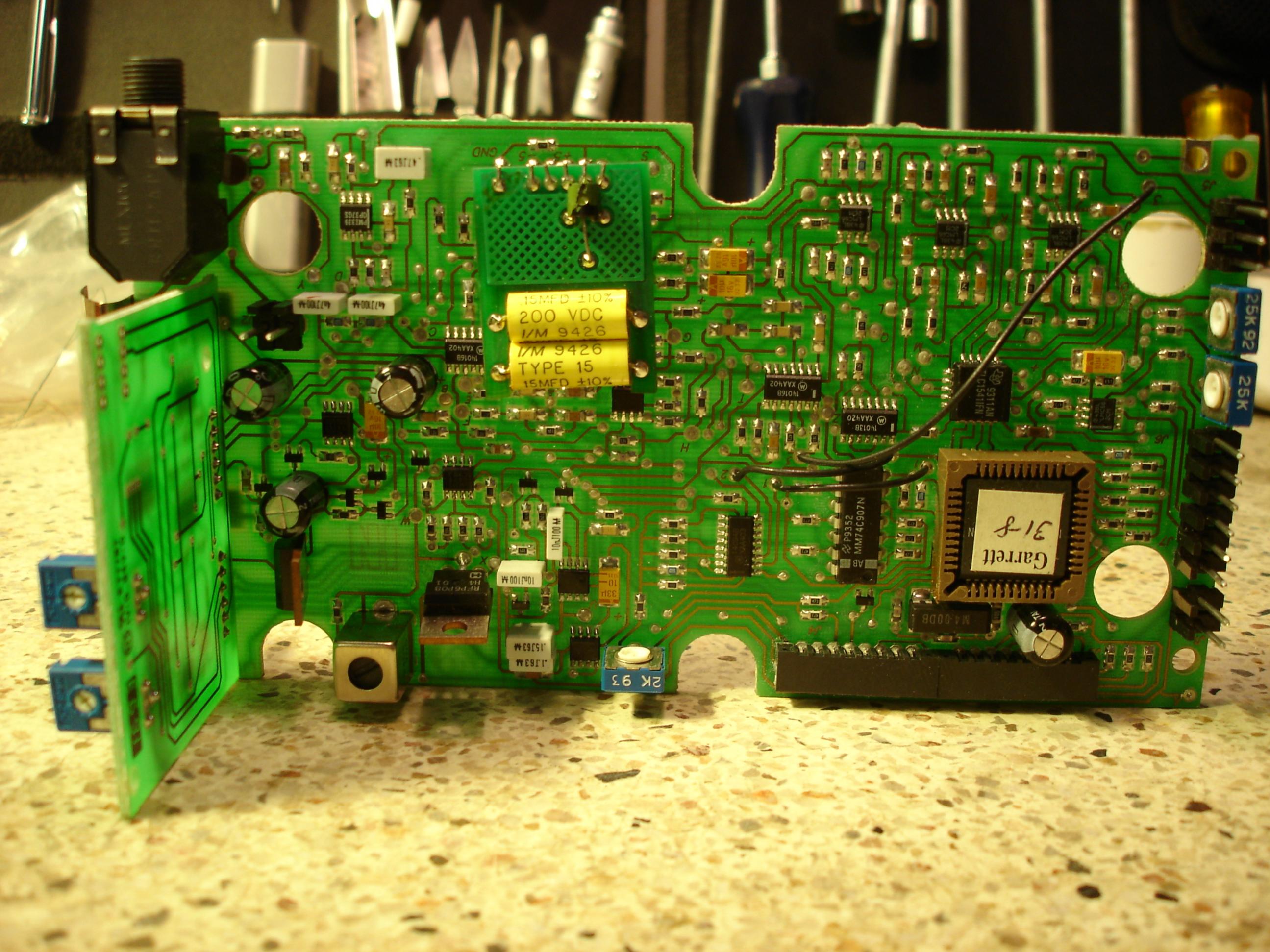

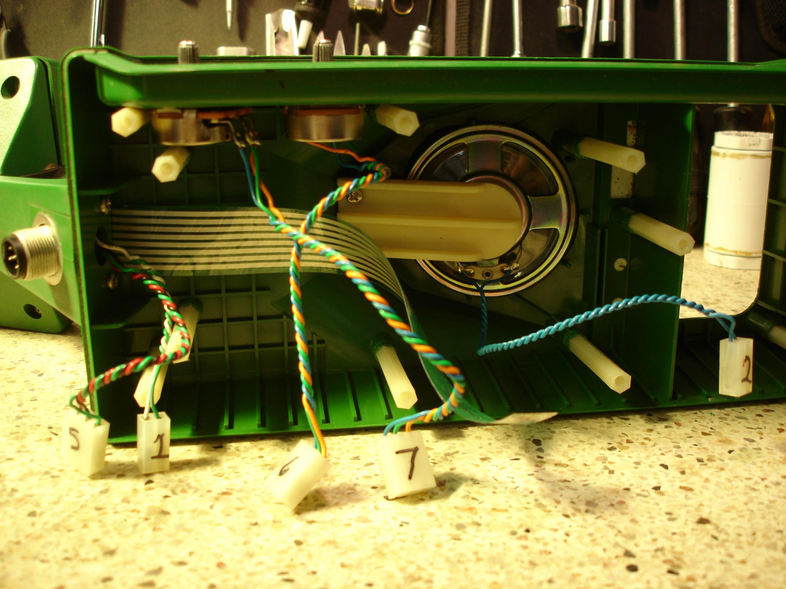

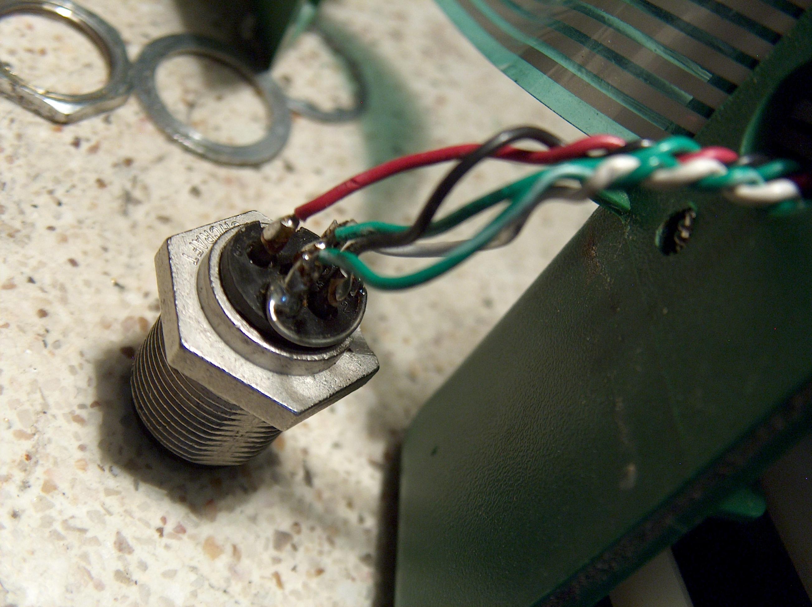

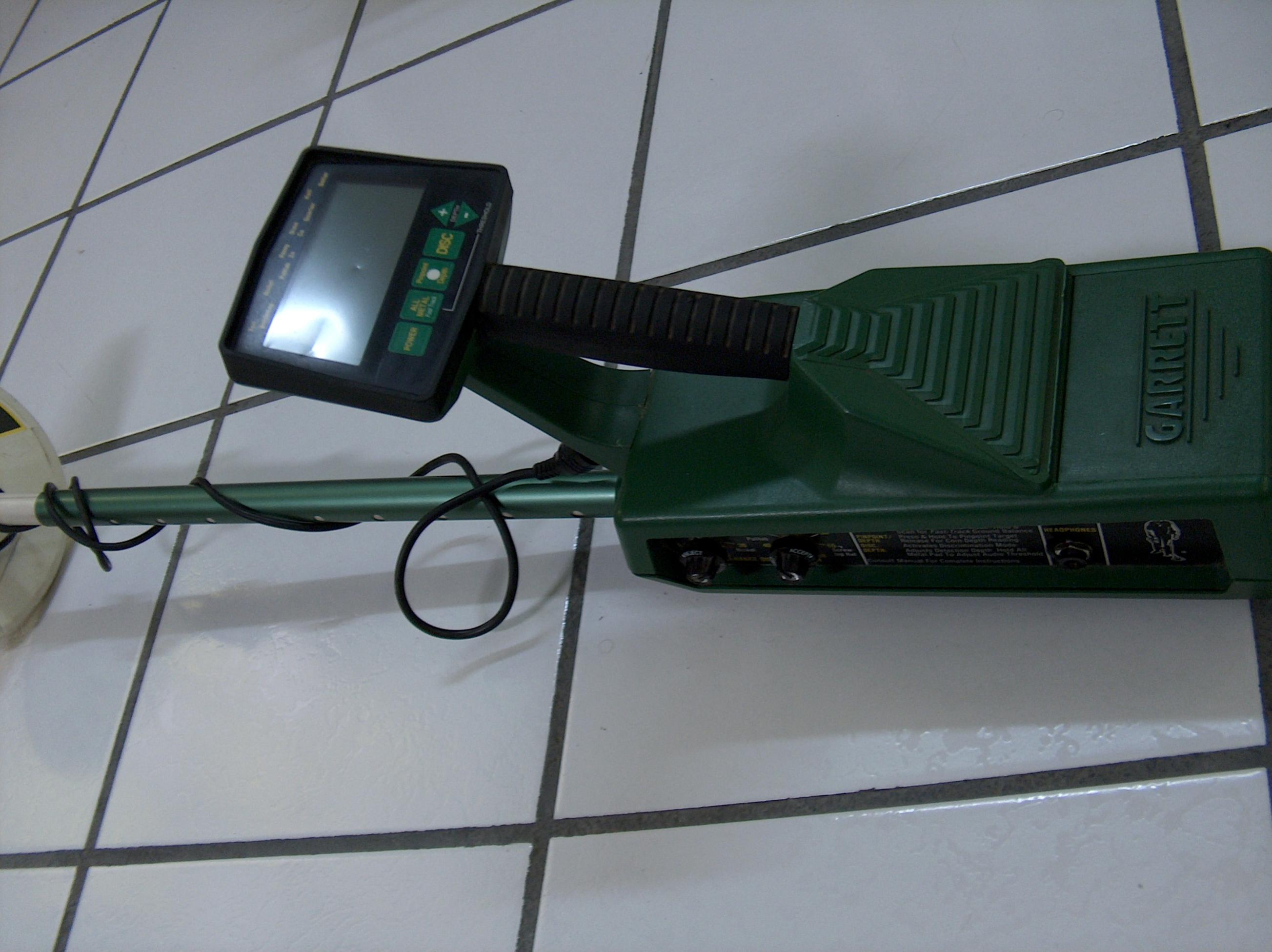

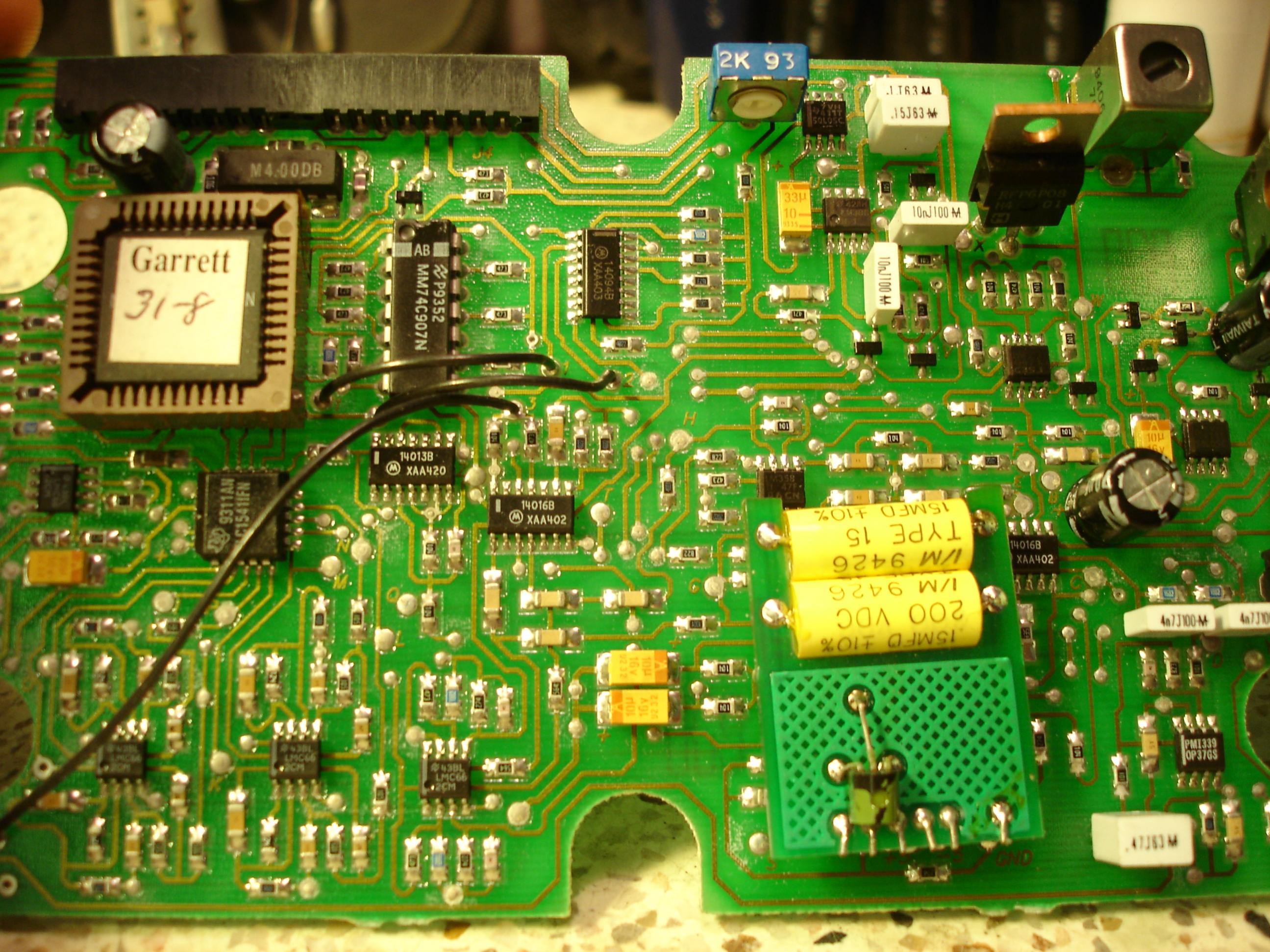

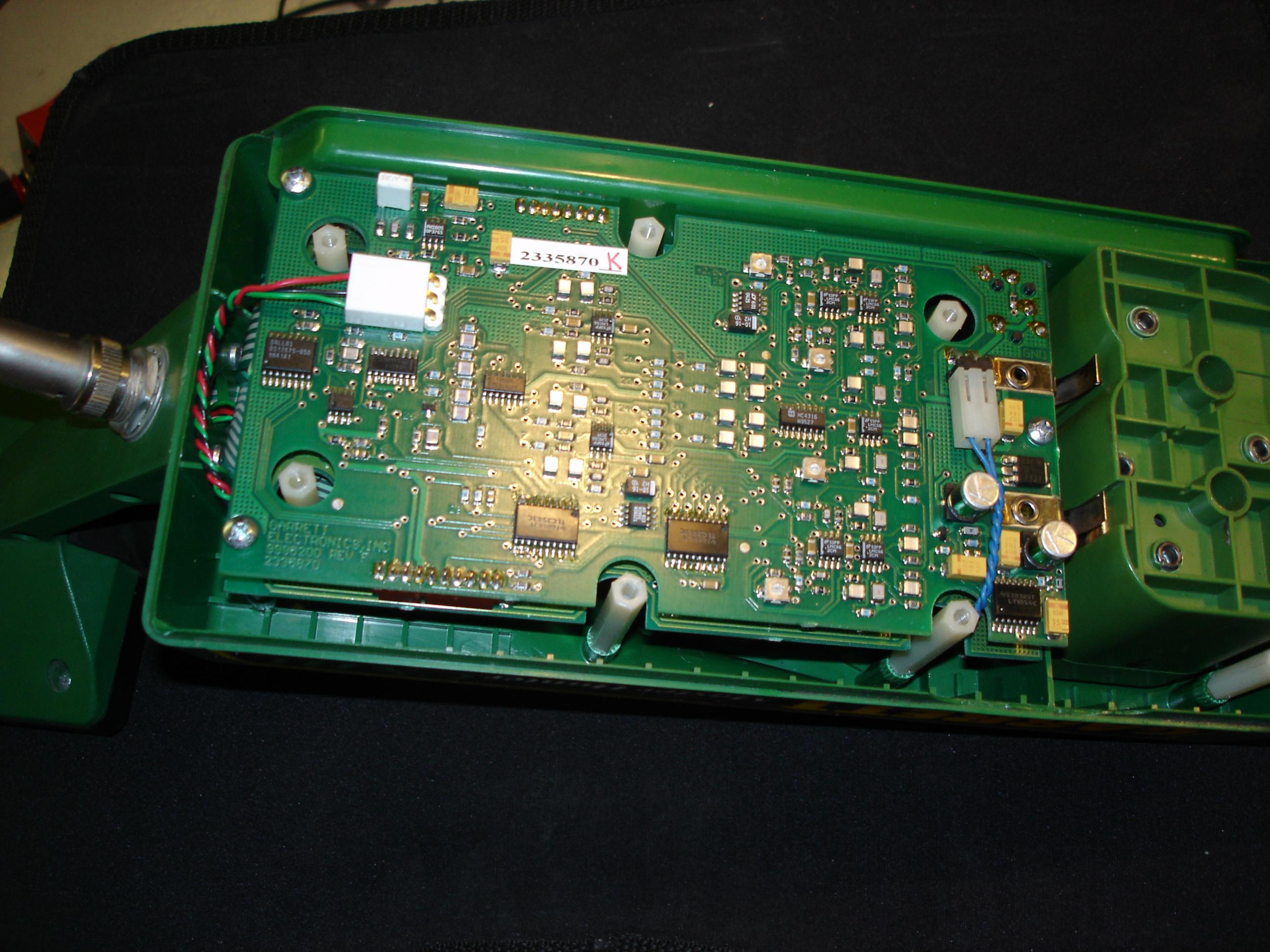

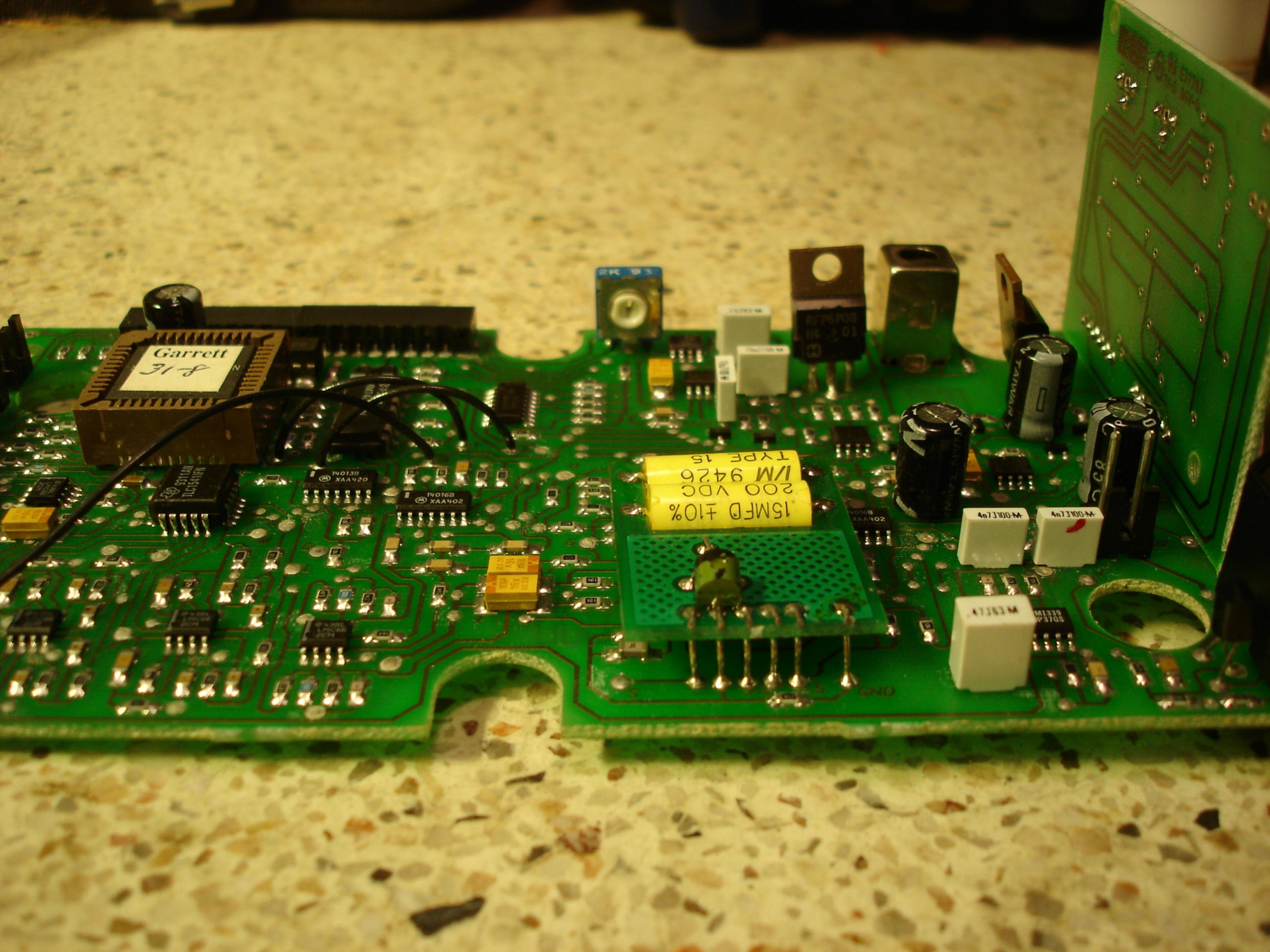

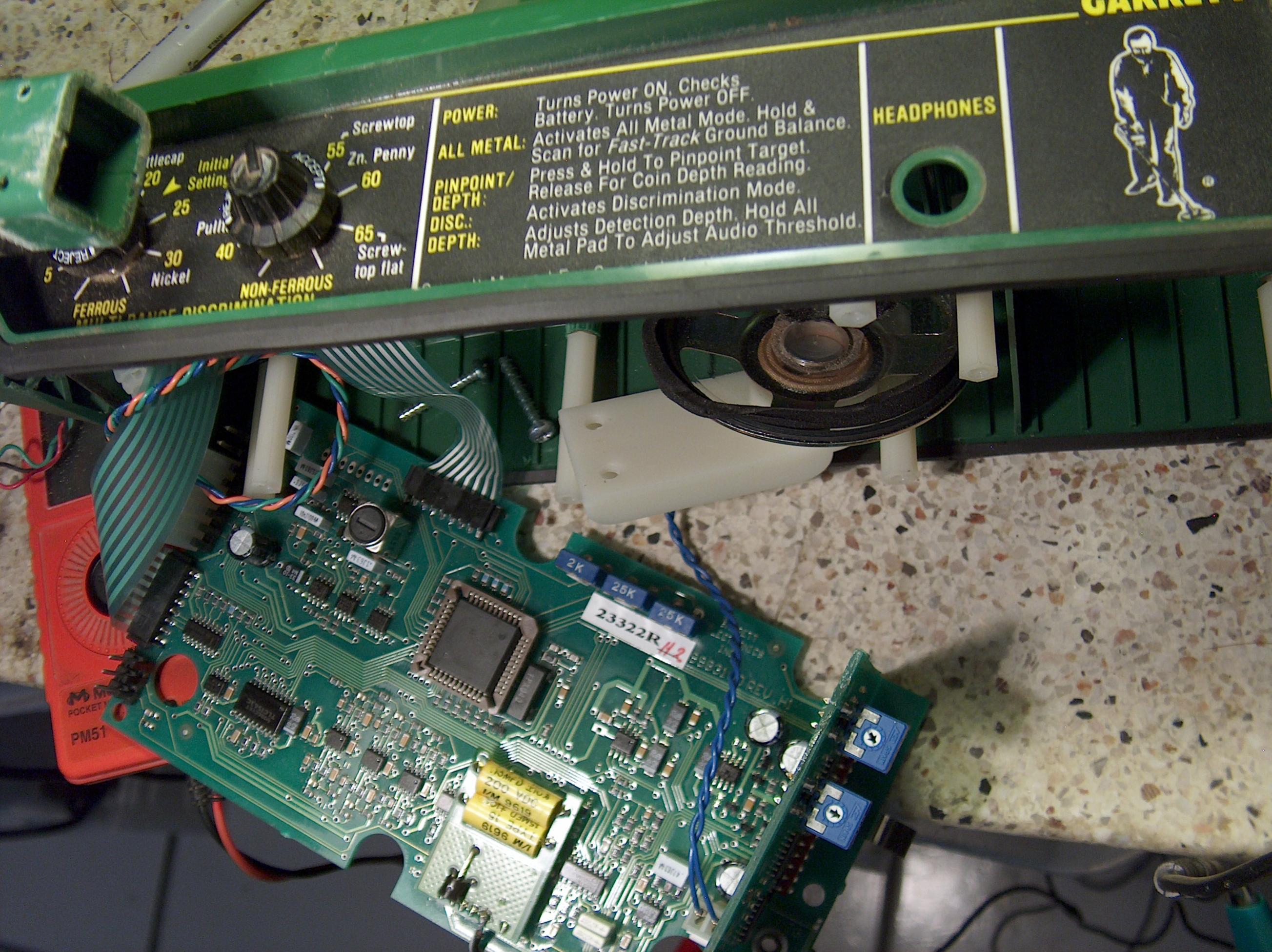

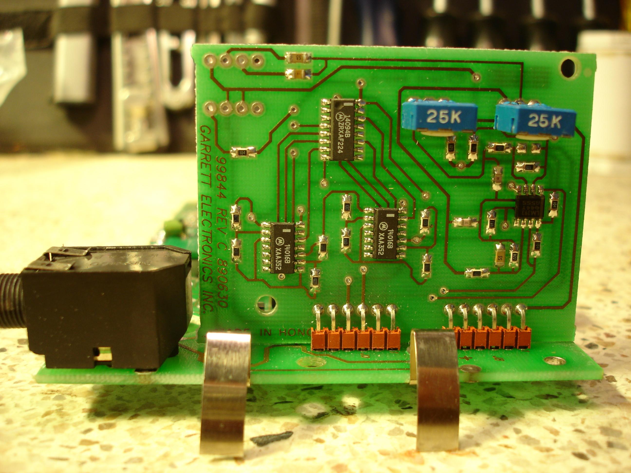

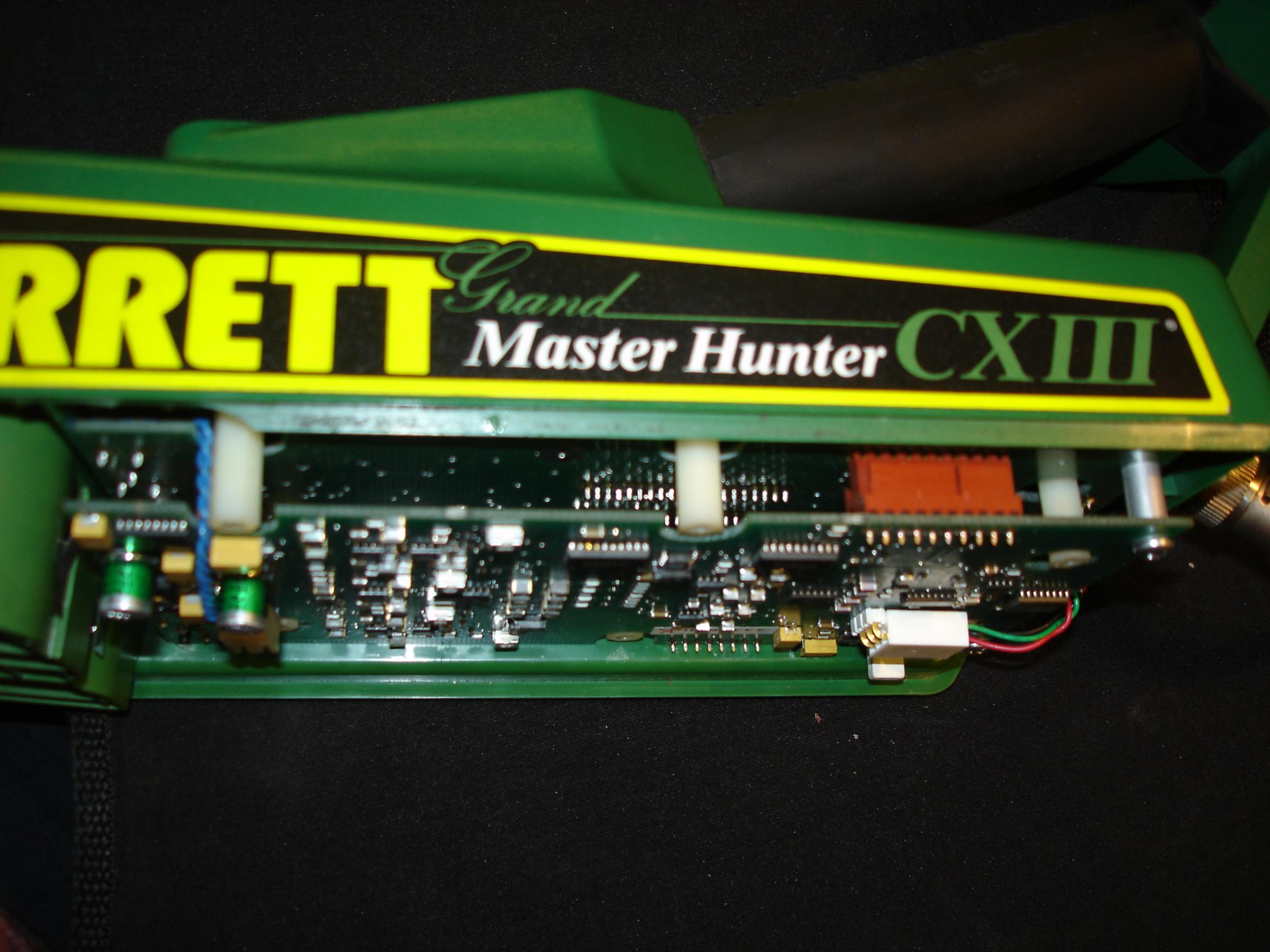

                    on the garrett, as you ask.
ID:	347265Click image for larger version
ID:	347273Click image for larger version
ID:	347272Click image for larger version
ID:	347271Click image for larger version
ID:	347270Click image for larger version
ID:	347269Click image for larger version
ID:	347268Click image for larger version
ID:	347267Click image for larger version
ID:	347266Click image for larger version
                      Thanks kt315

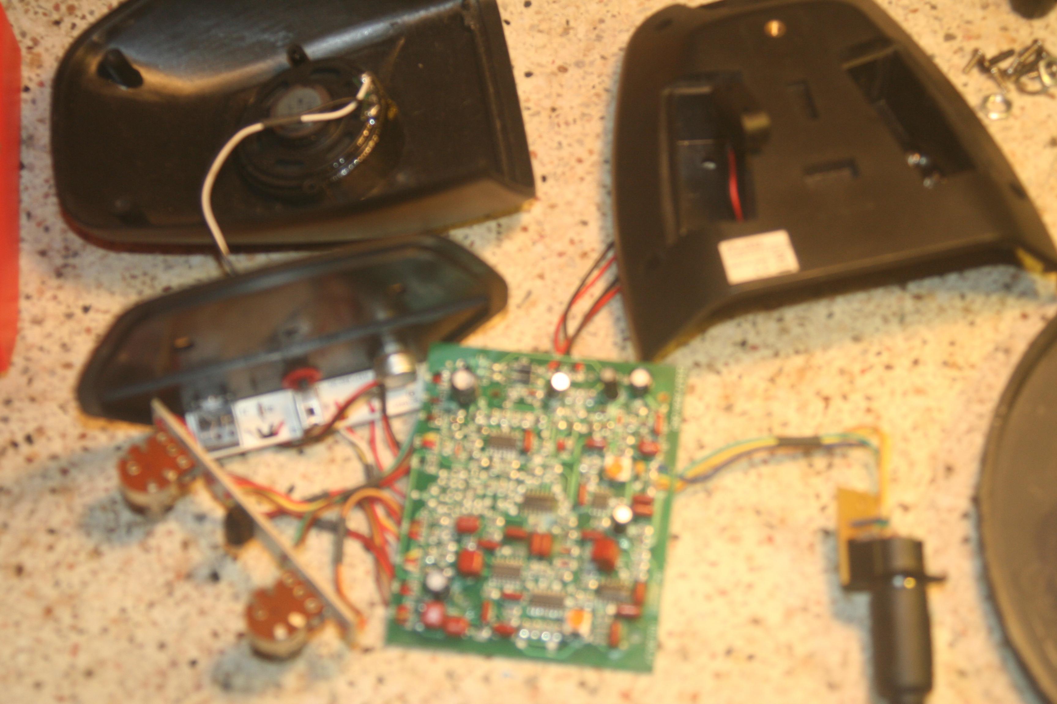

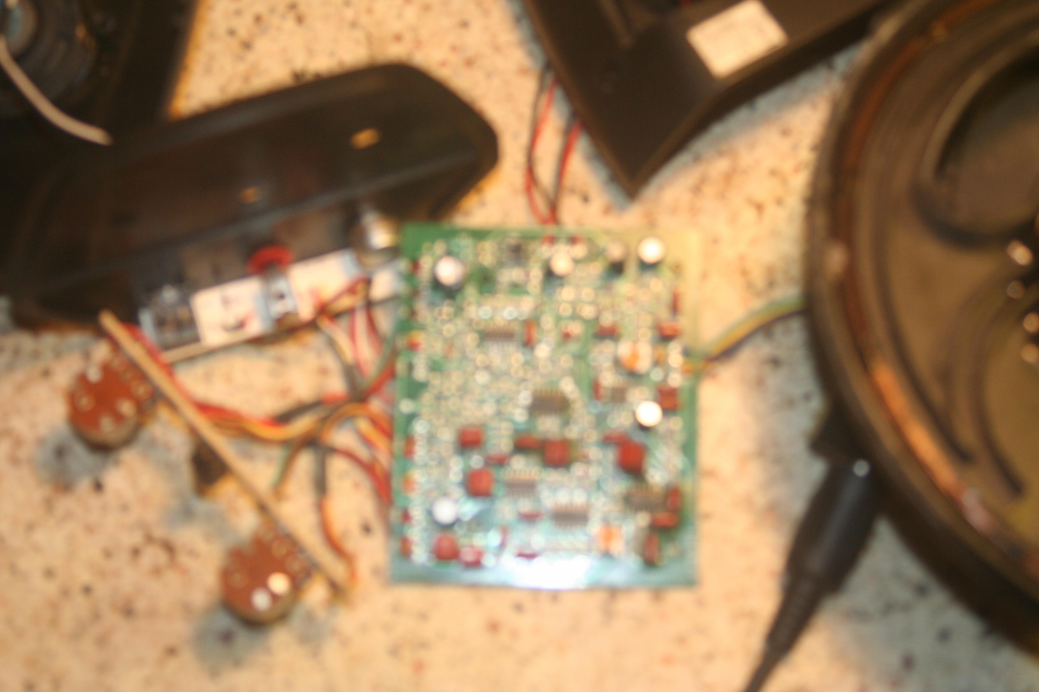

                      Your pics are big help

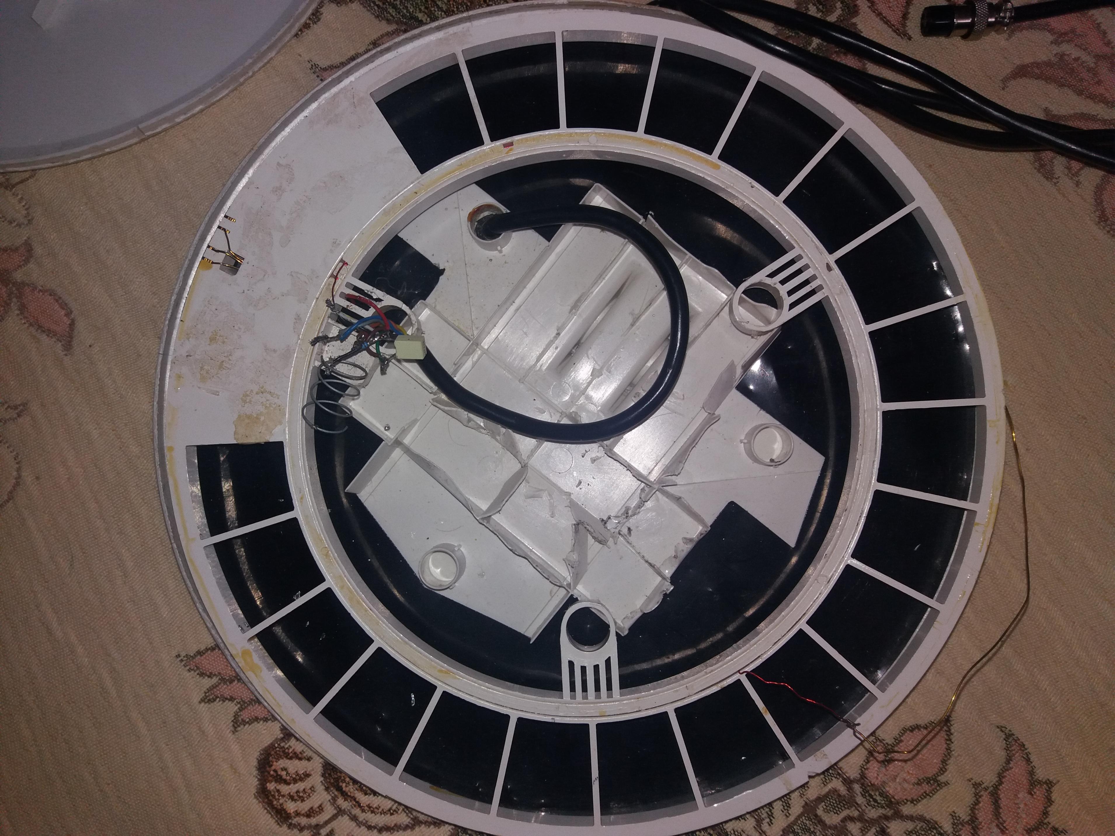

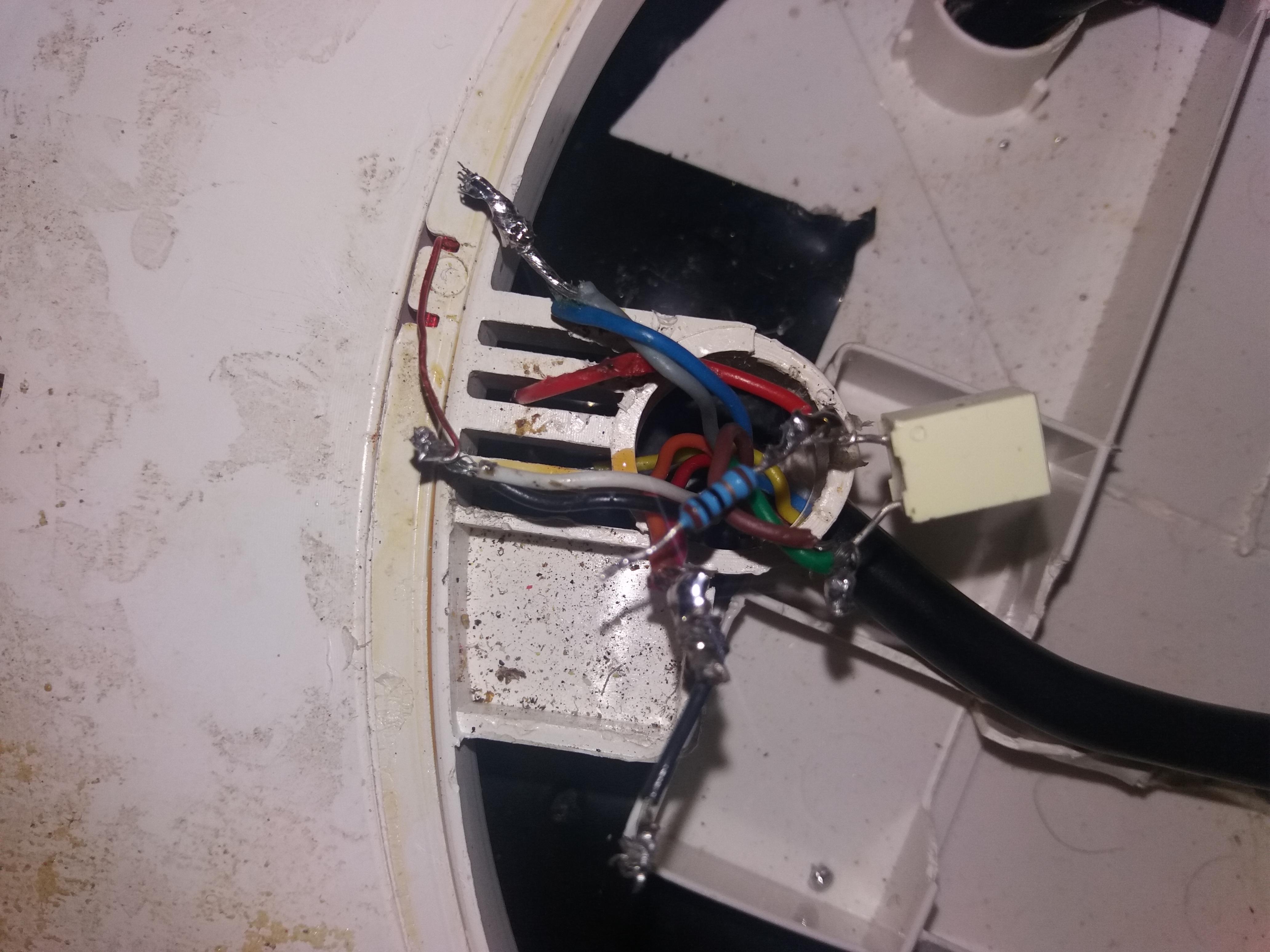

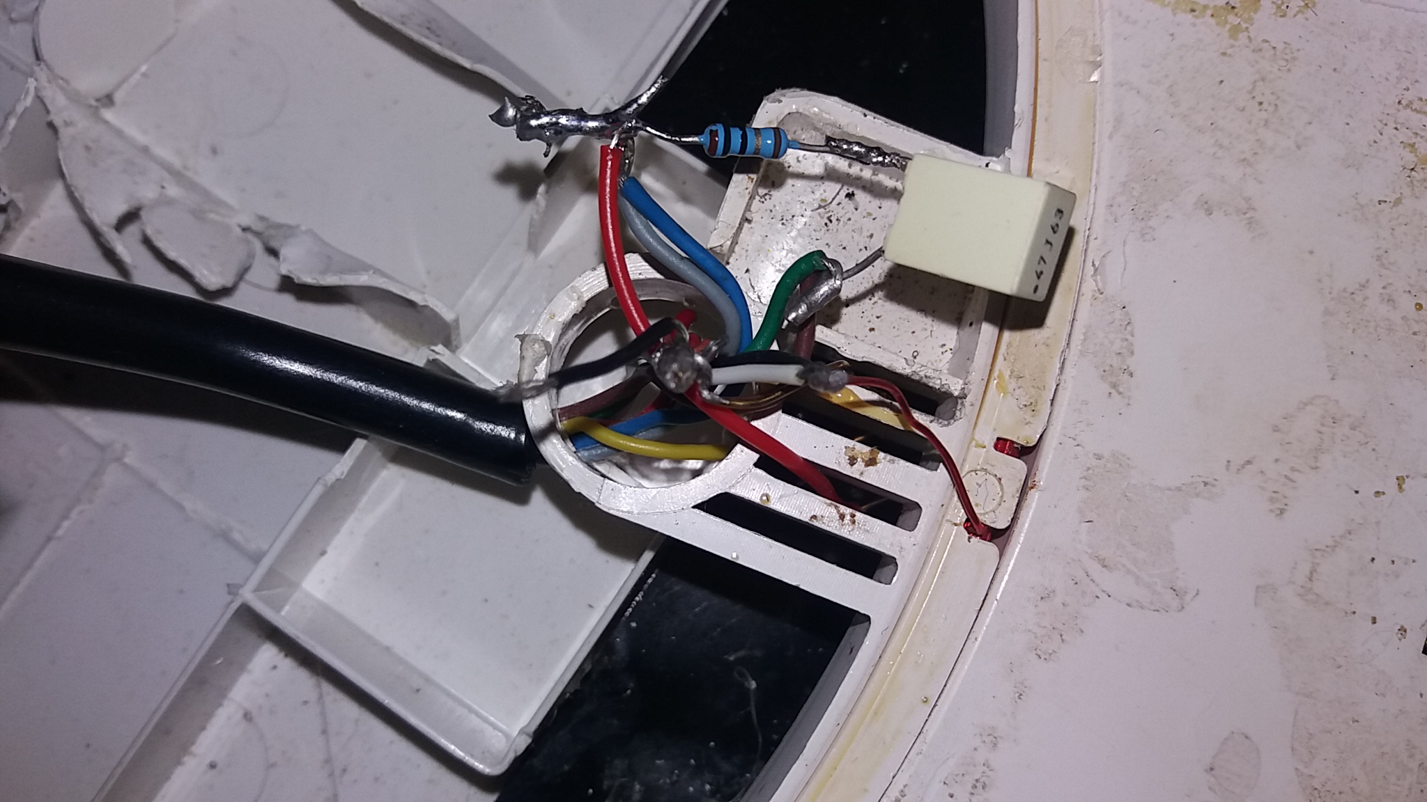

                      Can you have a picture from inside of crossfire 12" coil?
                      I went garrett grand master hunter cxii coil inside connections for repair

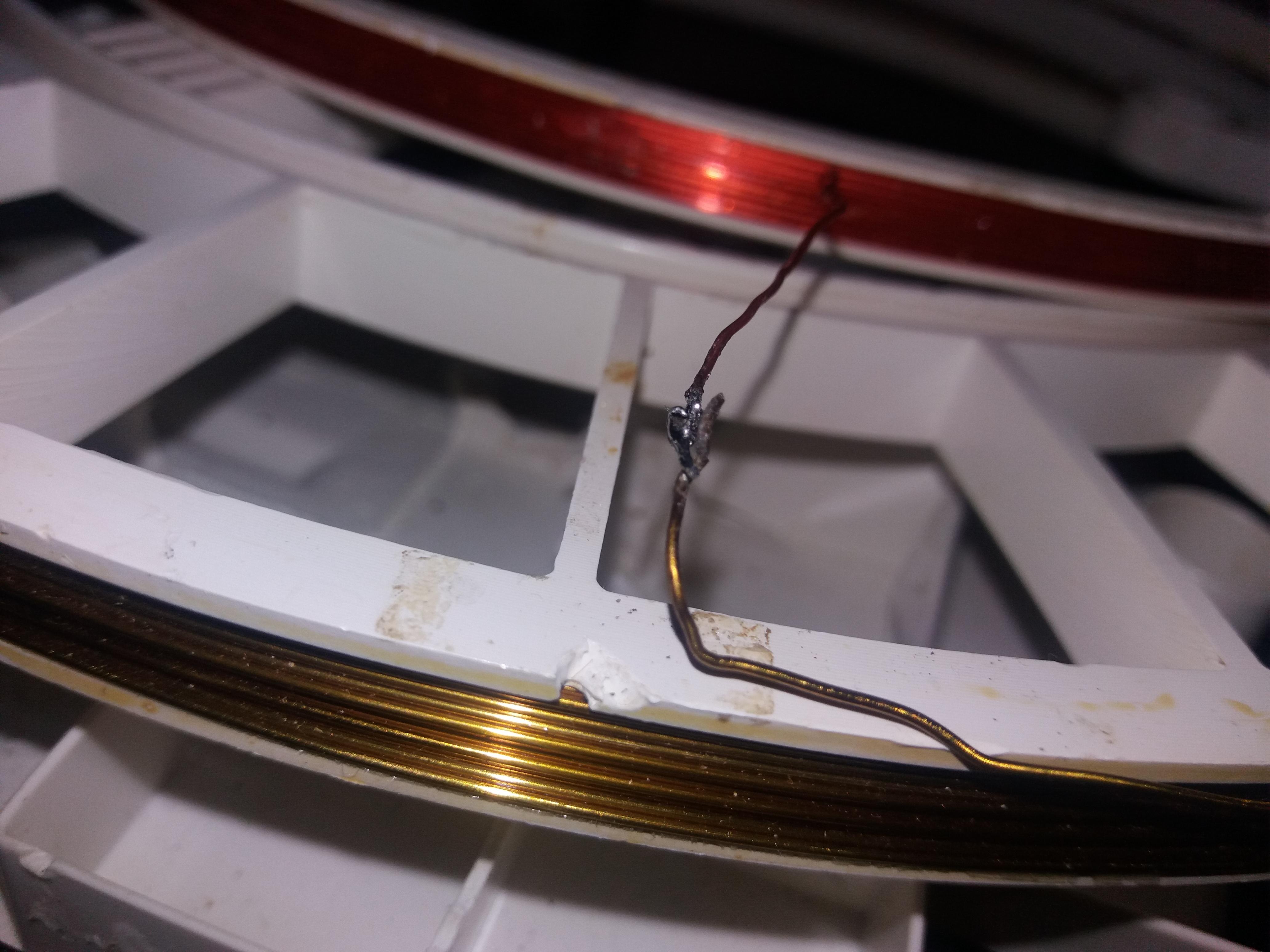

                      This is my broken coil:
                        Thanks kt315

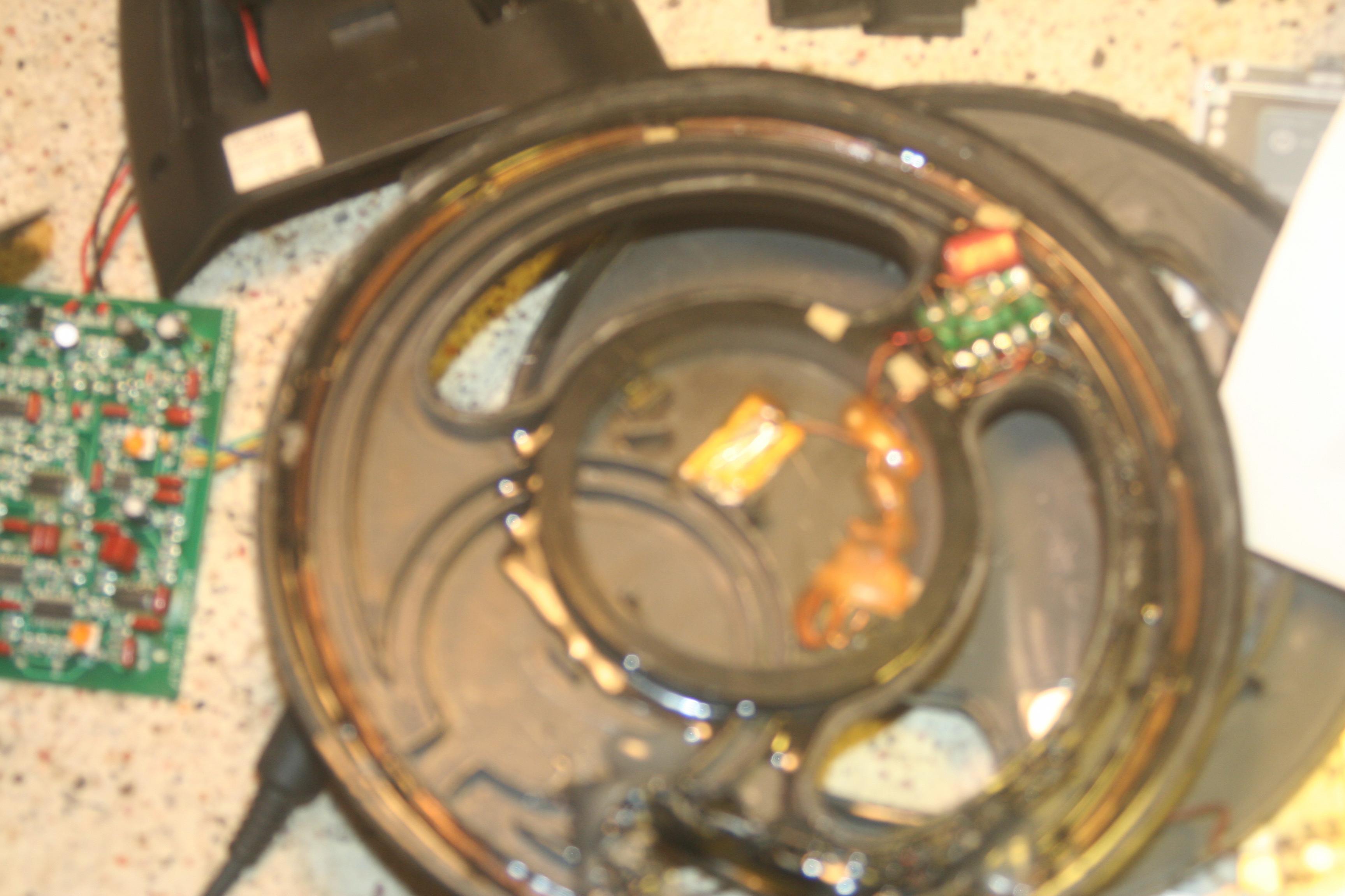

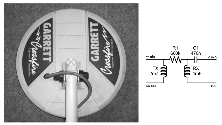

                        You appear to have the usual Garrett Crossfire coil problem. The outer TX wire is made of aluminium and the inner wires are made of copper. The failure always occurs where these two different metals are soldered together. You will need to use special solder for the aluminium wire, and a hot soldering iron.
                        Here are the details for the 8" Crossfire coil, but (as far as I remember) they're the same for the 12" coil.
                          Thanks Qiaozhi
                          In my coil R=10r and C=0.47
                          The wires are 5 : yellow - black & white - gray & blue - orange & red - green & brown
                          Tx (yellow copper) have 3wire and Rx (red copper) have 2 wires
                          Can you tell me how i can connect them in the picture
                          Thanks again
                            Thanks Qiaozhi
                            Thanks again
                            I don't know the answer for your particular coil. But - if you can identify which loops are the TX, RX and nulling; it should be a simple task to work out where the capacitor and resistor are connected.
                              [ATTACH]38121[/ATTACH]
                              thanks for your help
                              in this picture TX start is wite and RX start is black right?
                              what is mean of "screen" in tx?
