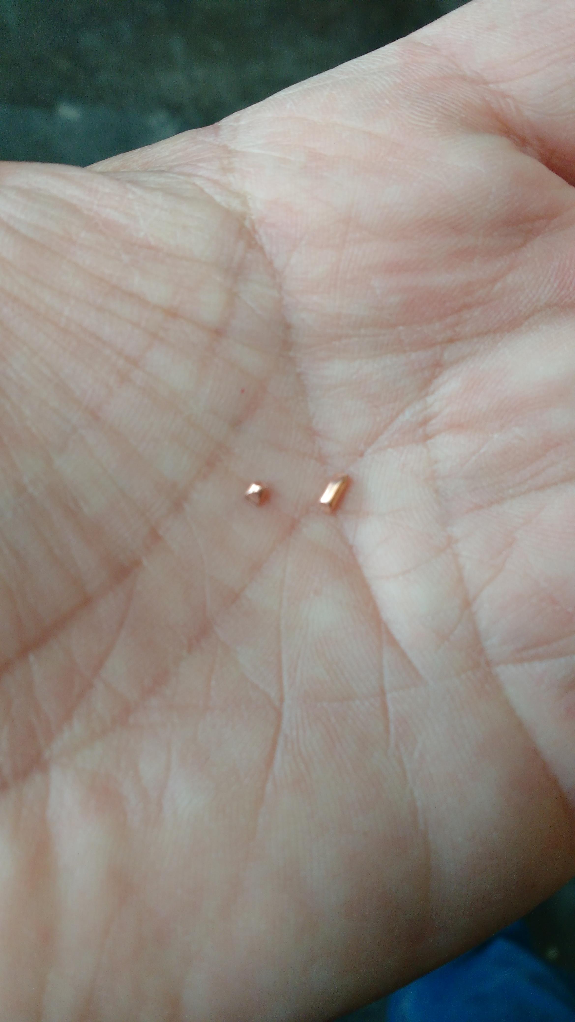

    Hello friends.
    Today i made a simple test, to see wich land mine metal detector performs best with two small pieces of 1.6 mm coper wire.
    Has you may see on the picture, those two wires are very very small. Indeed i tryied to know his weight, but my weighing machine can only read weights lower than just 0.1 grams, so i asume this wires can weight close to 0.3 or 0.5 grams. However you can see how tiny this wires are, compared to my hand.
    Here are the results with standard coils on Vallon and also en Mil-D1:
    Vallon smallest wire small wire
    non detectable 5 cms
    Mil-D1 smallest wire small wire
    3,5 cms 6 cms
    This really surprise me, cause i got Vallon recently and never did this test before. However both machines performs very well.
    Mil-D1 has better pinpoint, because of his bi tonal function that is very nice.
    Finally i will like to know from others, if they have any experience with Mil-D1
    Nelson
      It looks that no one has any information about CEIA Mil-D1 to compare against vallon VMH3CS.
      However, both machine works excellent. CEIA Mil D1, in my test shows better deep for small pieces of wire has i showed on the picture of my previus post. But this machine is havier than Vallon.
      Bealive me friends, comparing both units, CEIA wins compared to Vallon. So if anyone can get from military surplus CEIA, you will see the diference. CEIA also has a bitonal fuction that allows you to get those targets just on the center of the coil. CEIA it also a no movement metal detector.
