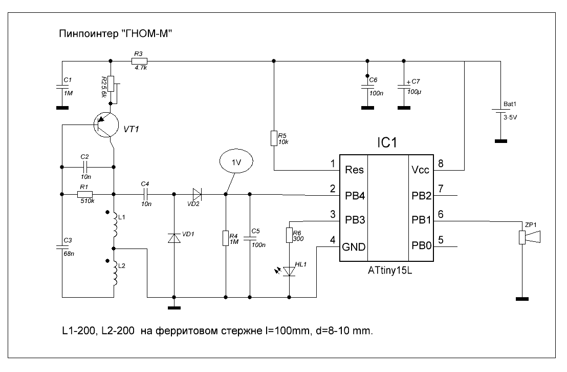

                    Here is simple enough schematic of a pinpointer Gnom-M ("ГНОМ-М")
                    Full info you can see at the author's website:
                    http://www.radiodom.org/index/pinpoi...nom_m_quot/0-8
                      direct link on a PP subforum, in russian, you have to use a babelfish translator.
                      http://www.md4u.ru/viewforum.php?f=1...d0f6894790d876

                          In the russian page it says that "Coils are wound on top of one another and comprise 200 turns of insulated copper wire 0.2-0.3mm wire winded over a 5-10cm long 10mm diameter ferrite core (used in transistor radios)". So two 200turn coils on top of one another? is that right?.
                          I recently ordered 0.4mm wire and I'm going to have about 8 meters of it left when I finish making the search coil for the geotech barracuda, maybe is enough for this project. Could I use 0.4mm wire instead of 0.2-0.3?
                          And then it says "Observe the polarity, so in the absence of the generation (frequency of 15-20khz) need to change any of the ends of the windings" I don't understand that very well.
                          I can get a attiny13 or 25, I understand that I can use either one of them If I flash it with the appropiate file attached at the bottom of the page.
                          I also read the following thing: "Tincture is reduced to the selection of + 1V to the second output of the microcontroller trimmer R2, in the absence of a number of metal objects."
                          I guess what it says there is that I have to measure the second output of the microcontroller while I adjust R2 trimmer until it measures +1V, if so, could anyone indicate me where the "second output" of the microcontroller on a attiny13 is?
                          Thanks, I think I'm going to build this one, it looks like it's easy to build except for that few questions that I have. I have plenty of time so I will put effort on this and I'll read that russian translated forum to get more information.
