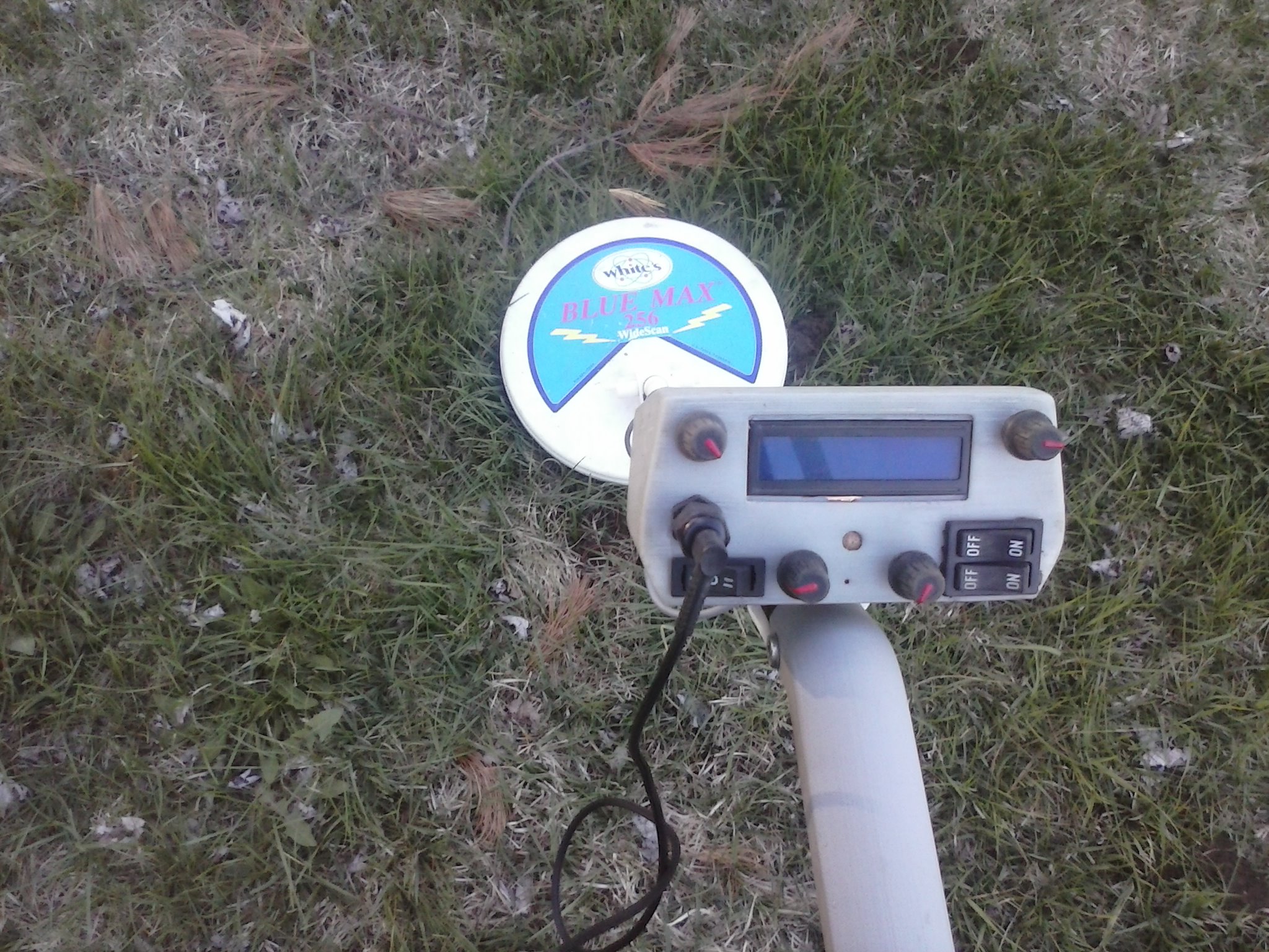

                  • i have two years of using the 6b coil that says they work really well hahaha, I did have to remove 2k2 resistor and jumper it, which if i'm not mistaken, you were the one that had suggested it, which worked like a charm as i never had a problem ground balancing any of the coils including the 6b and the F coil, don's coil works really well however, it was always more noisy in parks where there was a lot of wifi around unlike the whites coils, that were always dead silent even at almost full sensitivity on the pot setting, like i said everything just worked and worked great till it didn't. i just finished taking all the connectors on the board of and re made all new connection hopping maybe some where there was a little fault. Silverdog was kind enough to send me a board, if it still doesn't work, i will simply repopulate a new board and give that a try. I don't know if it helps but, before nickels would not get detected about halfway on the 10K pot, now its more like 3/4 of of the way before they get discriminated out, I am thinking somewhere on the board there is probably a resistor or two that failed but pulling every single one out to test it out of circuit does not seem like a fun time.
Name:	2019 total coins.jpg
ID:	359022 i never ended up getting the vid finished and working lol
