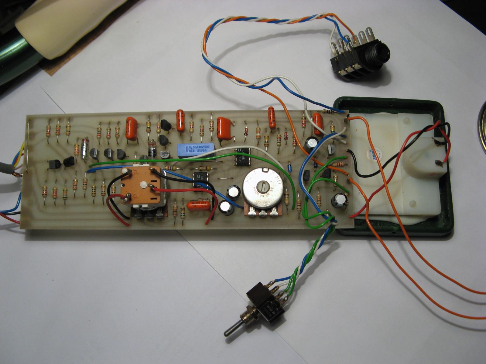

    Hello!
    I own an older metal detector ARGUS MD 222 A, for which the previous owner said that there is a problem if it works for a long time to start the sound signal.
    That still have not checked, because I wanted to thoroughly cleaned before the first use.
    The device has a front measuring instrument, two buttons (on / strength and discrimination), and from below has a single pressure switch in two positions, which can be activated with the thumb - on the switch does not say anything.
    PCB is spacious and has two opamp, only 4 of the electrolyte, a couple of capacitors, and about ten transistors.
    The coil has a 4 wire.
    I encountered another problem, which is that the unit operates on two 9V batteries, therefore, -9V-0- + 9V, and certainly I would like to To deal with this, say the same solution as in SurfPI negative voltage. If I put 8x1.2V AA batteries, can thus get -9V to output?
    I would ask your expert advice and if anyone has any information, schematics, manual, etc, about the unit would ask him to put them here. Thank you!

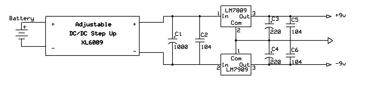

    Without it's power supply schematic it would be tough to design most suitable power supply and replace present state with two 9v batteries.
    But... from rich previous experiences it is to expect pretty common circuitry in there.
    I don't think that 9v per rail is a must. Most probably the circuitry works on somewhat smaller voltages.
    Also i assume the circuitry will be pretty much tolerant on somewhat smaller voltages, even if there is not some voltage regulating circuitry already involved.
    Knowing this it becomes easier to deal with it. A symmetrical bench power supply would help a lot to test the circuitry and define most proper supply regime.
    But also there are many ways to achieve symmetrical power supply from one single voltage source.
    Metal detectors, especially older models (especially solid state), are pretty tolerant. I assume those two opamps are also from older series and can work in wider voltage range too.
    There should be no harm if you try any of the existing simple solutions.
    What i would do... i would obtain very affordable and easy obtainable dc/dc step up converter module based on XL 6009:
    http://www.banggood.com/XL6009-Step-...-p-916222.html
    and make it something like this:
    At least to try the circuitry and test the voltage ranges.
    XL6009 module is adjustable and you can use wide variety of batteries on it's input, than adjust the output voltage to desired levels.
    I put there 7809/7909 voltage regulators but you can try the circuitry with 7808/7908 as well.
    XL6009 should be adjusted to provide at least 20-24 volts at the output. One single 12v battery will do.
    But that's in case the detector really needs a 2x9v supply, which i highly suspect.
    If you inspect it's circuitry; you'll probably find out that it is operated by lower voltages. That will make your job even easier and at the end you will be able to use even smaller battery voltage at the XL6009 input.
    There are other solutions as well, apart from mentioned XL6009.
    But in any case you must "generate" voltage high enough to be able later to "divide" it on two equal halves needed here.
    Many methods to do that.
    Most critical part here is not how to properly divide the voltage but how properly to "generate" higher voltage from lower one.
    Most common method to make symmetrical power supply from single source:
    http://www.eeweb.com/blog/circuit_pr...etrical-output

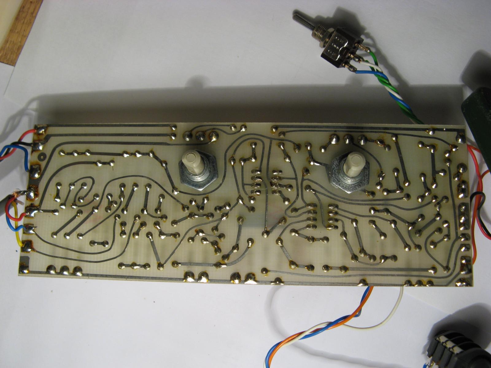

              Try to take high-res photos of both pcb sides.
              We can try to trace out the schematic from those photos.

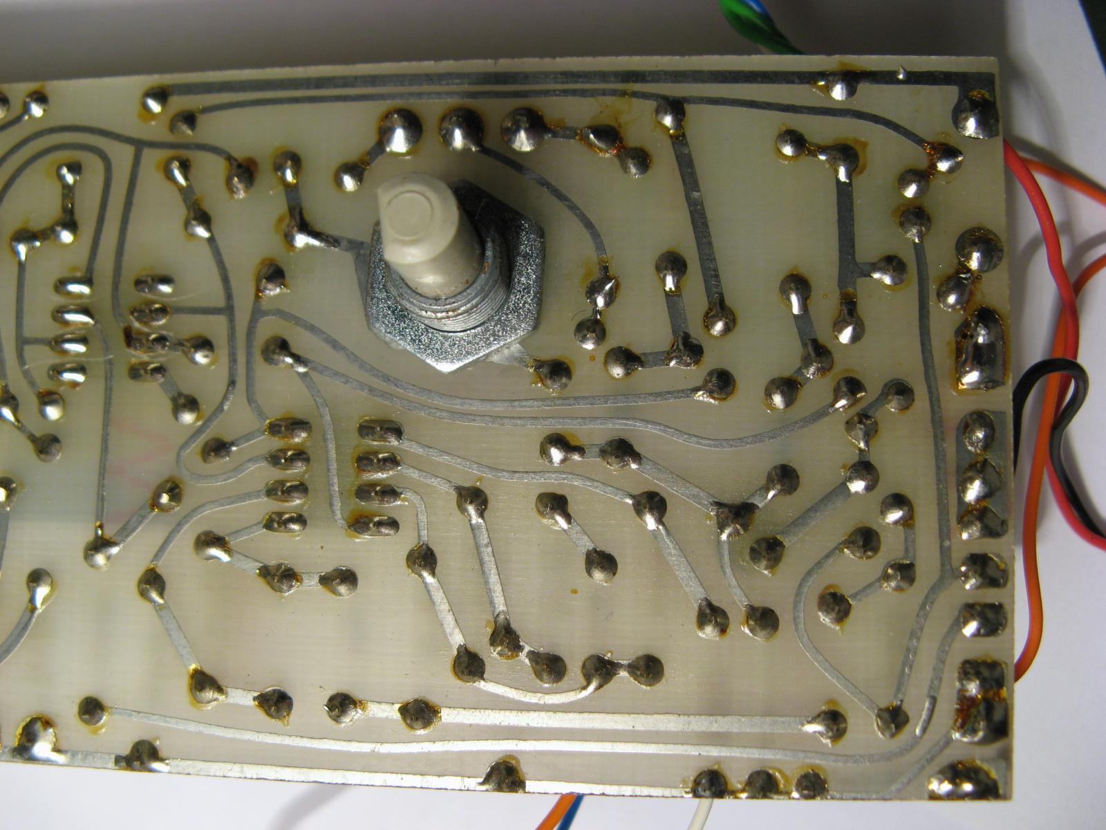

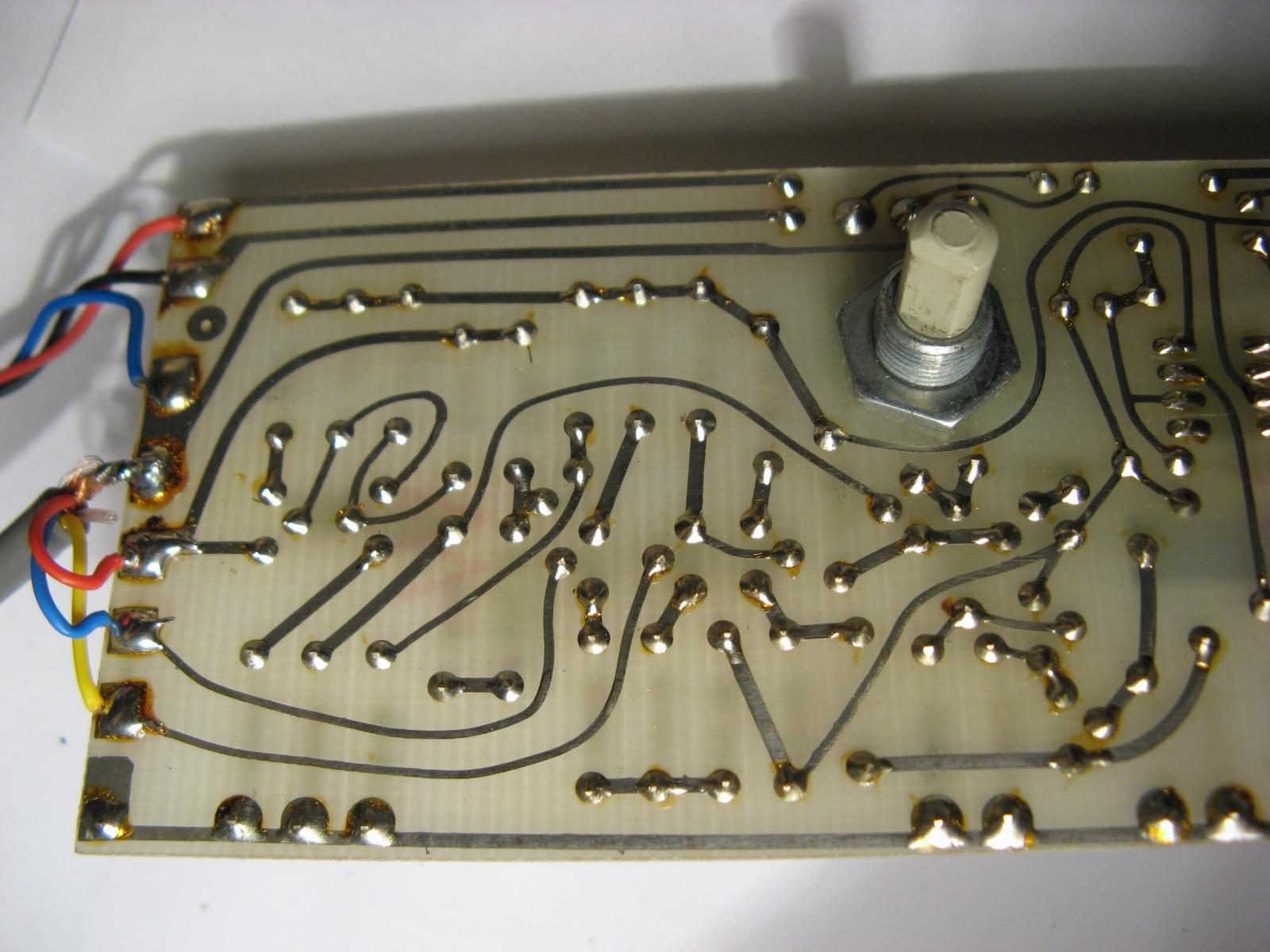

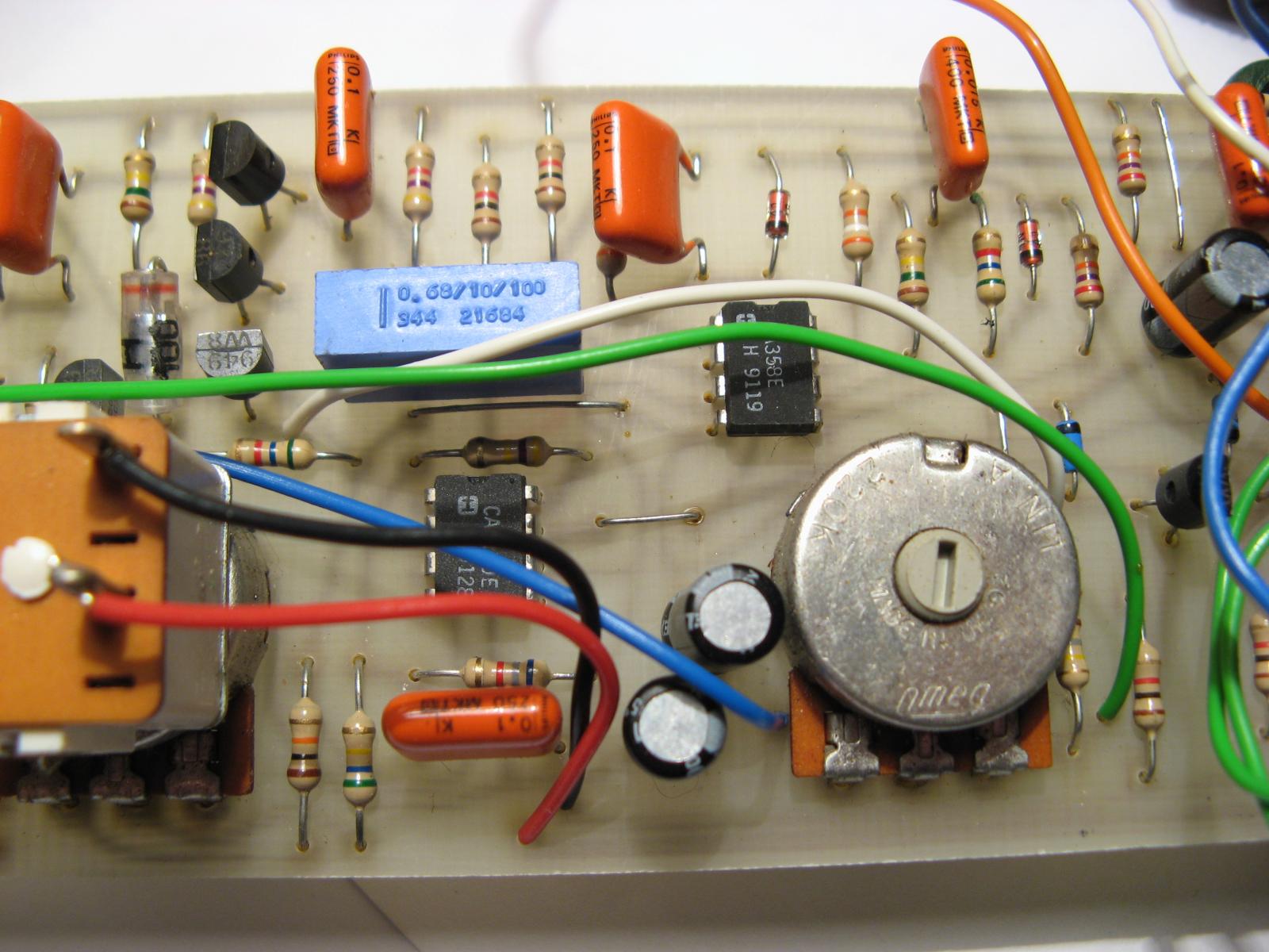

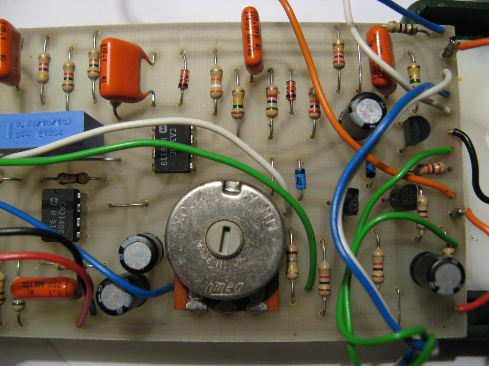

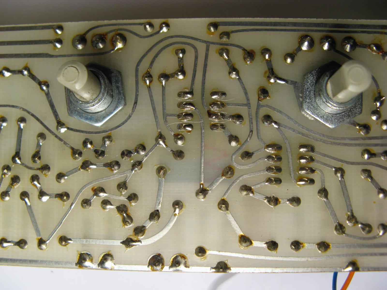

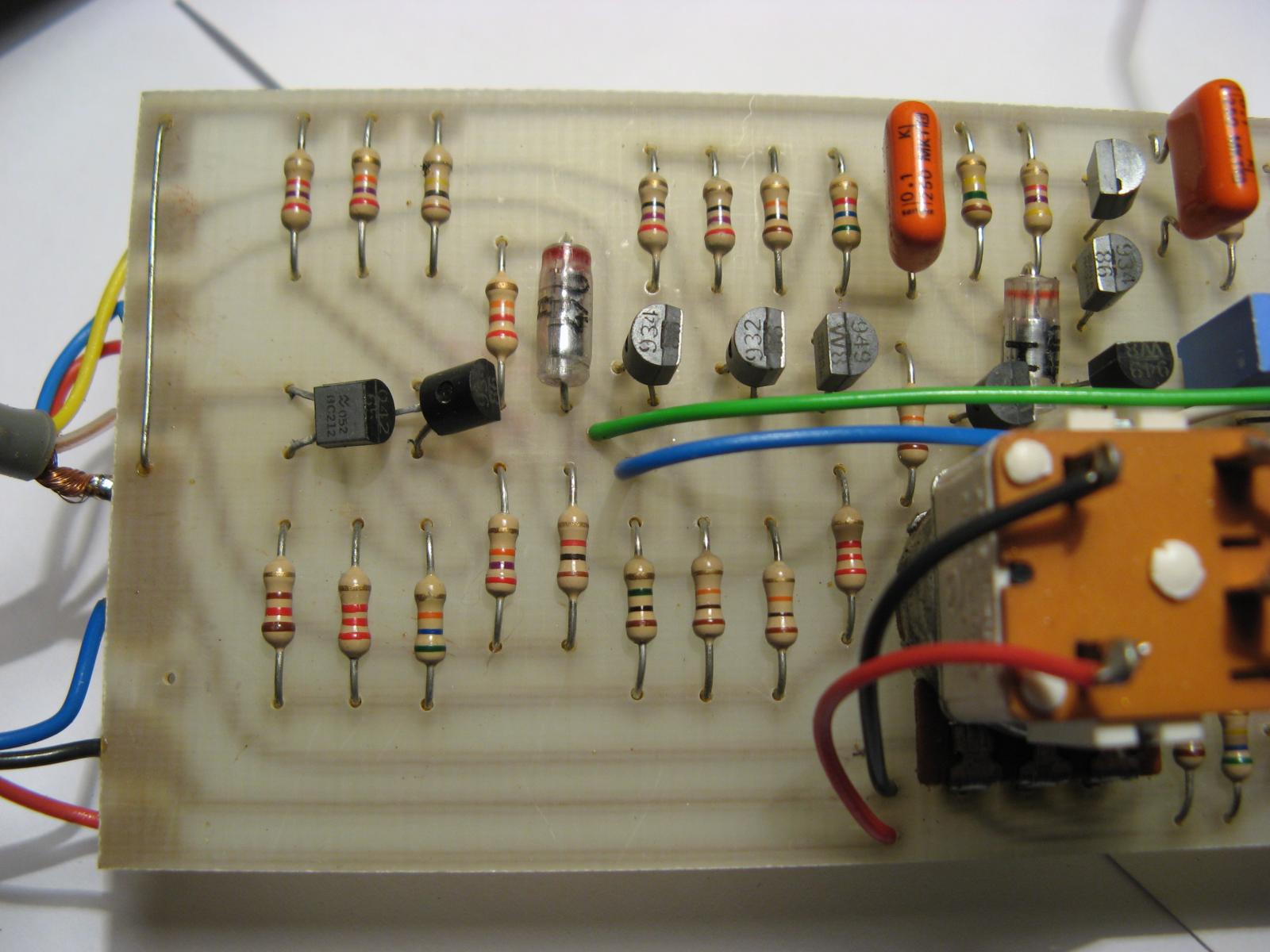

                          PCB foto off both side in atachment
                          If need extra position or value, talk.
                          Battery blue wire is 0V, red +9V black -9V
                          Diode red is 4148, blue is 5V6 zener
                          I see that I must cleen up PCB from soldering.
                          IC is CA3140E and CA358E
                          CA3140E gets scratch with sharp objects in pins... seems to me like standard production?
                          Switch is two side push, green-green, and blue-white
                          All electrolite 100uF/16V
                          Transistor are all kind: BC212, BC308, MPSA12, BC238 and C9106

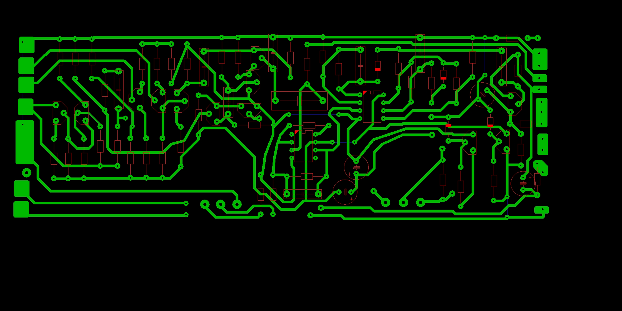

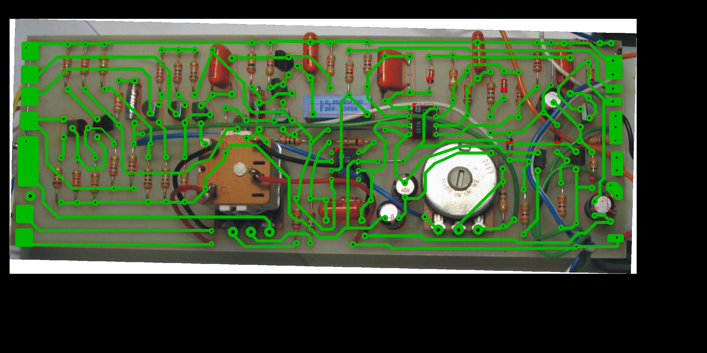

                              I did it "on the fly" just for fun.
                              But... photos are not taken good, under the straight angle, so most probably there are mistakes in my draw.
                              Let's make this a team work (not that i am lazy, but i have lot of responsibilities in next period) and anyone interested may continue where i stopped...
                              Yes once we get 100% accurate pcb trace; i will pull out the schematic and later it will be piece of cake to draw new half sized pcb (even smaller, so as i see it).
