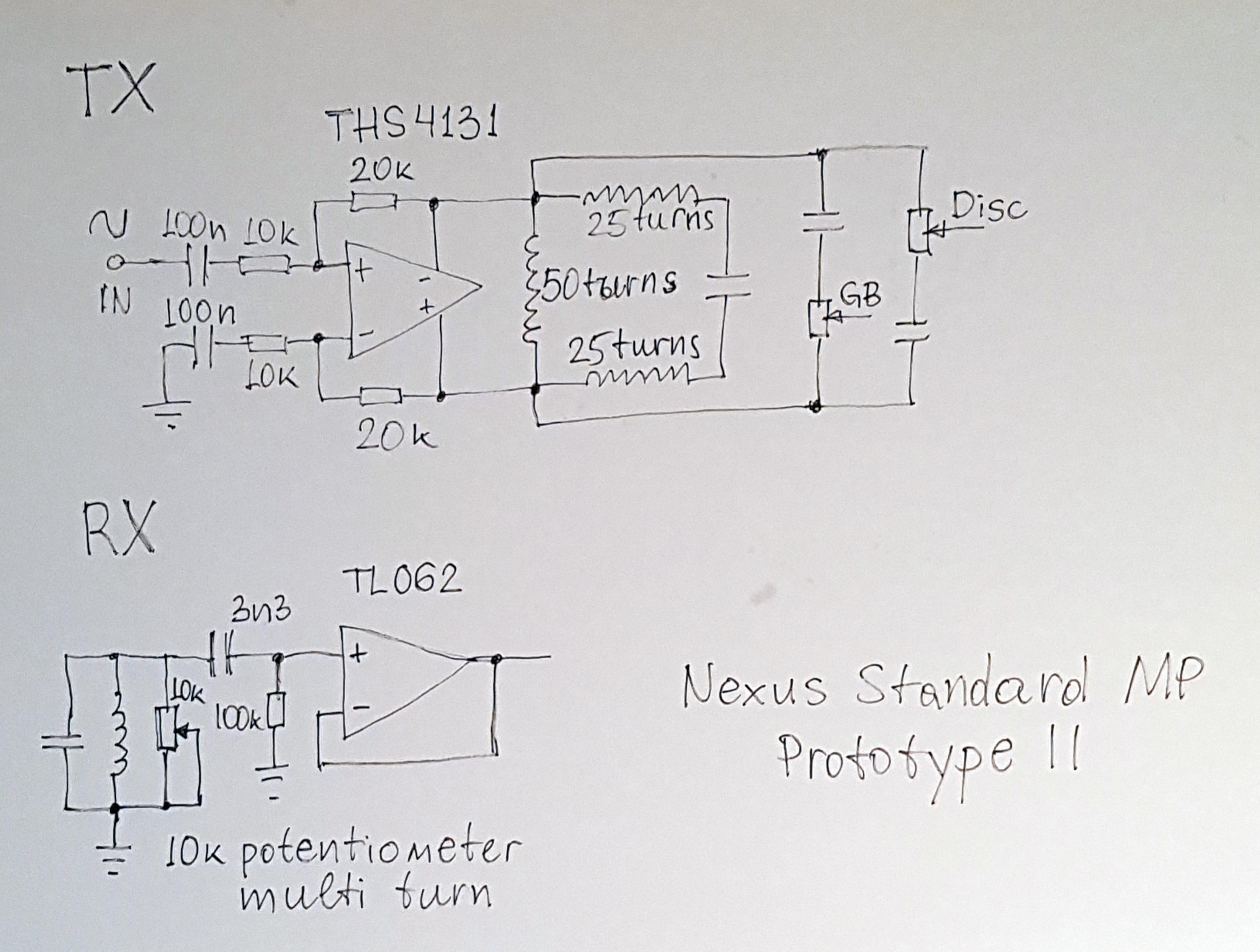

          Here we go.
          The attached picture is showing all you need to know to make just about any IB detector work in the worse mineral conditions. For work on very strong black sand the value of the parallel potentiometer to the RX will have to get down to 5 Ohms or even less. This will allow getting coins no deeper than 2.5", but non of the existing IB detectors (except MP) can even work in such cases. For milder mineral conditions the potentiometer value will be higher resulting in higher sensitivity of the whole system.
          If the parallel RX potentiometer is above 1k value this will allow the resonance of the search coil to add to the over all sensitivity.
          To have the TX and RX in full resonance ideally both loops should be with the same inductance and coupled with the same capacitors. This is the easiest way to go about it. Different TX and RX will require different capacitor values to achieve full resonance if it is needed.
          TX and RX can be just about any value, but to prevent the differential amplifier from drawing too much current TX is advisable to be with few Ohms active resistance and probably above 5mH inductance.
          The THS4131 is a fully differential amplifier that will prevent any amplitude change what so ever making this transmitter probably the most stable TX amongst all IB schematics. In the case with MP_II prototype the power supply for the THS4131 is 20 Volts, which results in 38 Volts between the two differential outputs and then multiplied by 2 from the coil sections = 76 Volts p-p.
          The TX coil does not have to be made with amplifying sections. I just did it this way as I prefer higher Voltage swing for my TX designs.
          The TX coil have to be completely tuned in resonance to the source oscillator to minimize the current drain of the differential amplifier and also prevent over heating caused by output distortions.
          This design solution works excellent on highly mineralized grounds. In fact it works way beyond what CTX3030 and other sophisticated digital detectors can even come close to. However it is an approach that will not allow very high sensitivity for super depth on normal conditions, because of relatively high noise level. At least my prototype was noisy beyond my requirements for Nexus noise figures. Other wise of you do not find the noise disturbing you will be kicking a lot of claims down the drain with this.
          For IB detector to work properly on highly mineralized ground there is one condition that is important above all.
          Either the transmitter have to be very stable or the receiver, but never both of them. Since getting a super stable receiver is near impossible this condition will fall on the transmitter naturally.
          The production MP circuit uses a different approach with a free resonant transmitter, which is the same as in all other Nexus detectors, together with an input circuit that deals with the mineral conditions in a different way.

                  Interesting circuit design, Georgi, thanks for posting this.
                  I was wondering why the TX coil is drawn as 50T and two 25T. If I were making such a coil myself, I would be inclined to wind 50T + 50T in bifilar fashion. How did you actually wind it, as 4 x 25T quadrifilar, then link them up as shown on the circuit?
                        I just used a bifilar coil (4 x 25 turns) manufactured for one of my resonant detectors. This TX can be made with any configuration.

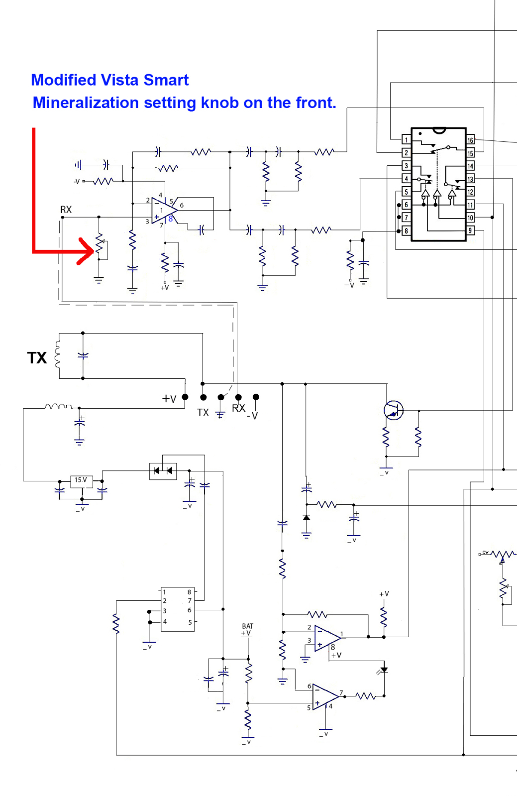

                          Originally posted by Nexus View Post
                          .......................... but non of the existing IB detectors (except MP) can even work in such cases. For milder mineral conditions the potentiometer value will be higher resulting in higher sensitivity of the whole system.
                          Unfortunately, this is not correct.
                          As you can see you're not the only one with the same ideas.
                          This is a part of the front end of the modified Vista Smart and can function very well with Black Sand.
                              You are not paying attention.
                              The parallel resistive load over RX loop in IB detectors was invented by Bruce Candy over 20 years ago. So I have no claim here.
                              My second prototype design idea was not based on just the use of extreme RX resistive load as low as 1.5 Ohms, but also on original TX circuit solution that is far more significant than the resistive load alone and I know for a fact that my TX circuit solution is not present in any IB detector design.
                              However the production MP design that I sell now is by at least 40% more capable in pure magnetite than my 2 prototype made with resistive load over the RX.
                              Pure magnetite, not just any black sand. Try your modified detector on that and let us know how is doing.
