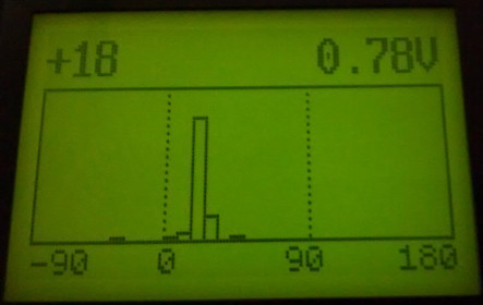

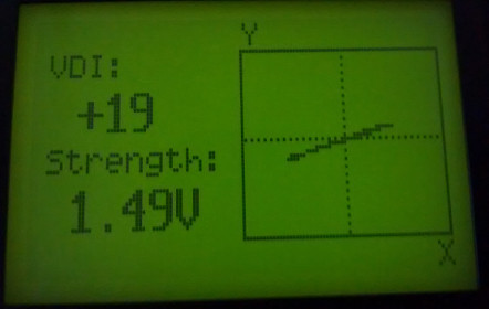

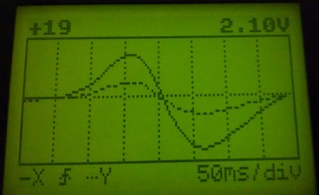

  • this is a port of the vdi to a KS0108 based GLCD display for testing, it can be configured in three different modes:
    - XY correlation,
    - histogram view
    - or like a small "oscilloscope"
    different patterns in XY correlations might give you additional information about the target, e.g. some hints about its shape, the histogram view can be used for a better vdi "average" and the scope view is more just for debugging

          on the scope you can see that something is cutting off negative indications
          • ok I see what you meant, very nice videos, a possibility would be to auto-scale X and Y axis. I also saw a bug in the histogram view, sometimes it goes out of scale but it can be easily fixed. IMO the signal Y flattens in the scope view because the MPC602 is in saturation, so it cannot be done much, however it saturates quicker than channel X, it would be good to cross check this with a real oscilloscope...
            • and concerning the oscillator frequency a solution might be to reduce the latency of the GLCD somehow, e.g. minimizing the reads/writes to the GLCD...
              • I added the axis scaling in XY and scope views for testing: 1x (same as previous version), 2x, 4x and auto (this can scale the signal up to 16x). This version should also fix the values out of bounds in the histogram view, although it is still missing to reduce the display latency...

                  this version fixes a small bug with the axis auto-scaling related to the flatting of channel Y reported by kroman01, better to use this one for testing instead of previous one...

                      • ok very good, very nice videos, your XY offset should match the values shown in the screen when there is no target near the coil and then you might decrease the level to 10mV for better sensitivity, something similar to the battery that should be calibrated with a measurement of the battery voltage. I see that the out-of-bound values were not fixed correctly in previous version, could you check test4? this version also sets the histogram range according to the selected vdi interval and slightly decrease the display latency...

                            • I threw the test4 and it works, the histogram is set to -90/90, as I wanted, I have a night in Poland, tomorrow I will do field tests and films, 12 hours wait
