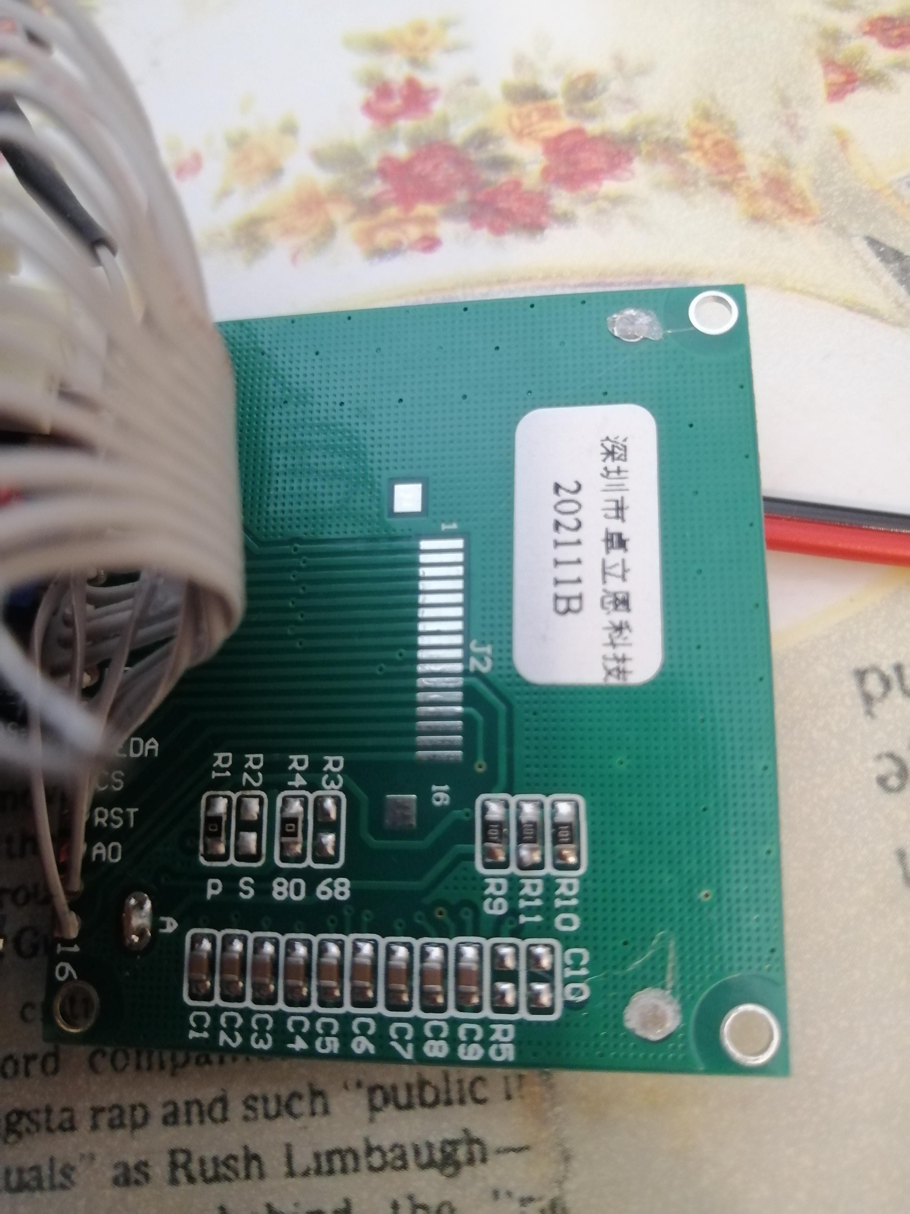

  • I don't now how to do that. I just programed pic18f26k22 with pickit2 and get message Successfully programmed.
    But displey is empty and back light not power. On display I have 5v on VDD and on pin 20 on pic.
    • I looked through the source code and found this..
      #define GLCD_SET_CONTRAST 0x81
      The contrast has a range of 0-63 Dec or 5bits the upper 3 bits are ignored. With 0X81 the lcd is set to 1 the 8 is ignored. I use between 10 - 20 dec try changing it to 0X18. It was probably a typo and got inverted.

      • Yes jumper R1-paralel port is connect and R4-80 is connect. This is zolen displey with 16 pins
        • I have problem to creating hex file from C sorce in my mplab. I can only load hex file in pic with pic kit2 programmer. Can you please send me hex file for pic 18f26k22 with correction kontrast.

              • I read every post from this forum and that is why I chose to order a zolen display with the st7565 controller because it is supported. The only problem is that this is a 16-pin version but I connected according to the template from post 442 #, side 18 and I think that's ok. Probably my problem is cotrasst adjusment. Thank you so much Altra for your help.
                • Originally posted by zmaj od nocaja View Post
                  Hi Waltr I have a problem with my VDI module. I connected the Zolen display to the PCB as follows: 1-8 on data port, RD-RA5, WR-RC4, D / I-RC5, REST-RC6, CS-RC7, VDD- + 5V, VSS-GND, A + on the pcb A+. But the display remains black. The hex code is loaded correctly ВДИ_СТ7567_П18Ф26К22_РР40. Am I wrong somewhere?
                  Please post a link to data sheet of the EXACT display you are using.
                  LCD displays need contrast adjusted else they look blank.
                  Recheck the wiring again. Also read about contrast adjust on that display.
                  • https://www.ebay.com/itm/12864-128X6...-127632-2357-0
                    This is my zolen display from ebay.
                    I use pcb v2.2 with mcp604
                    • I reviewed my st7565 driver and I was WRONG about the #define GLCD_SET_CONTRAST 0x81. The 0X81 is the address pointer to the contrast control, this command is sent first then you send the data O-63 to set the contrast. The Chinese call the contrast "electronic volume". I don't use this compiler so I can't view or change it for you.
                      • Finally I found a problem and my VDI working great with zolen display. Problem was bad reset button, remaining on all time. Thank you a lot :-)
                          Ahhh...something simple and stupid...
                          Great nothing was wrong with display connections or code.
