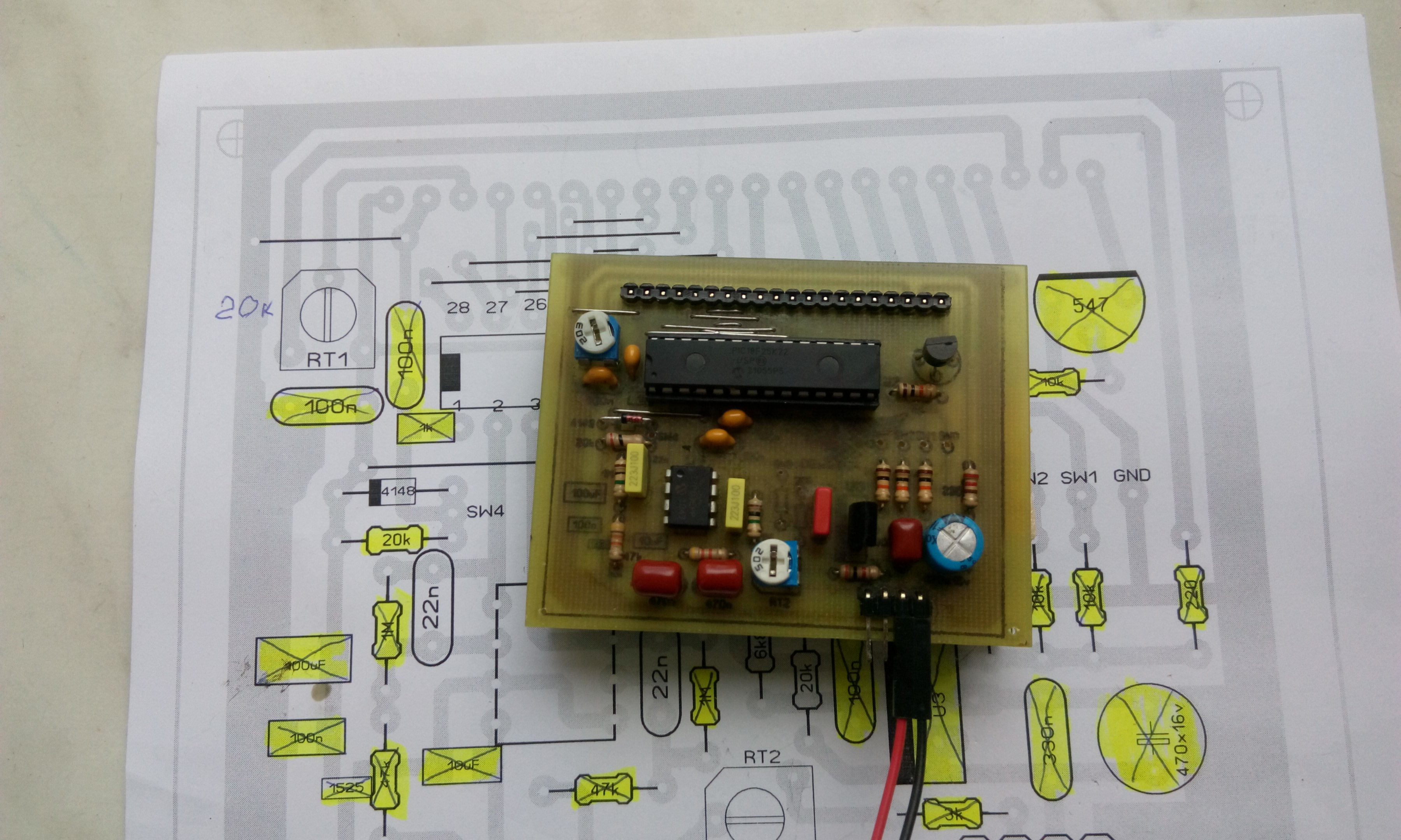

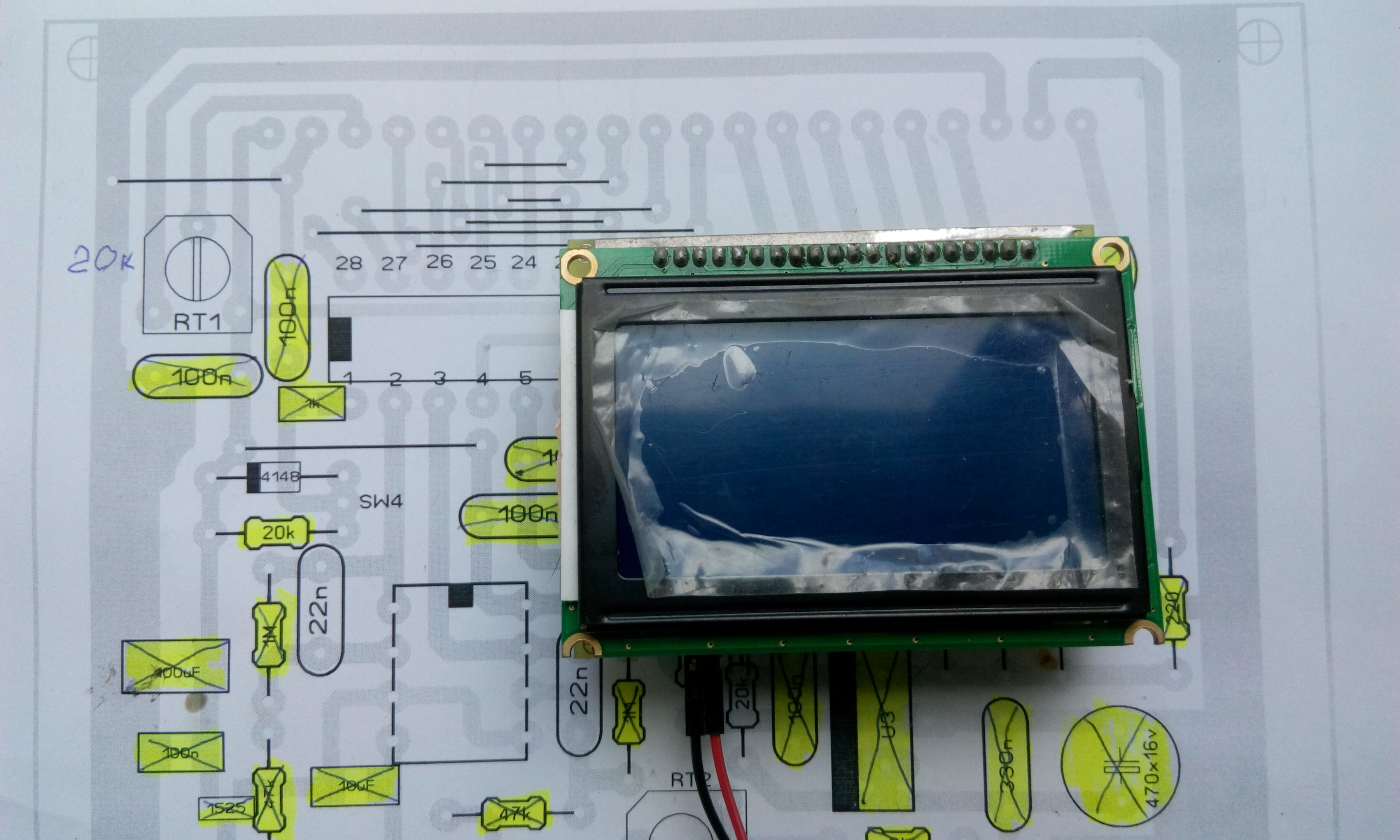

  • Hello! I finally got this set up. I flashed the controller, inserted it into the socket, applied power and ... and nothing. The display shows nothing. The contrast is adjustable, but there is no indication. The display is serviceable --- stood on the Turkish VDI DM-1. It seems that PIC18F25K22 does not start. All voltages are present, the parts are in good condition, the installation has been checked several times. Where else to look, I have no idea. The archive contains the firmware that was flashed, a diagram, a printed circuit board drawing and screenshots from PicKit3. Thanks!
    • Did you check with an O'scope PIC output pins to display and see if they toggled when powering the PIC?
      Did you adjust the display Contrast?
      Looks like the jumper wires above the PIC may be SHORTED. Ensure they are NOT touching (should have had insulated wire for the long ones).
      The code should be using the Internal PIC Oscillator. This is set in the 'CONFIG1H' bits.

      • I checked the jumpers first of all --- there are no short circuits, all tracks were viewed under a magnifying glass and rang by a tester. Everything is great. The contacts in the PIC socket are also good. And, here's where to look with an oscilloscope (on which pins) and what should I see there? For example, on pins OSC1 and OSC2 should there be an internal oscillator frequency (4MHz, sort of) or not?
        • With the Internal oscillator there is not a clock on the pins (9&10). See figure 2-1 in the PIC data sheet.
          Only pins I would check are the PIC pins to the Display.
          These should output commands and data to the display upon power up or RESET (SW1).
          Check the Display pins, EN, RS, RW, CS1 & CS2 as well as data pins, DB0-DB7. Some/most of these pins should have activity.
          Have you ADJUSTED the CONTRAST Pot??? These displays will show nothing unless the contrast adjustment is just right.
          • Good day! I took measurements with an oscilloscope --- nothing ... There is no signal on any of the outputs ... none at all, only noise. There is only voltage. It seems that the PIC does not start at all. The reset circuit is working. The contrast is adjustable in a wide range, but the display is empty ... Anyway, to hell with it. I'll put it in the archive --- harvesting is starting now, I have to go to the dig. I apologize for wasting your time and thank you for your willingness to help.

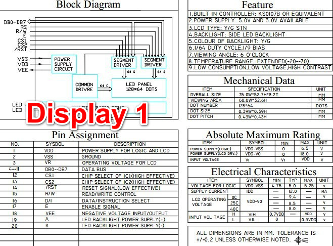

            • I would replace one of the jumpers that looks like they are touching with a wire as waltr suggested, but if everything is fine I think it might be the display, could you post a picture of the back of the display or do you know the model? It looks like a clone of KS0108 if so you would need to use VDI_S6B0108_P18F26K22.hex instead of VDI_KS0108_P18F25K22.hex or it won't work, could you give it a try?

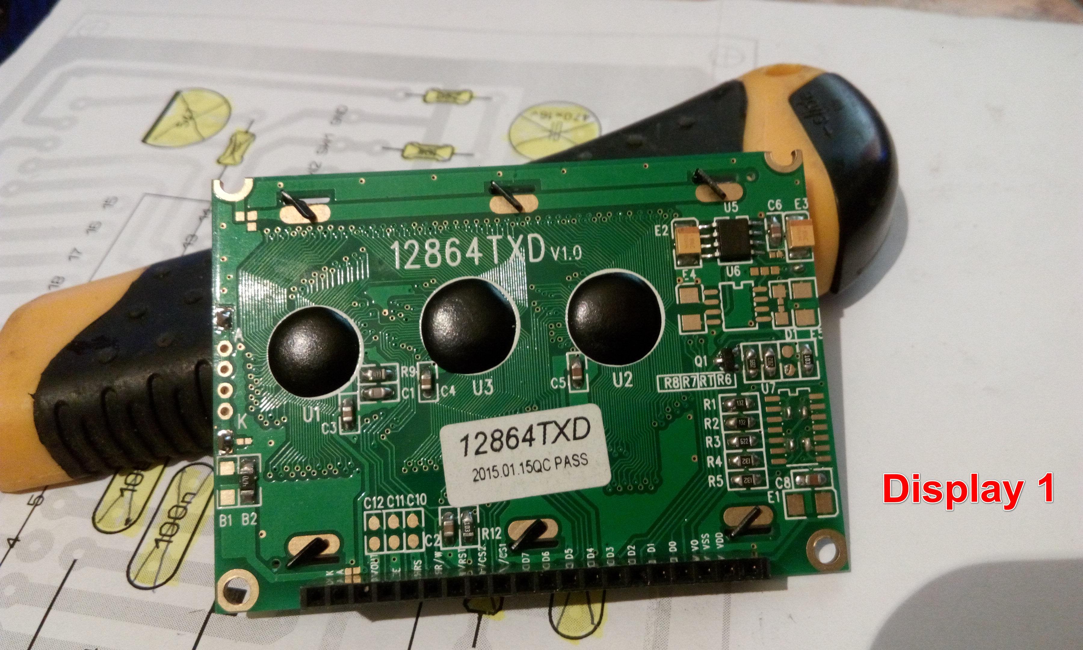

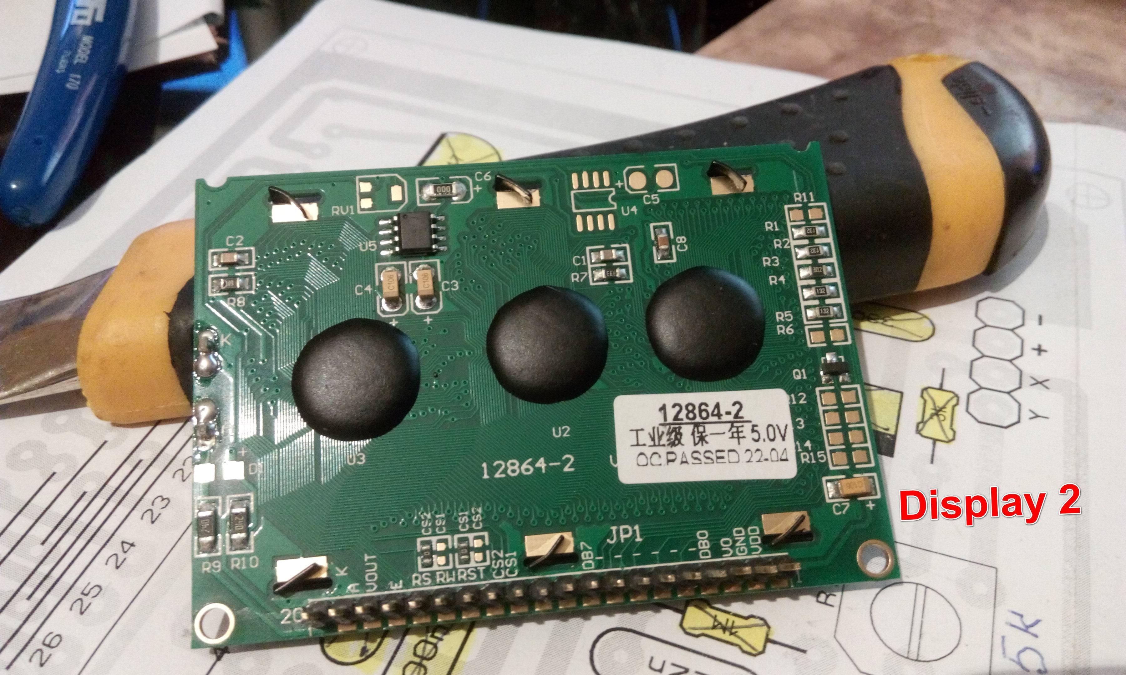

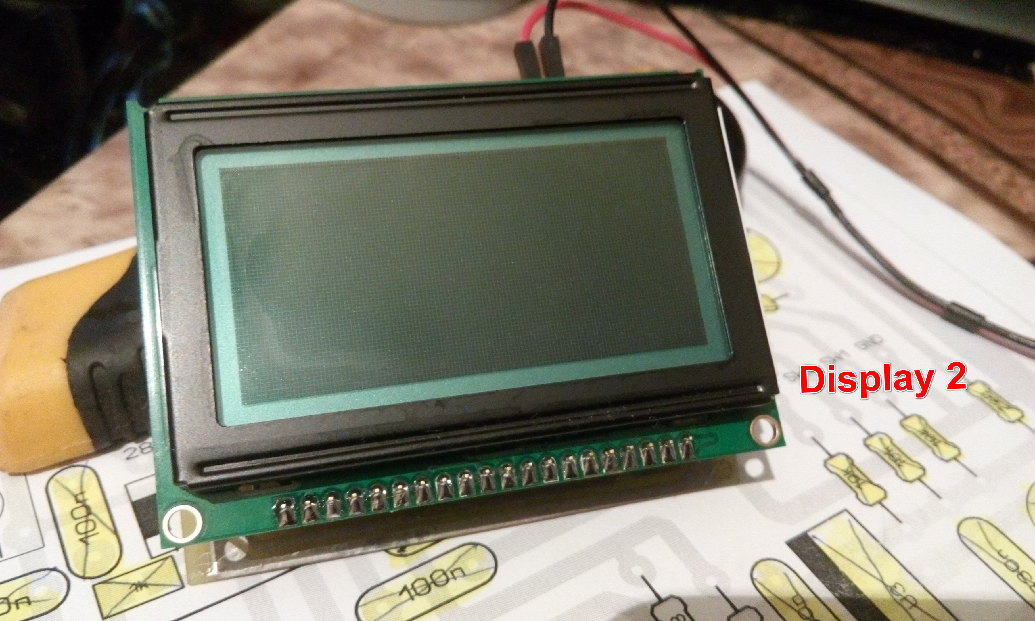

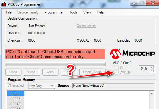

                • Hello Roderico! Everything is fine with jumpers --- checked with a tester. The PCB is also normal (I checked everything several times). To exclude the display, connected the second. He has a 100% controller KS0108. However, nothing has changed, everything is the same. Maybe it was necessary to put a tick in front of the MCLR item in PICkit3?? I bought PIC18F25K22 in a trusted store. Just in case, I connected the first display to the DM-1 ... everything works. In general, I will continue to think ...
                  The second display bought in this store
                  https://www.aliexpress.com/item/2251801546541893.html?
                  • Just in case, here is PCB
                    • did you try VDI_S6B0108_P18F25K22.hex firmware? these displays are clones the built in controller says KS0107B or equivalent, yo need to power the pcb for the pic to be detected by pickit3 as you probably you did the first time as in the images you attached the first post

                          for display 12864-2 you need VDI_S6B0108_P18F25K22.hex firmware, for display 12864TXD v1.0 try both firmwares S6B0108 and KS0108, you also need to reduce the contrast to see something in the display, in the image you posted it looks like it is at maximum and with that contrast you would not be able to see if it works or not

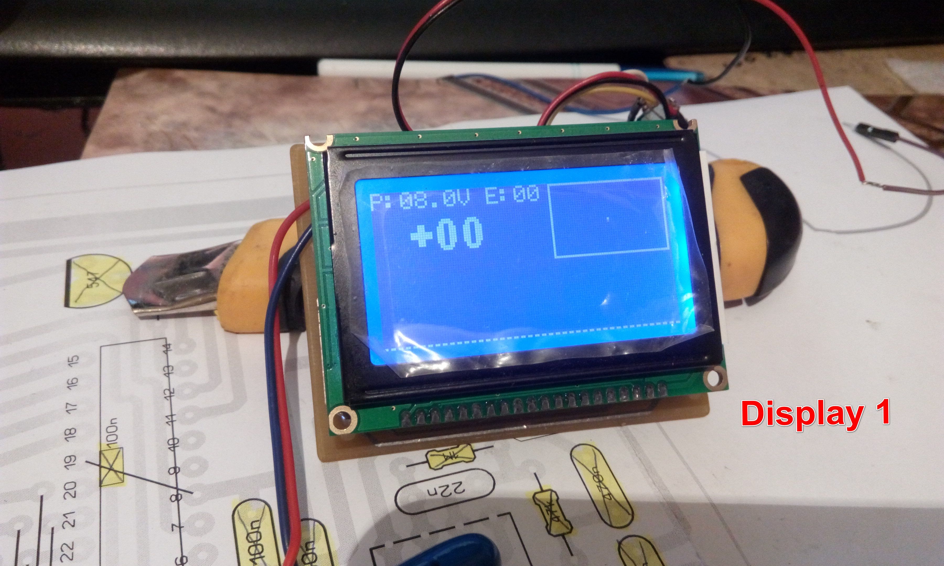

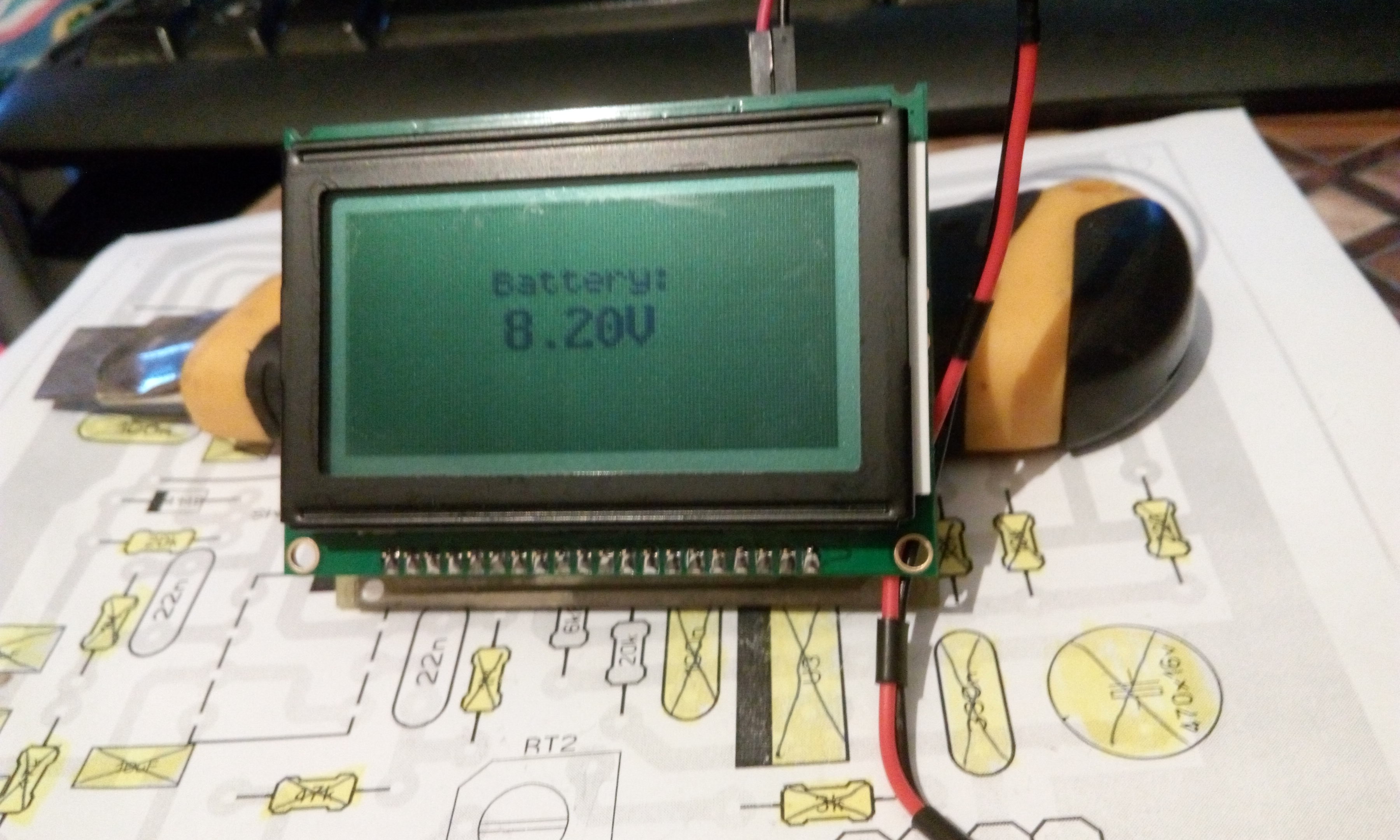

                          • Works! I flashed the firmware that you said. God... I never would have guessed in my life that this was the case... Roderico, I take off my hat and my respect! Thank you all, now I will make out in the case. P.S. Both displays work
                            • we had the same problem at the beginning with kroman1's displays the problem was that the clones use the opposite logic with CS1 and CS2 than KS0108 maybe because they are clones so that's why there are two firmwares for these displays S6B0108 and KS0108 (both identical except for CS1 and CS2), I'm very glad you made it work at the end
                              • Now I will know about it too. I will do it as an independent VDI prefix to Whites IDX and Tesoro Bandido. Thank you very much again!!!
