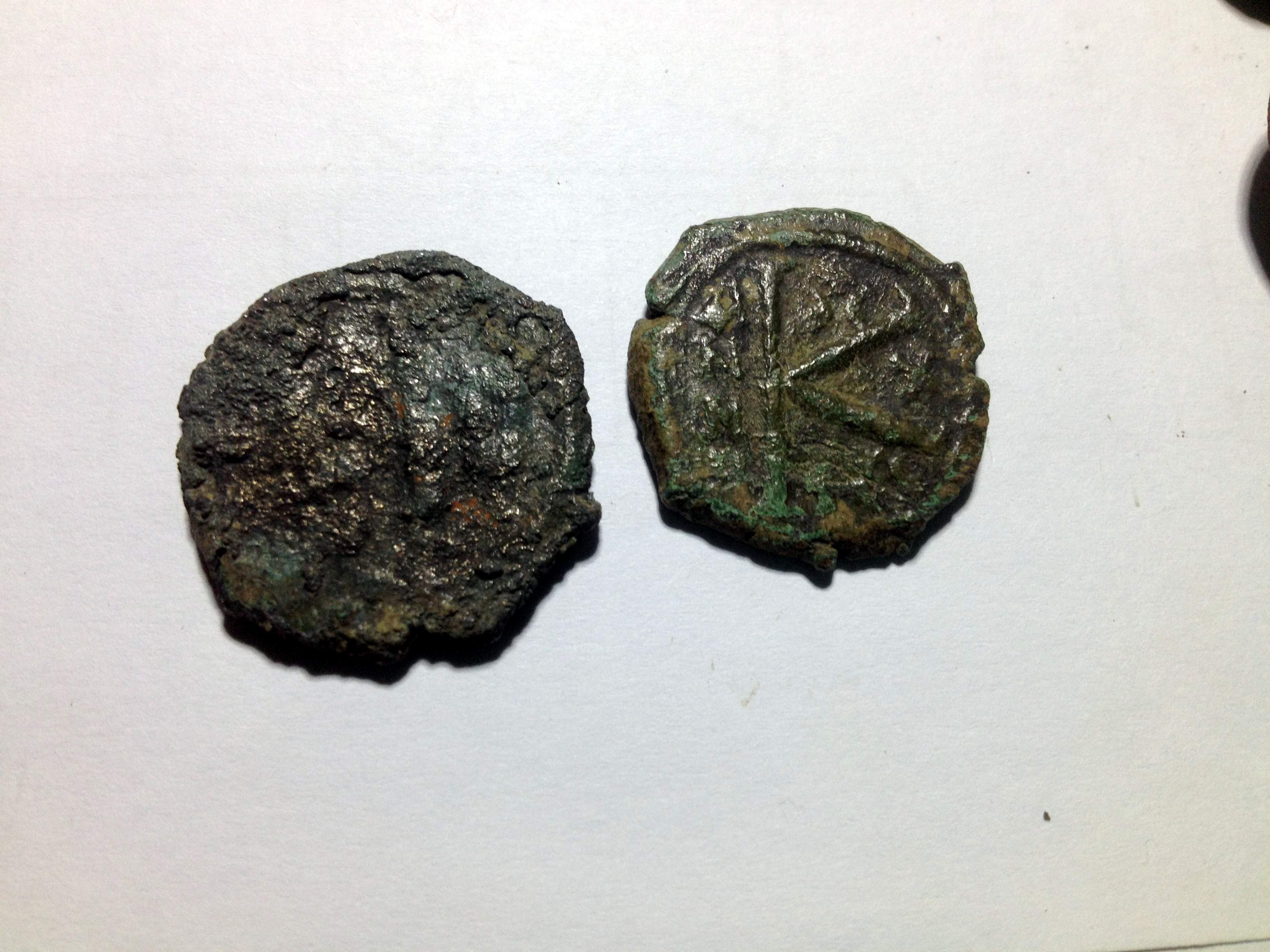

                          Quite correct.
                          Few posts earlier i mentioned the "republican" and "colonial" mints very purposely. To emphasize the huge differences between alloys and quality and diversity in such targets.
                          And that's also has a lot to do with what you can expect on the field.
                          It's quite different situation with modern coins which are made with pretty high scale of uniformity. With those you know what to expect.
                          Here is the photo that shows the diversity. Two coins, same nomination, same age, same site, same mint. Distance between them was 15 meters.
                          The one on the right side preserved better, the one on the left side is burned totally by the organic waste. Quite different two targets in the Deus's "eyes".

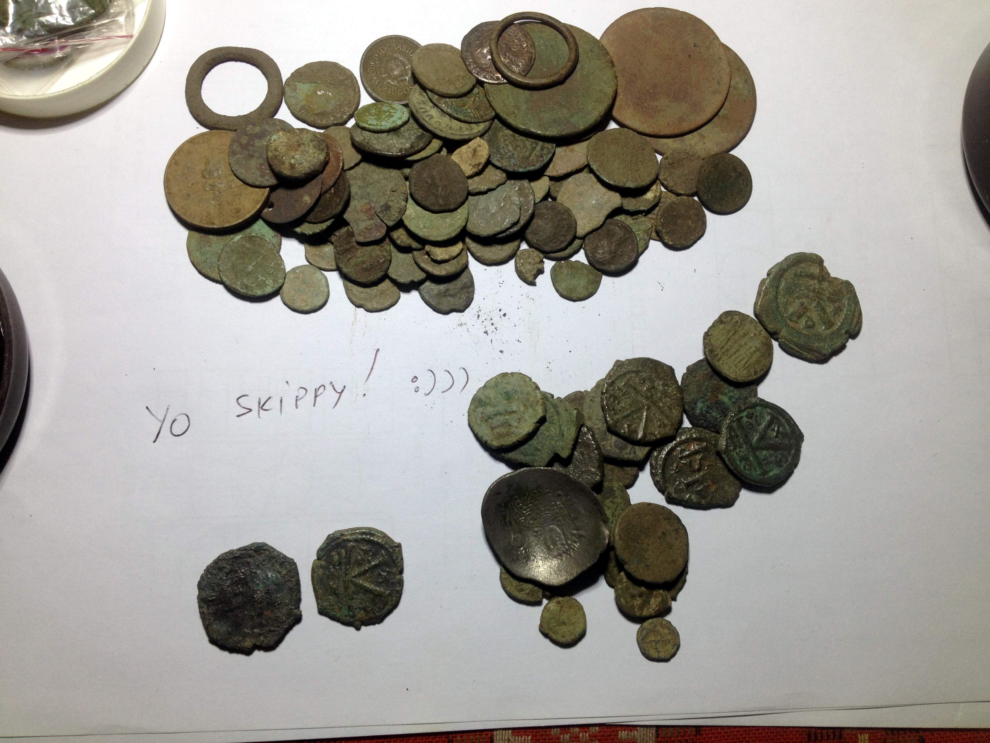

                          Another photo; most of the finds are from the very same site.
                          Almost all of those were "deeper" in soil than later in air. What was the difference? Significant and very noticeable. From 1cm up to 5-10cm.
                          It is hard to make mistake on this, it happens all the time at some sites.
                          However; it will never happen on testing bed.
