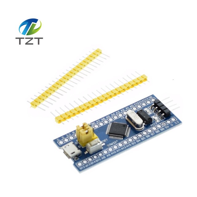

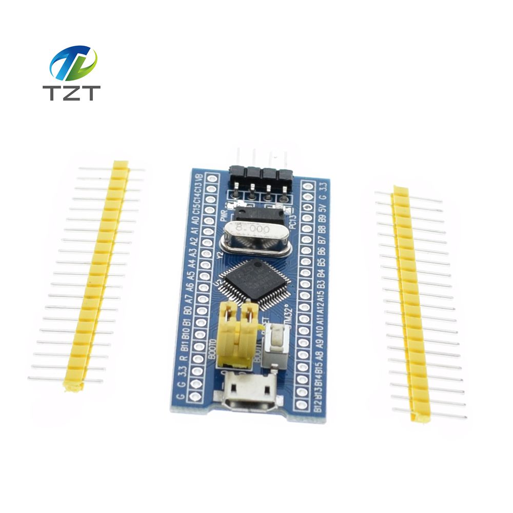

                      ST Micro makes inexpensive "Nucleo" eval boards that I believe include Arduino-compatible headers. STM processors pack a lot of bang-for-the-buck and the milliwatt.
                      $1.75 a piece with STM32F103C8T6 ARM.

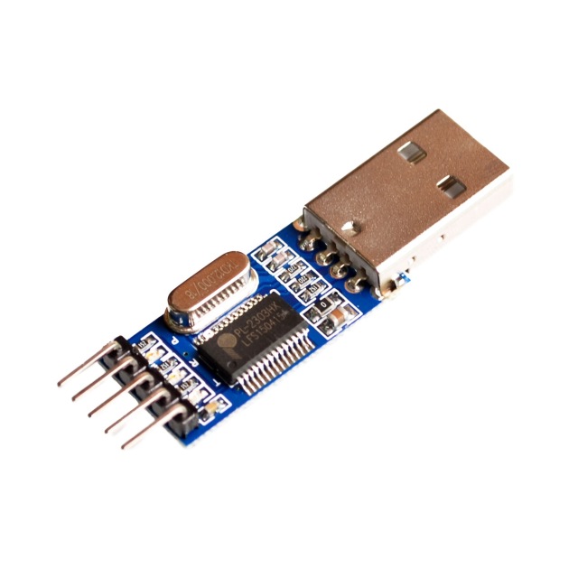

                      Still needs a $0.60 USB-to-TTL converter for serial programming.
                      For programming and all technical issues: http://www.stm32duino.com/index.php?...5d75b418507bdf
                      https://www.aliexpress.com/item/1pcs-STM32F103C8T6-ARM-STM32-Minimum-System-Development-Board-Module-For-arduino/32720697607.html?spm=2114.13010608.0.0.iF4NVw
