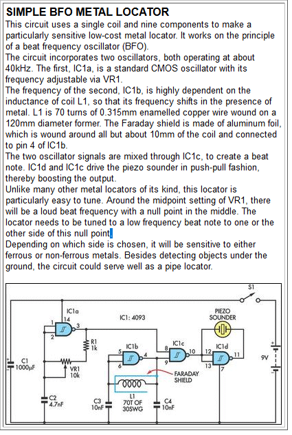

    Hello, i'm looking for an easy to build BFO circuit for a little Pinpointer.
    I have already built one with two coils. But i saw that there are easier circuits with just one rod style coil.
    9V if possible and without ICs.
    look here:
    http://www.geotech1.com/forums/showt...matics-Website
      Try this one. LOW Parts and Fine for Probe. Pretty much any Quad Nand Gate IC will work. You could even just use 4069 inverter .Click image for larger version
Name:	MD - NandBFO.PNG
        I need to check my stock, i have a lot of 741 ics and a lot of 4XXX to, but the 4069 is not 8 Pin so i think i dont have it.
        Thanks, looks very good and easy. My BFO from easytreasure was built without ICs only 2N2222A Transistors.
          4001,4011,4019,4069,4071,4081,7401,7402,7403 with the 74xx your limited to 5vdc but will do the same. The IC will run with less drift I would think. Both Osc are in same package.
            Ok thanks, i think i have the 4011.
              Figure out the Inductance of the coil they mention and just buy a off the shelf inductor to use in a pin pointer.

                      I dont mean a switch. I have one coil (search coil) which runs at 104 kHz and i need another coil for the BFO which is adjustable from about 102-106 kHz
                      to adjust the sensitivity.
                        Why do you want the coil adjustable ? No Need. The Reference Osc is adjustable.

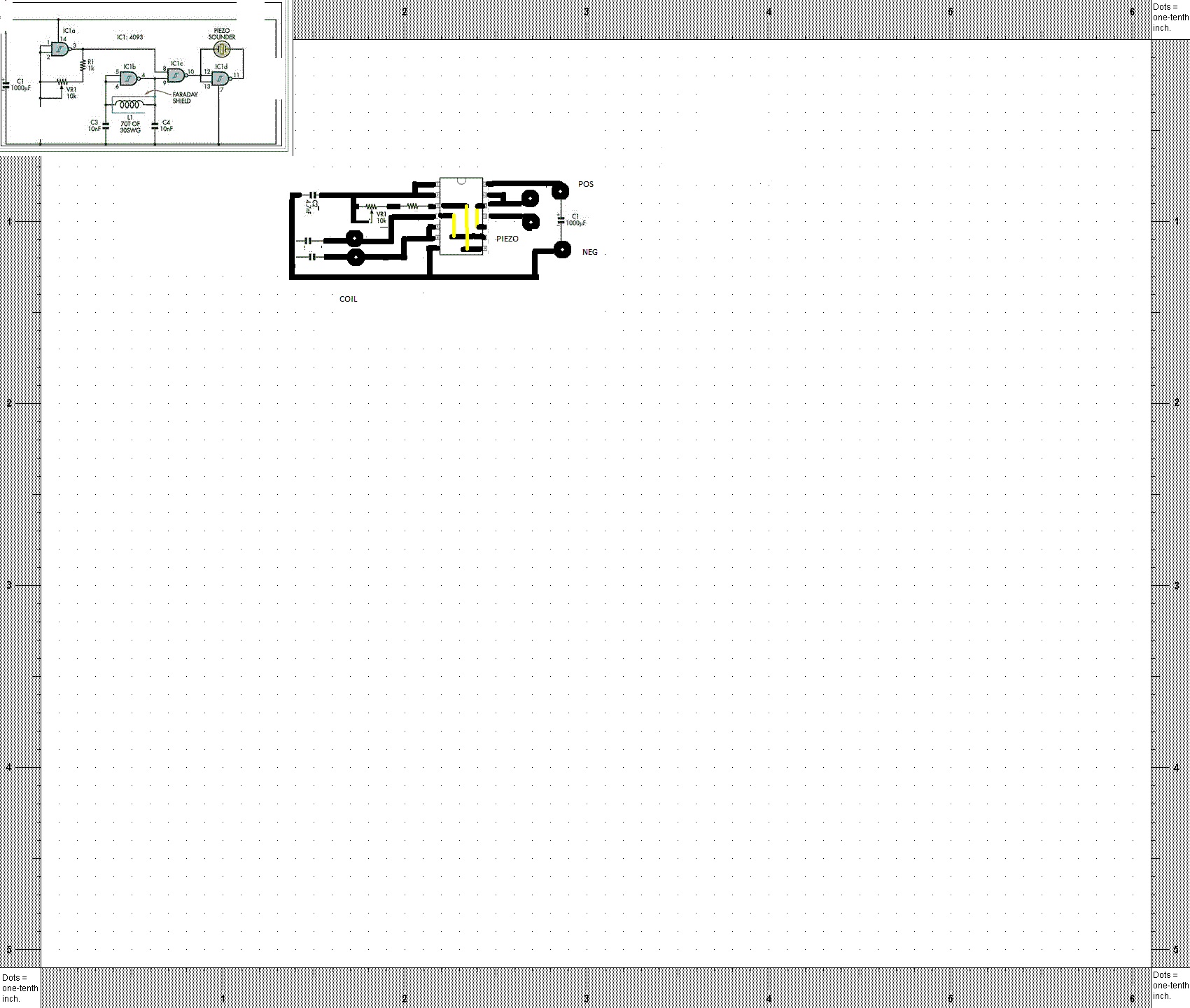

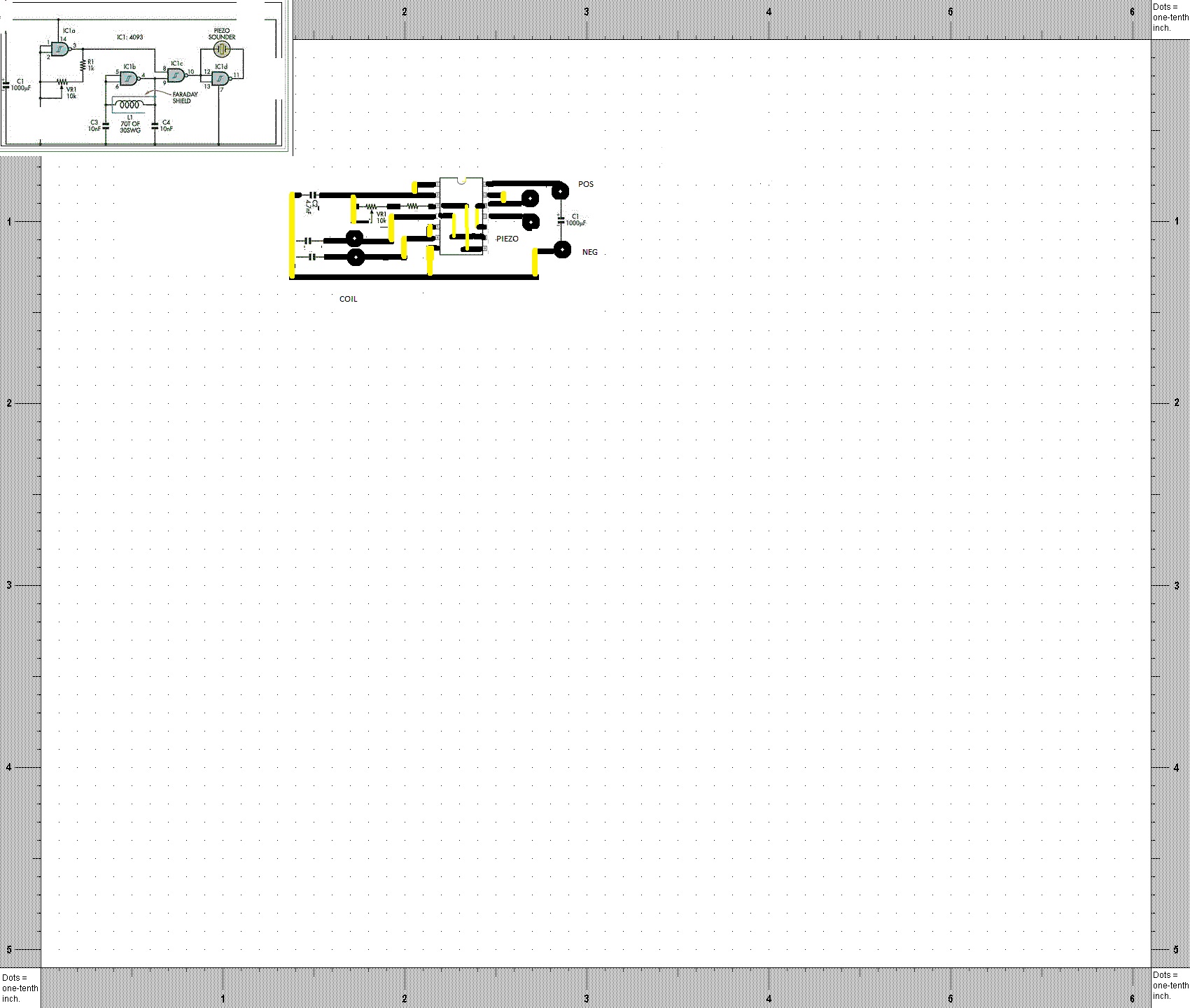

                          Going to make one to play with. Going to zip one on Strip Board.Click image for larger version
