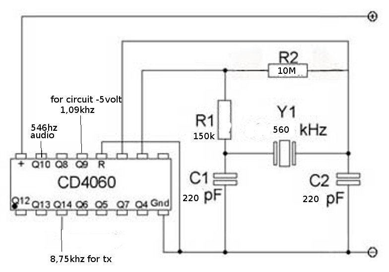

                    I'm experimenting with hef4060 and 560khz ceramic resonator to get after 8.75khz divisions followed by transistor buffer, 1khz for -5v circuit (2 transistors like tgsl), and 546hz use for audio section.
                    You would save at least 2 integrated.
                    Tried with sampler style raptor seems to be fine, tx sine 16v disc signals and geb ok to oscilloscope, i go ahead

                      That's a good use of a 4060. Another thing I've seen done is a free-running LC oscillator driving a CMOS division chain to derive audio and a charge pump negative supply.
                      For audio, use a pulse width and total period that are integer multiples of the transmit period. That way the audio spectrum has a null at the transmit frequency and won't crosstalk to the receiver.
