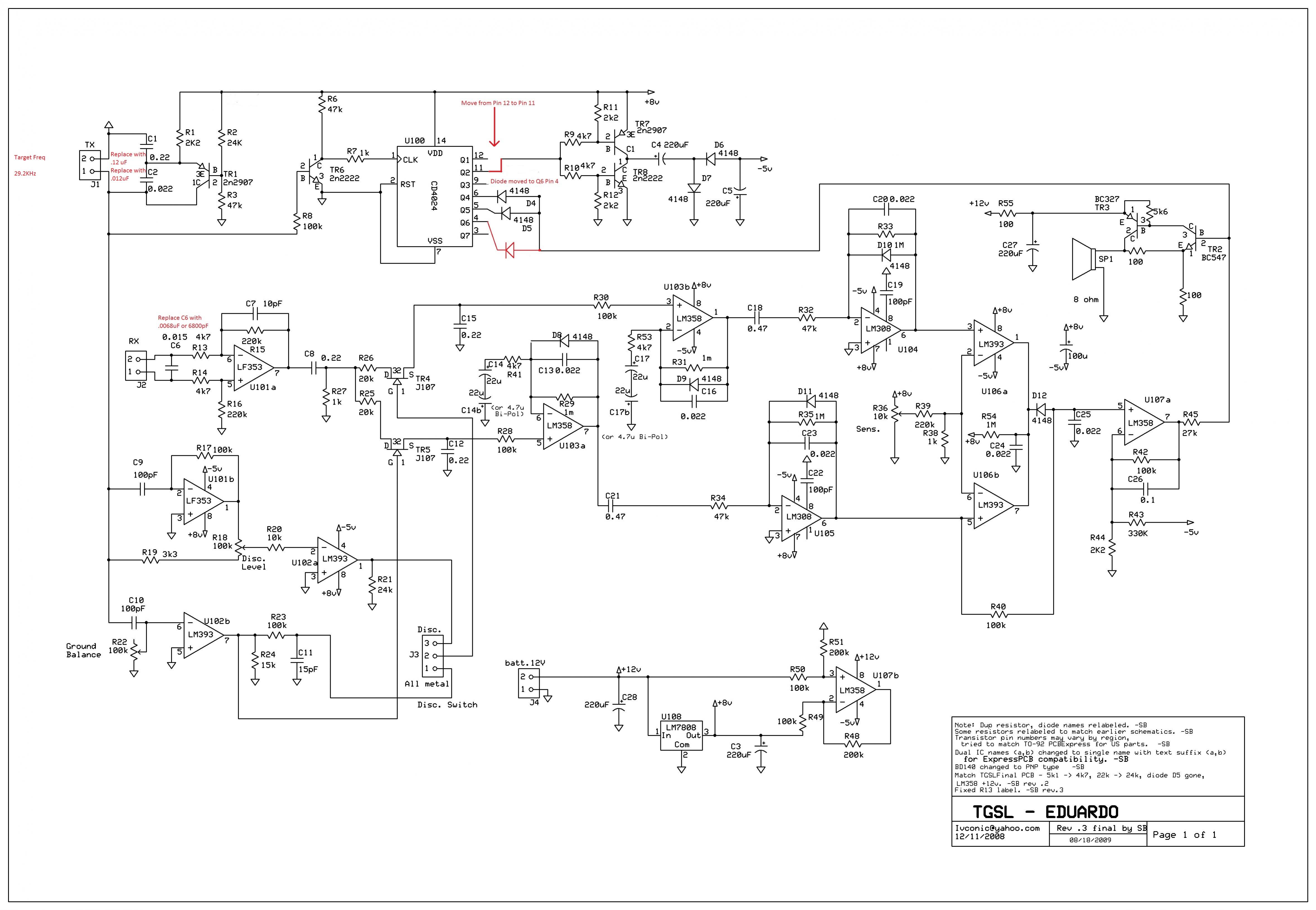

....its time to start a new homemade project. Im looking for an high frequency vlf detector( something about (40-70 kHz). Is there some shematic out there?

The TGSL would be a good candidate for the conversion. Well Documented. PCB in Place. Basic Coil Construction documented and proven. Has Grd Balance Provisions. Don't much care about the Discrim but it's there. Tune it up to 35Khz. 48Khz like the GMT and use those coils ? Go full blown 70Khz and use the Gold Bug Coil ?

Thank you very much everyone for the good and interesting replys. Im very interested in shematic of Fisher goldbug 2. @koala.....do you talk about goldbug or goldbug 2. If everyone have shematic for goldbug 2 or other high frequency gold detector.....please share it ;-) .....ive already worked on tgsl to change frequency with changeable capacitors but quit this project on my tgsl........ I want to build something New from scratch;-) Is someone interested in build an high frequency detector. I have another new tgsl board here, but i need help in tuning this board up to high frequency;-) . my Favorite project i want to build would be something like goldbug 2.

I have a GMT so I have a few coils. It would be nice to do the 70Khz. Nothing but the old Gold Bug has been published I think. If the Op Amps are fast enough and good enough S/N then all that would be needed I think is changing the Caps on the Filters. This is how far I got on the TGSL/EDU conversion to 29Khz before loosing interest.
