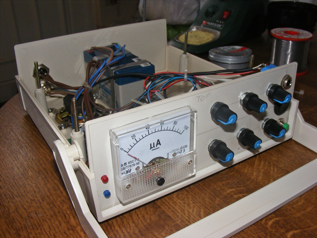

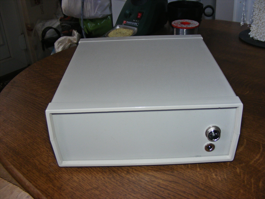

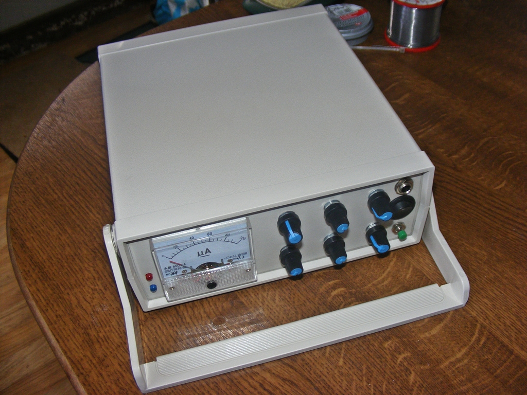

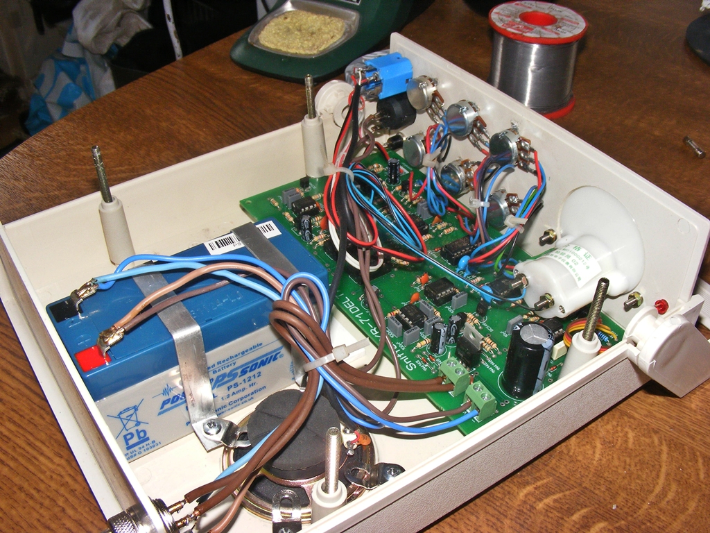

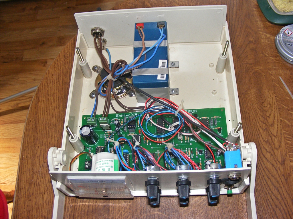

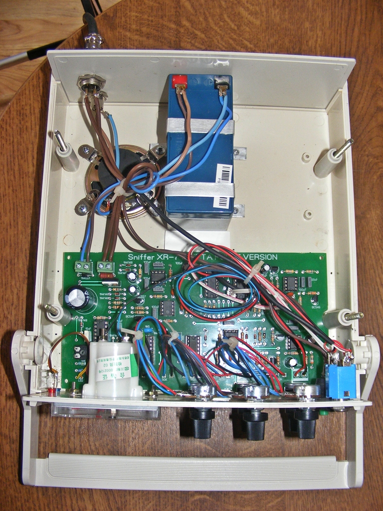

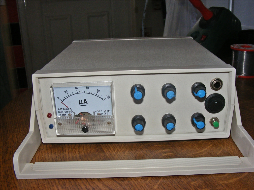

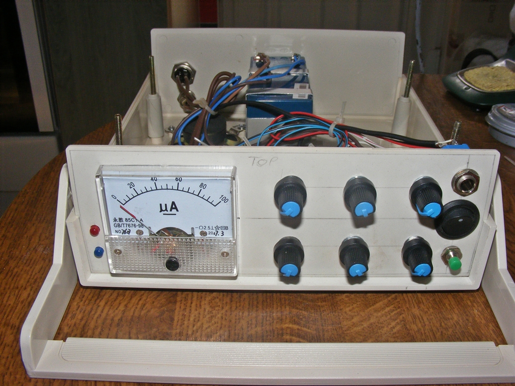

              well i have eventually getting around to getting a enclosure for the Sniffer XR-71 DELTA PULSE circuit board that i bought off feebay a few months back. i took the Potentiometers off the board and relocated them because of the problem that they would have of the treads on them not being able to reach far enough through the front panel of the enclousre to put the washer and nut on. as i mentioned at the begining of this topic.
              here is so photos of it completed. apart from i have yet to put some small holes in the plastic under the speaker.
              all i need now is a compatable coil to go with it. as i said in an earlier post. the coil i am testing it with, dosn't work very well at all with it.

                gooodd... but.... same problem - pots did not shielded. also i do not see that you shielded the box under PCB.
                  Hi kt315
                  is it possible that you could show me an example of what i am missing.
                  thanks in advance.
                    would it be ok to put some copper foil shielding tape stuck to the plastic base under the board. would that be suffisante.
                    how do you shield the Potentiometer.
                    many thanks in advance.
