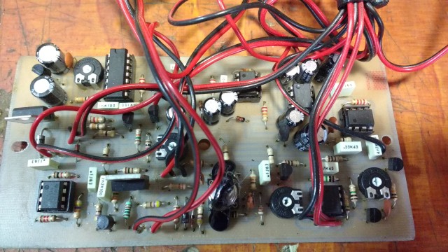

    Hello,
    Recently i get this detector pcb board does someone recognized it? Its a from a homemade PI detector.
    Im looking for info about it, componentslist, pcb layout, schamiatic.
    best regards
    Stefan

    Easy to reverse engineer. Should take you couple of hours to desolder, measure components and couple more to draw board layout.
      tgsl clone. i see 4024 there.
        TGSL is a VLF isn't it? This is a pulse induction.

          hm. give a IC's list.
            Parts are similar to pi palones. Maybe another pcb version but thesame schematic.
              Stefan as KT315 says can you list the IC's that would make it easier to identify.
                tell us what chips you see on your board Stefan.
                  cd4011be
                  ne555p
                  ua741cp
                  386n-4 (im not sure of this one)
                    i see 6 chips. how much pieces of every one?

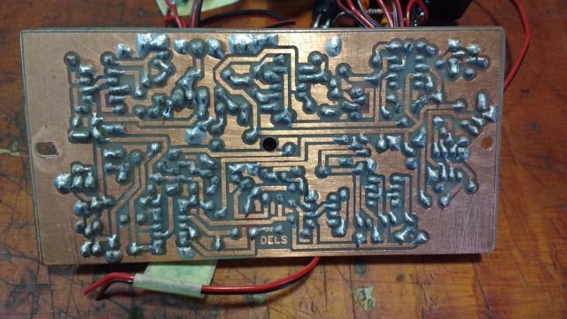

                      i can read the word sled on pcb
                      so may be the pcb was designed by user sled here in Forum, ask him
                      and if you know more i am also interested in this pcb
                        what is the 4 leg? component bottom middle that appears to be covered in hot melt ?
                            7 ICs. One metal can.

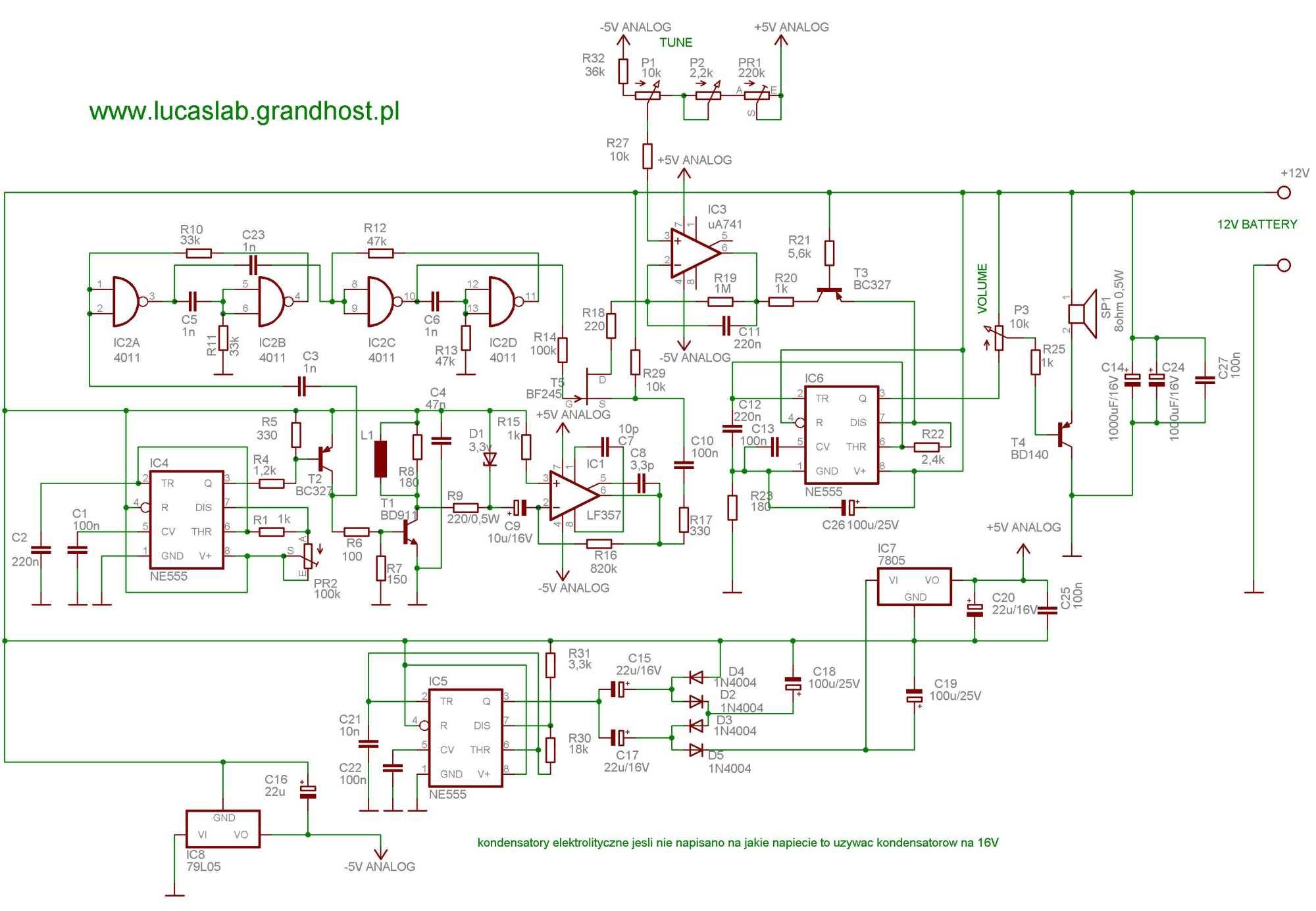

                              It's pi project. Named TL12000 or Luminous
                              IC's
                              CD 4013
                              LM 358
                              2 pcs NE555
                              lm709
                              lm398
                              xr4151 or lm331
