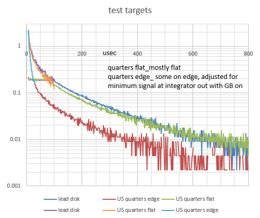

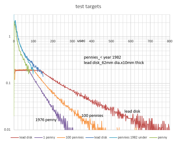

Tried making a lead disk. Mostly an exercise in pouring one, ended up being twice as thick as Skippy's suggestion. I have some 1/2 inch copper tubing used to plumb propane gas. Easy to cut to different sizes with tin snips. Might be a alternate for the pennies. I have 6 or 7 pennies 1982 or higher for every one less than 1982. Charted the disk, one penny and 100 pennies. 100 pennies and disk charted close to same first 75usec. Wondering if 300 or 400 pennies would chart closer to the disk a longer time or maybe a 5mm thick disk would chart closer to 100 pennies. The target sample is usually taken in the first 75usec, does it matter if they chart the same after? Does anything on the chart matter when comparing targets? If not what would be a good way to compare different targets?
Just reread Eric's reply #70. [25 - 50usec delay would be OK] so maybe what happens after 75usec does matter. Does GEB effect detection distance more when sampling at say 10usec vs 50usec?
Another reason a solid lead disk would make comparison testing possible.
A test comparing US quarters mostly flat and some on edge. Plastic sour cream container about 80mm diameter at bottom. 81 quarters>1964. Don't have silver quarters but should be similar result except for time constant. Coins swinging from a pendulum, mostly flat GB off(21inches)GB on(23inches). Some on edge GB off(21inches)GB on(18inches). GB off no difference, GB on lost 5inches detection with some coins on edge. The lead disk charted close to quarters flat.
Think would loose more distance if coins on edge didn't start detecting when crossing coil edge?
