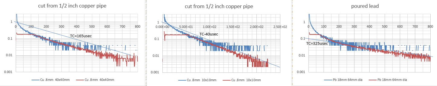

                          More tests. Copper squares cut from 1/2 inch tubing, about .8mm thick. Was going to test 10, 20 and 40mm squares. TC should be linear with length 10mm(40usec) 40mm(165uec), didn't test 20mm yet. Thinking about 5, 10 and 20mm thick poured lead targets. The form I wrapped the foil around was 64mm instead of 60mm as suggested. Needed a little more lead to get 20mm thick. A 1oz copper coin has a TC close to 500usec, maybe need a 40mm thick lead disk for large copper or silver coins. I still think the poured lead would make a more repeatable target than a number of coins. How the coins are stacked can effect detection distance. Just something to think about.

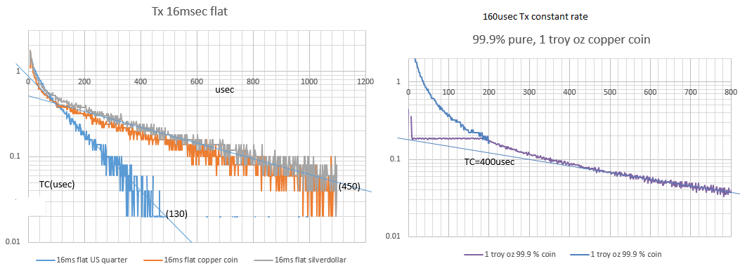

                            I noticed you stating that a 1 ounce copper coin has a TC of 500 usecs (fcorner = 318 Hz ). This is quite a bit different to what I would expect. Unfortunately, I don't have a good non-dugup example of our British 1 oz copper coin, only many corroded ones. But I do have a US Peace dollar. This is just under 1 oz, and 0.900 silver, so not exactly the same, but... I measured it having Fc = 1080 Hz (TC = 147 usec) [measured at 13kHz] and the 'George Payne' quoted fc = 800Hz ( TC = 200 usec) [measured at 6.6kHz]. So I'm surprised you're seeing 500 usec for a 1 oz coin. Do you have a US silver Dollar (Morgan/Peace) in your collection? It would be good to see how it measures up on your rig.
                            I'm going to rummage and see what copper pipes I can find, just to see how they compare to your sample.
                              Couple tests. The 16msec Tx constant current I did awhile back with a 1troy oz 99.9%pure copper coin and a silver dollar I borrowed. Remembered 500usec TC, after expanding chart looks closer to 450usec. Just did the 160usec Tx constant rate, 400usec TC.
