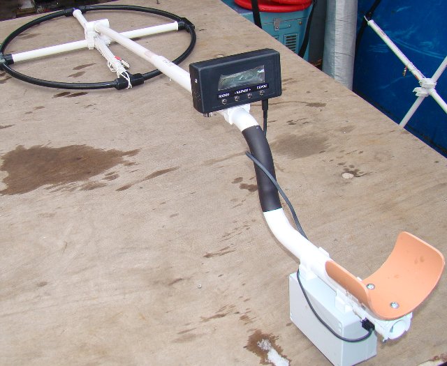

              Sensitivity 18-20cm at the coin 25mm diameter and up to 100-150cm for large metal objects
              the coil 27 turns in a solid copper wire enamel insulation diameter of 0.5-0.8 mm (.6mm is best)
              coil diameter 18-25cm.

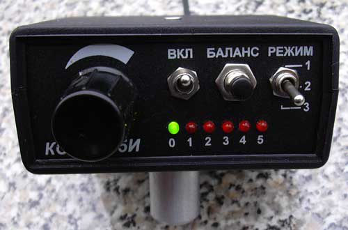

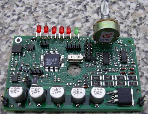

                Koschej-5I

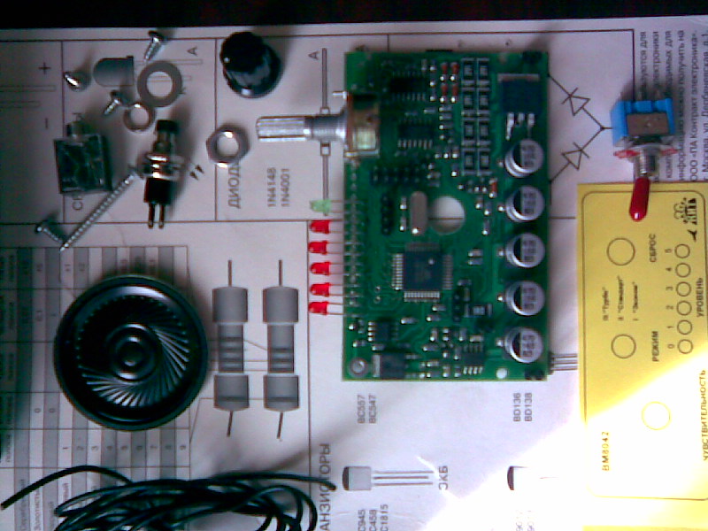

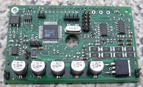

                  Koschej-5IM

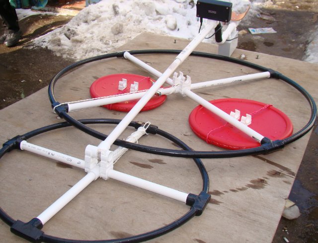

                    guys, I give again a direct link on HOW TO MAKE DEEPER COIL FOR THE TRACKER
                    http://www.metdet.ru/GL12x12.htm
                    follow the text and pics.
