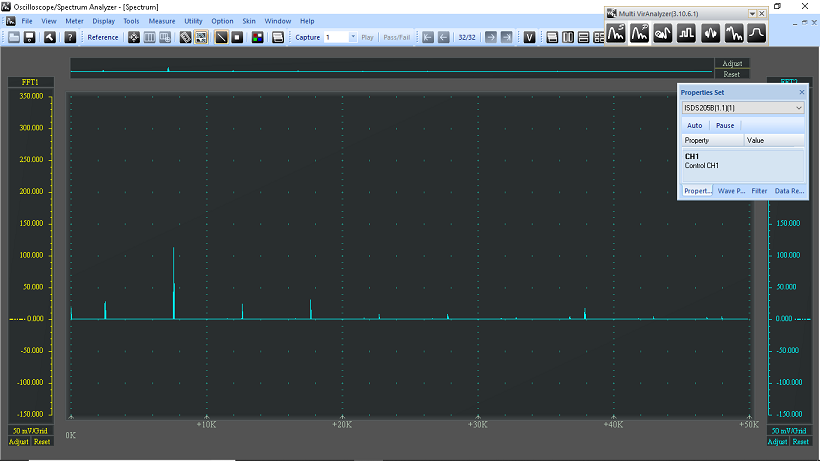

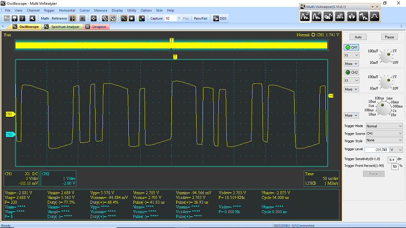

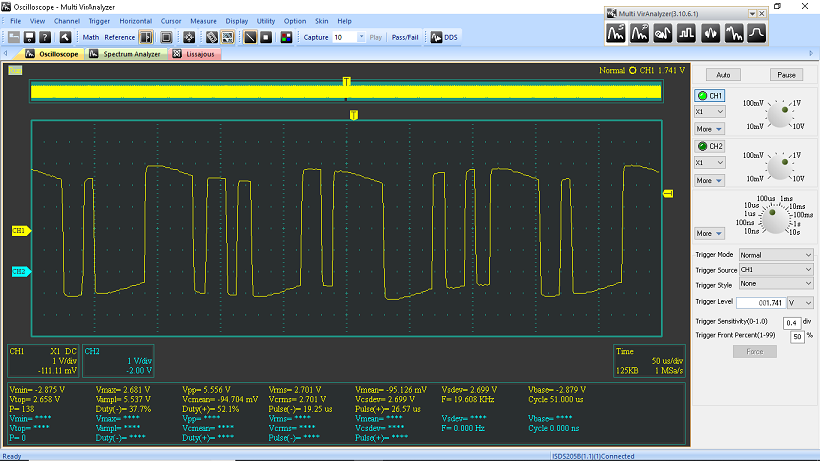

  • here are the b1 b2 programs

    • Looks like a PWM to me
      • I was having another look at your original small versions of the 'beach' waveform yesterday. It's harder to pick out by eye the different freq. components. The whole cycle repeats in 385 microsecs as before, and there's clearly 3 cycles of 7.8kHz in there. But I was tricked by the fact there are 9 cycles in total in the 385usec, making it look like there should be (3x7.kHz present too.
        Thankfully the spectrum analysis shows 7.8k, 13k, 18.2k and 39k, ratios of 3 : 5 : 7 : 15 ( with some 2.6k sneaking through)
        I'm not sure why the 2.6k shows up, but it's unlikely ML make any use of it.
        Regarding the PWM idea: I did wonder if the 'field' multi waveform could be generated by simply modulating a 39kHz square-wave with (7.8k + 18.2k) sine waves. It may produce more unwanted/unused frequency components, the sum and difference signals that mixing creates.
        If this 'beach' waveform is made by modulating 39kHz, then it's going into 100% modulation, as 6 out of 15 cycles are missing.
        I wonder how low (and high) the detectors frequency is capable of good performance? They offer 5kHz as a single frequency ... whether it's on-the-limit, or even beyond-the-limit depends on things like coil nulling. If they could run it down to 4kHz, then there's the possibility of running at half the 'field' frequencies, ie. 3.9k / 9.1k / 19.5k (keeping the same ratio's), which might suit the U.S 'deep silver' niche hunters, though may be good on wet salt beaches, too.

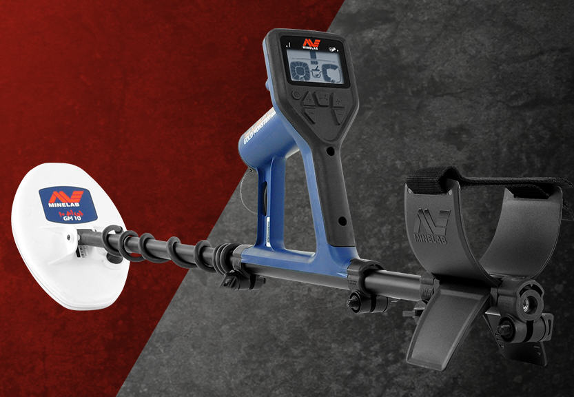

                            • ML is going wild:
